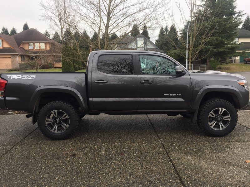

    Front Suspension King Ext Fronts 700# Icon UCA delta joints JD fab spindle gussets All Pro cam tabs DuroBumps Warfab steering sleeves Rear Suspension Old Man Emu leafs -Radflo Ext travel rears Timbrens ubolt flip kit SCS stealth 6 Wheels 35x11.5 Maxxis Razr [ 34.5 x 9.75 on 8.5 rim not on truck] Heavy Stuff Relentless front bumper Smitty 3rd Gen winch Big County Customs skid plates Arc One industries rear HC bumper RCI sliders Misc Arb dual compressor Arb rear locker Pelfreybilt fuse panel tray Cali raised ditch light mounts Cali raised bed stiffeners 5th Gen 4runner LED fog lights Racks Retraxone XR tonneau Yakima load bars Sherpa Roof Rack Camping Smittybilt Tent Dometic CFX50 fridge
    5100's 1.65 setting front (real change was slightly under 2 inches)
    1 inch block - didnt change anything feeling wise, also barely changed drive line angles. Talk with some guys with taller rear lifts and at certain RPMs vibrations occur.
    Take the tape measure to my truck and there is 1/4 inch rake on it. (Front lower)
    I've seen a few people go with bigger lifts in rear with 5100's and have them leak out, most probably from over extension. Just my opinion.
    Tires if you only want height 255/85/16 -- or 255/80/17.
    If you want width Cab mount chop and trimming requires. Not that either is 'hard to do' but some people don't like hacking up a brand new truck.
