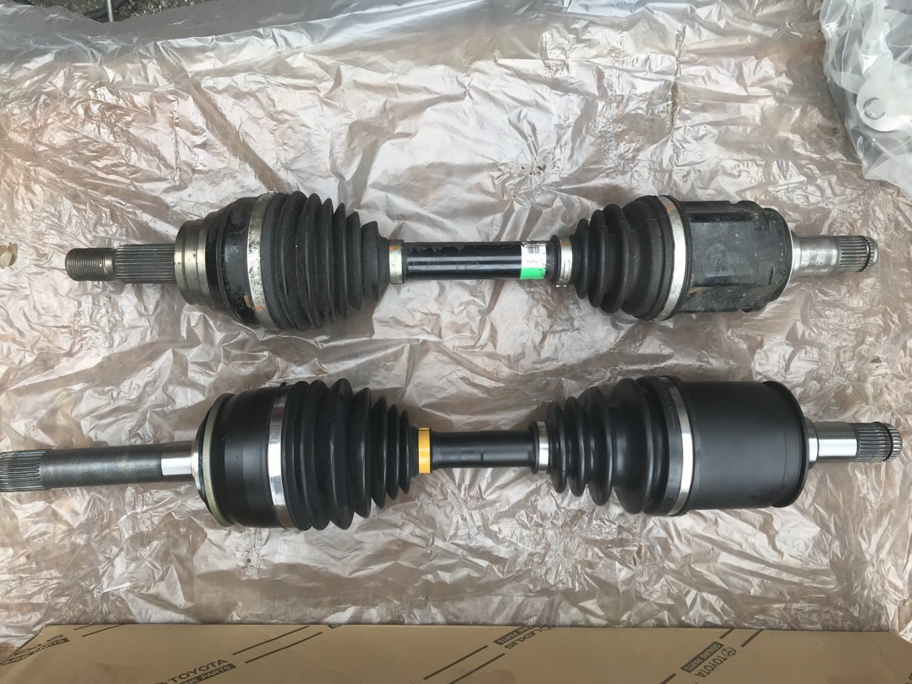

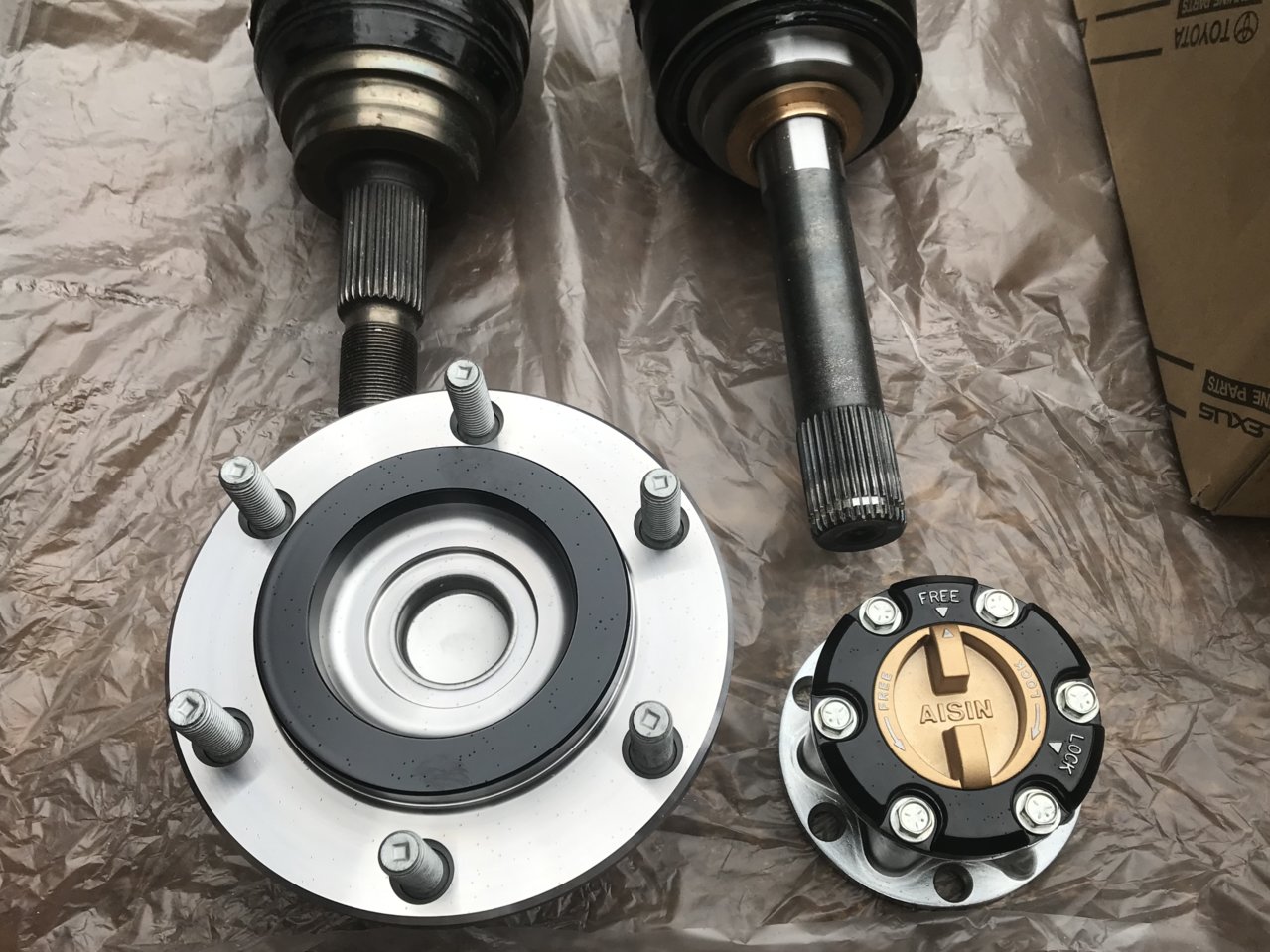

    Off to the machine shop.

    I did the 2" lift without the needle bearing change, no issues.

    Nice Aisin! Do you have part numbers for the CV shafts?

    Using Land Cruiser UZJ100 front CV Axles. Complete axle # 43430-60040. Some machining and small parts will be required for Tacoma use.

    So, on that hub you are going to have a hole put through the center for the axel shaft to come through and 6 (M8x1.25?) threaded holes for the locking hub to attach to. Are you sleeving the center hole with any bushing? Or is the support inward adequate? Mind you I have not had any of these parts disassembled to know at all what I'm inquiring about.

    Yes, you have the gist of it. Take a look at the manual hubs for the gen 1 trucks. The hubs will have bearings installed for the shafts to rotate. It’s mostly factory engineered stuff being applied here. Just larger parts from a heavier vehicle.
