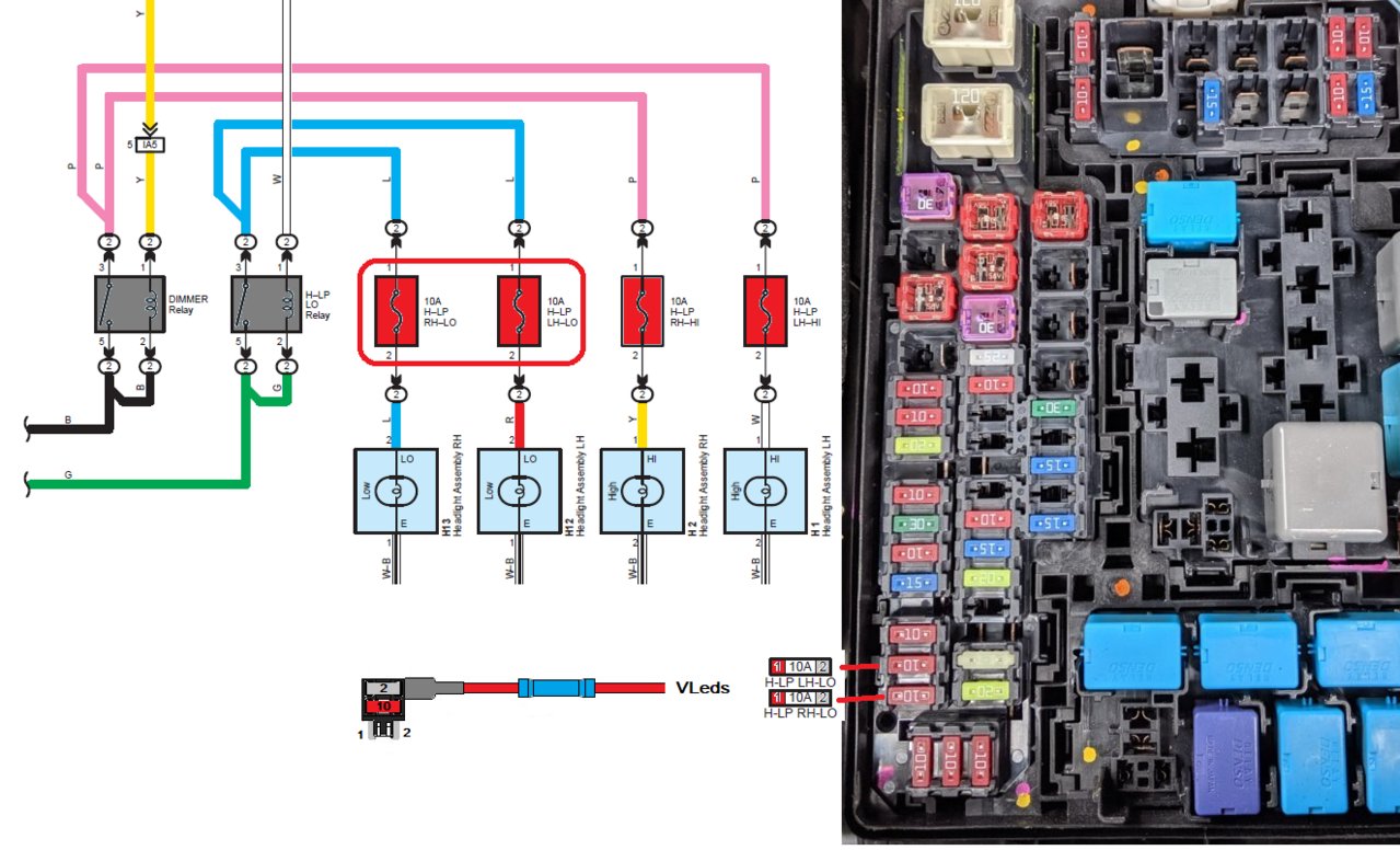

    Hello TW, I was wondering if anyone knows what color the positive wire for the low beams are?
    I recently bought VLED triton v6 switchbacks for my front turn signals and it requires me to tap into the low beam positive wire to dim. I searched many of the threads but couldn’t find anything. Any help would be appreciated!

    The wire with a line should be negative.
