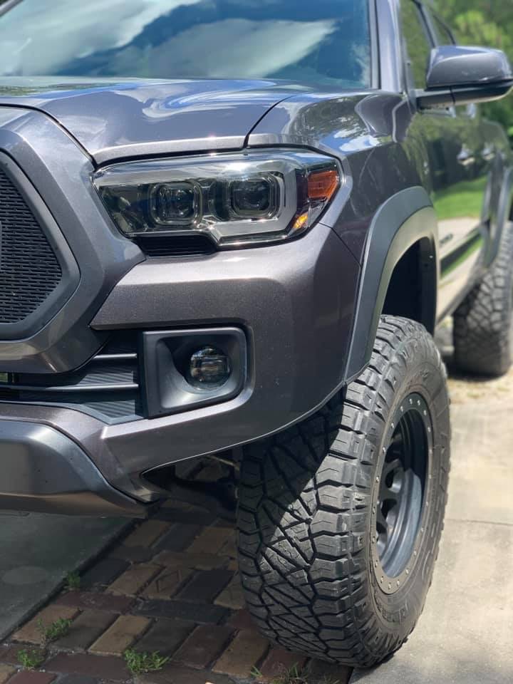

    If someone does this can we get a overall side view of the whole truck ?

    Fox 2.5 RR C/O Fox 2.0 RR Rear Dakar leaf Pack Headstong Brakeline Extension Bracket 16"Konig Countersteer wheels BFG's KO2 285/75r16 All-Pro UCA 1.25" All-Pro APEX Slidders Unided CB w/ Firestick II Lamin-X fog Lens 1" Diff Drop OME 1/2" CB Drip OME Mobtown 3/16" Skid plates: Front, Trans and Transfer case Relentless Hood Brackets AuxBeam Ditch Lights DBCustons Grill "Recolored" Matt Black Relentless High Lift Mount Softopper Diff Breather Mod Tail Gate Inserts HondoGarage Tablet Vent Mount Weather Tech Floor Liner
    I have quite a bit of damage to one side perfect for this mod but I've always been curious would this expose to much of the back side of the fog lights and allow water to enter the fender easier? Is there a local support to keep the cut component from flapping?

    I have thought of that as well. Don’t cut the inner liner instead use a heat gun to bend up then cut any excess.

    Will this allow a lot of water to go up behind the fogs? That would be my only concern. I'm at work so I can't go out and look but it would seem to me that this opens up the bumper where stock it's pretty much "sealed"

    The bumper does not seal anything at all. The fogs themselves are sealed and the connectors are water resistant.

    This. The fog lights are already partially exposed, and if you spend anytime wheeling or in mud you'll notice stuff gets pretty dirty behind the stock bumper.

    Someone posted another picture angle of the cut. Will post more as I see them.

    I wasn't worried to much about the fogs vs have a giant hole between the liner and fender for direct water into the intake on the passenger side. I guess someone mention you heat and bend the remaining liner could zip tie closed.

    what happens to the inner fender liner though? cut it with the bumper and?.. leave the hole?

    Would recommend a utility knife for the cleanest cut. Have to make a few passes but you won’t melt it like a rotary tool will.
    The extra portion of fender liner can be tucked up and fastened where able. Or can buy some thin abs sheet to close the gap if desired.
