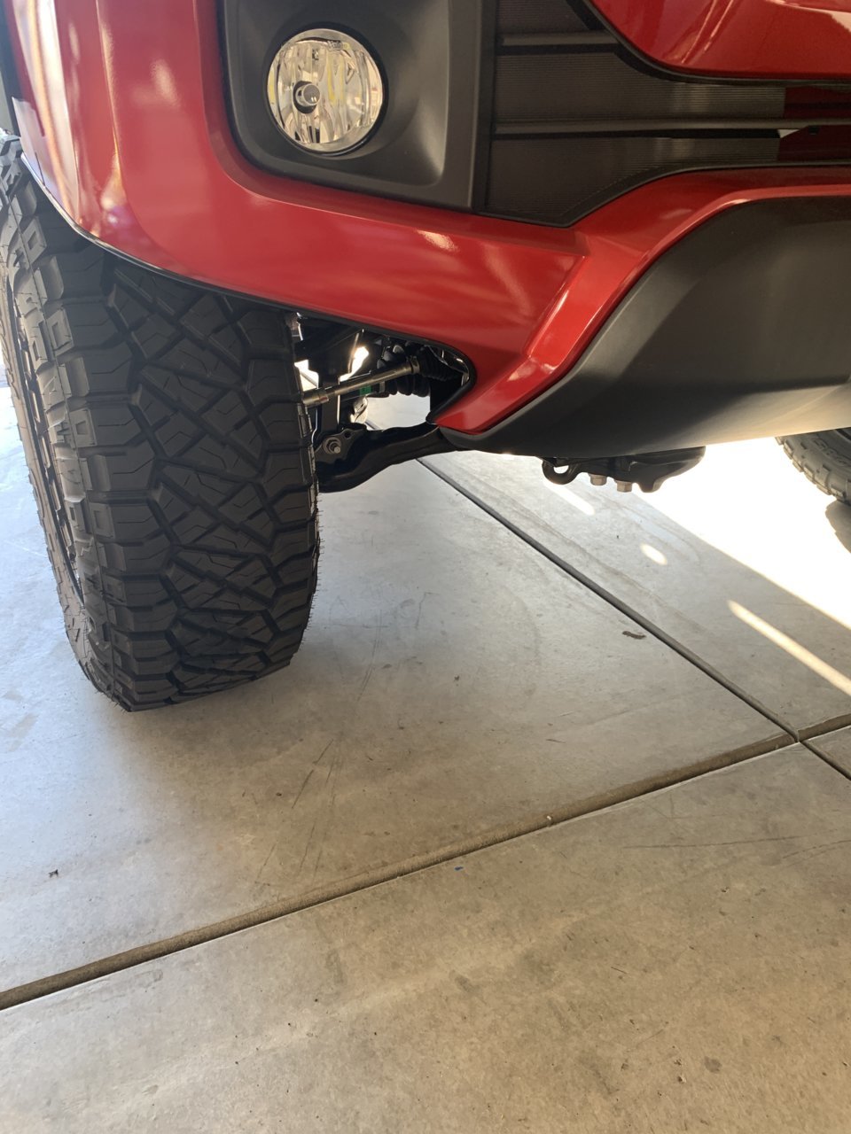

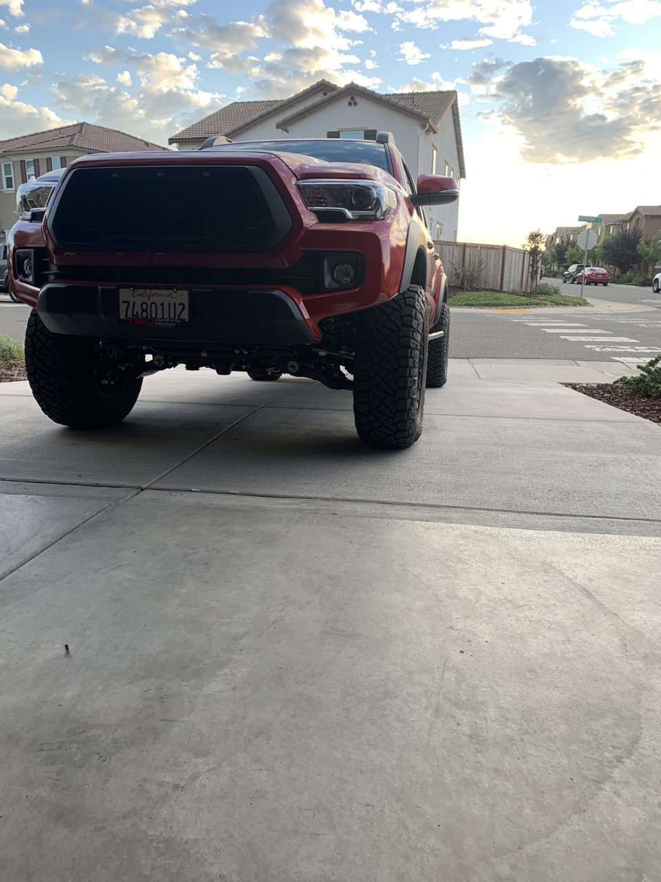

    Well got mine cut today. Was hard thinking new truck and cutting it lol

    Can you take some photos further away?

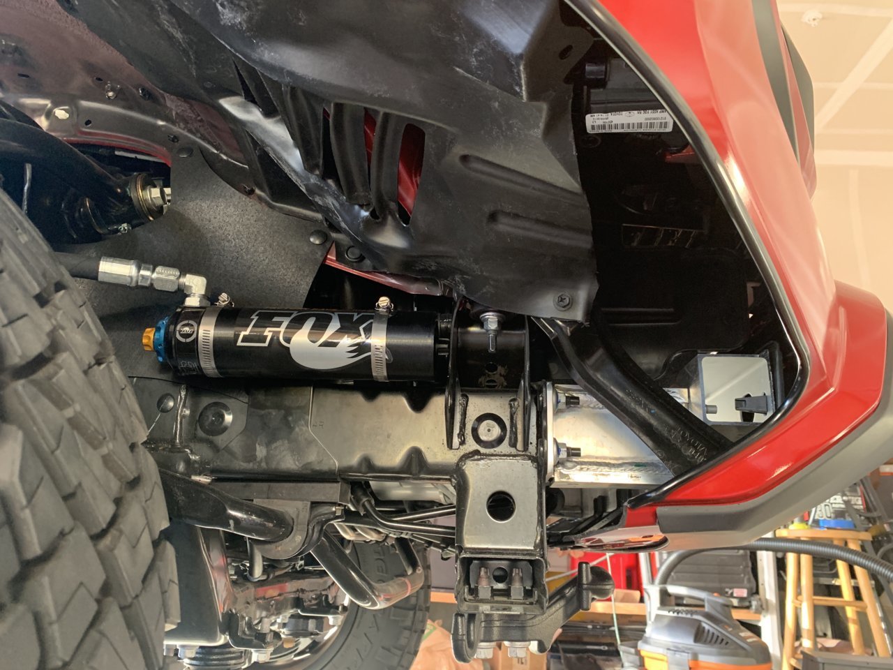

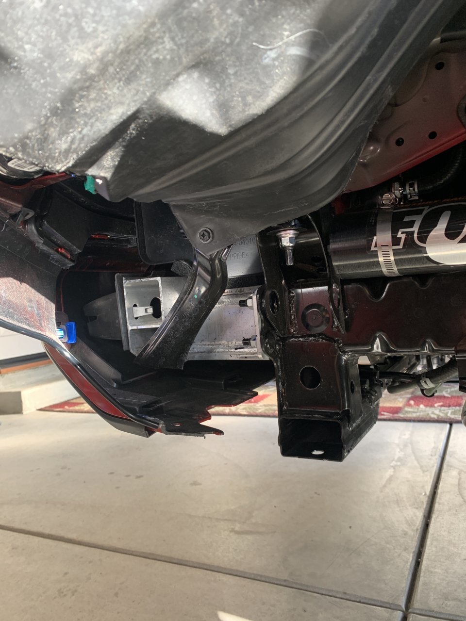

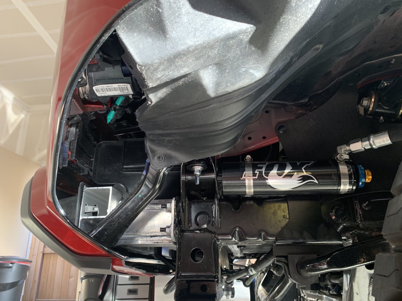

    What did you do with the excess fender lining? Can you get some pics of it?
    That’s where I’m stuck.. I’m not sure what to do with it lol.

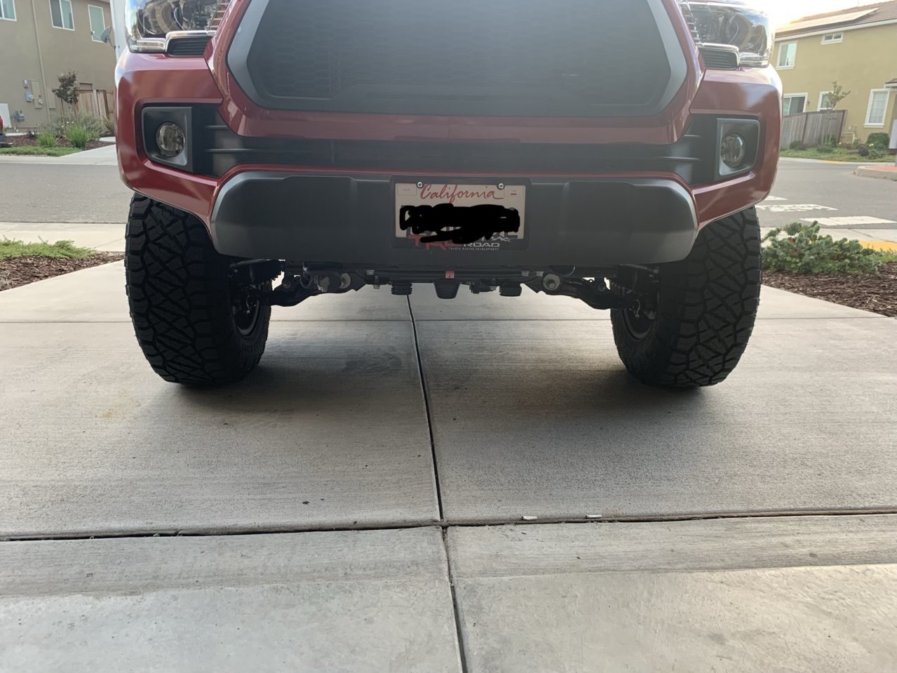

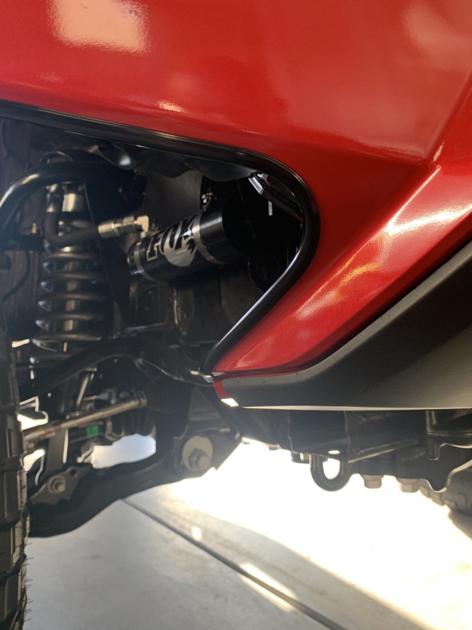

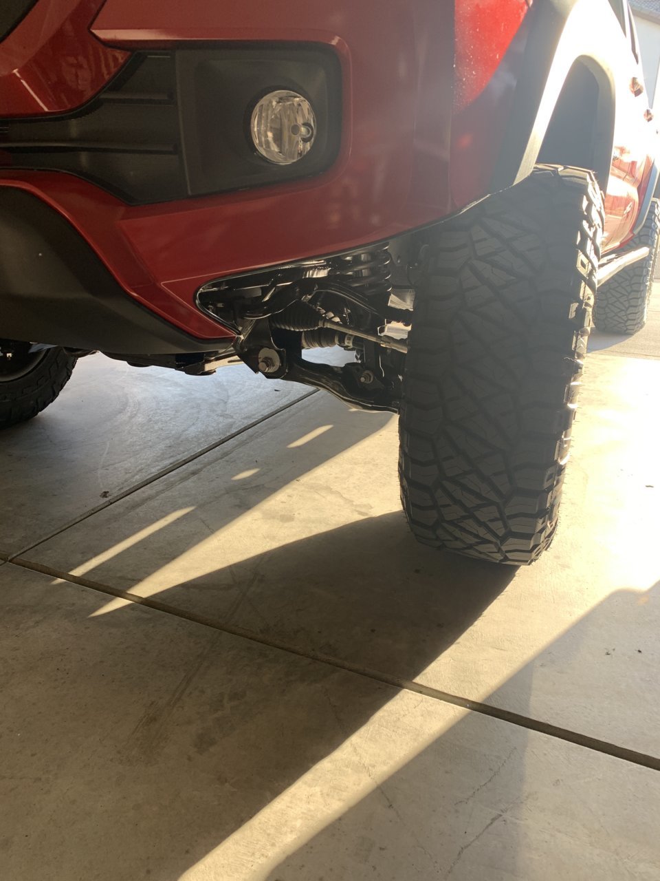

    Don’t know what happened to pics. Here they all are

    I used a heat gun and hand bent them. I also ordered so thermoplastic sheets from Amazon and I will custom make some to rest up against the frame better and under fog light.

    The lower bumper brackets I bent up and used that as a mounting point

    I will when I get done in the garage with it. Had the exhaust re route done yesterday and I installed the RCI rock sliders. Just getting things ready for the CBI overland skid plates.

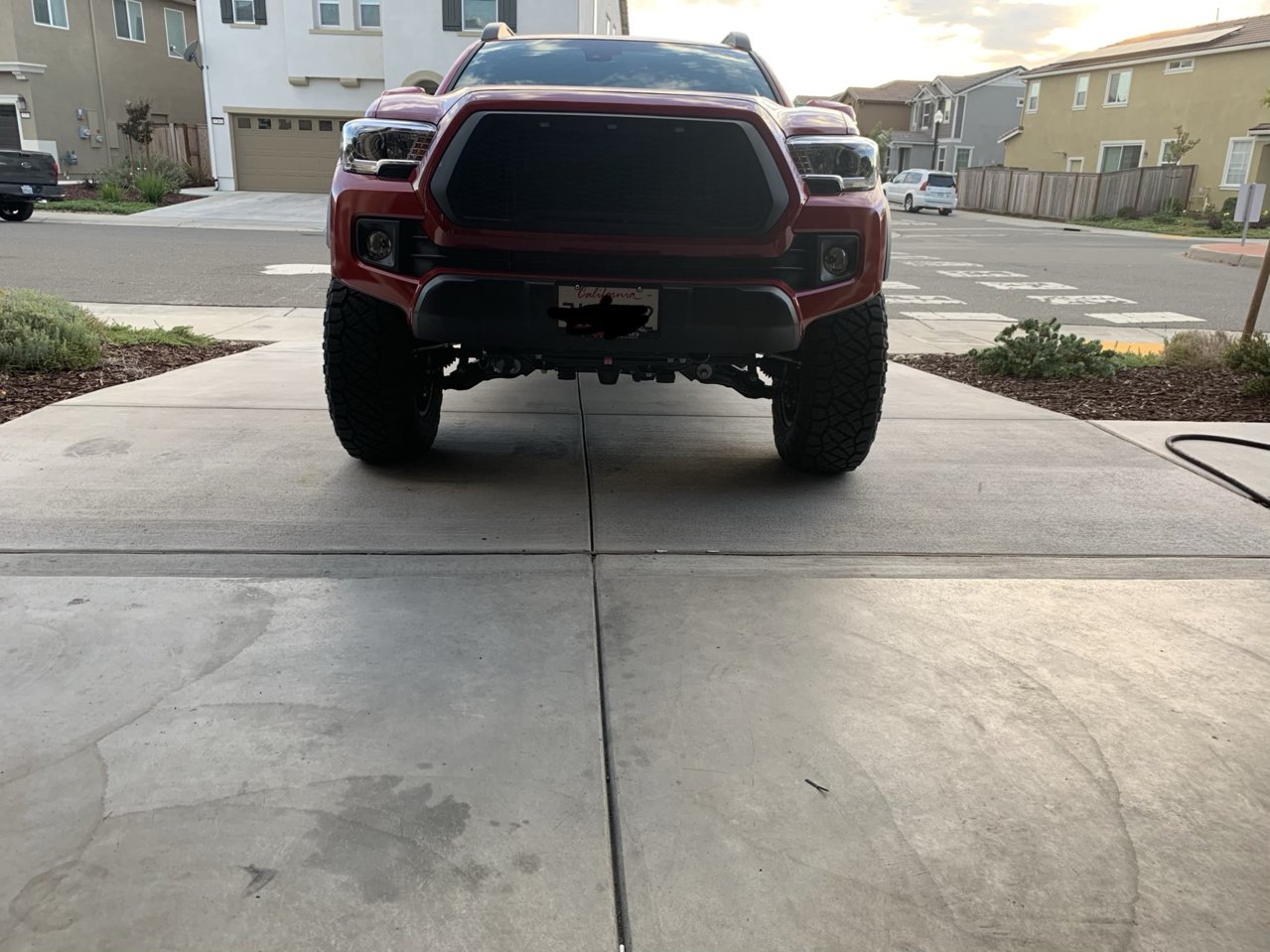

    I also did my corner cuts rounded to match the other round edges of the bumper.

    What did you end up using to cut?

    I just used a dremel with a cut off wheel. I felt I had more control with that. Then switched to a round stone bit for the corners. Finished with block sanding on a small piece of wood and 400 grit to smooth the edges

    Just finished up with one more thing

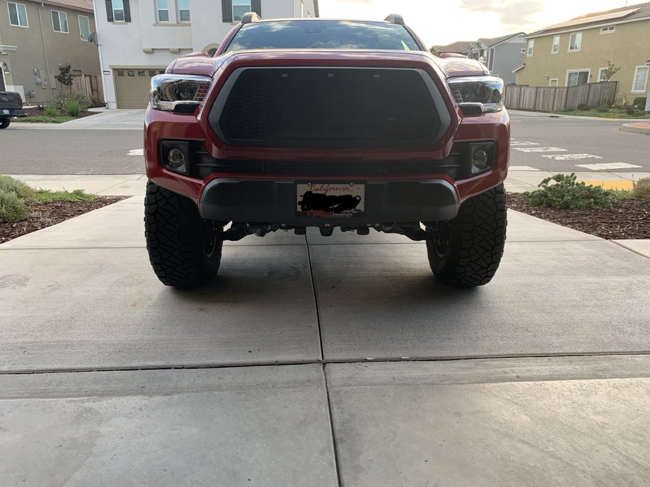

    Here they are just pulled it out of the garage

    I think rounding off the inner corner was a good move!
