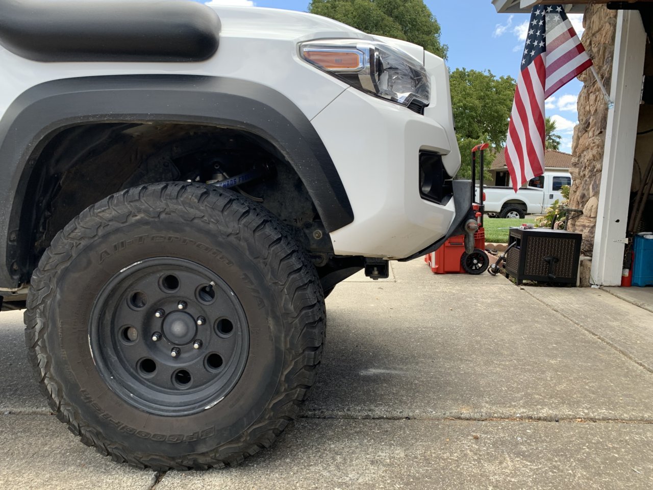

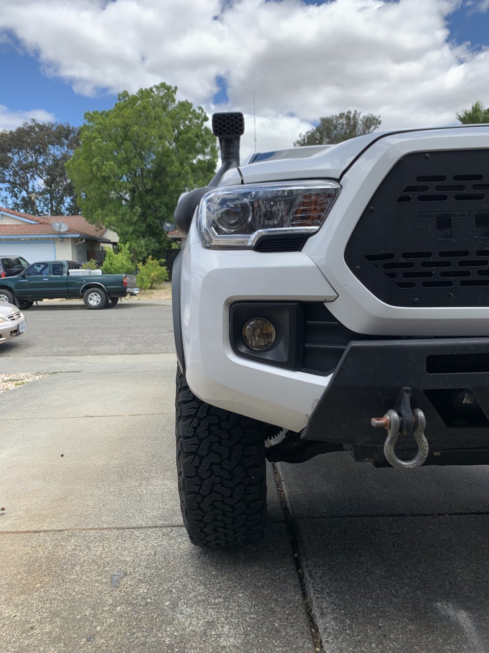

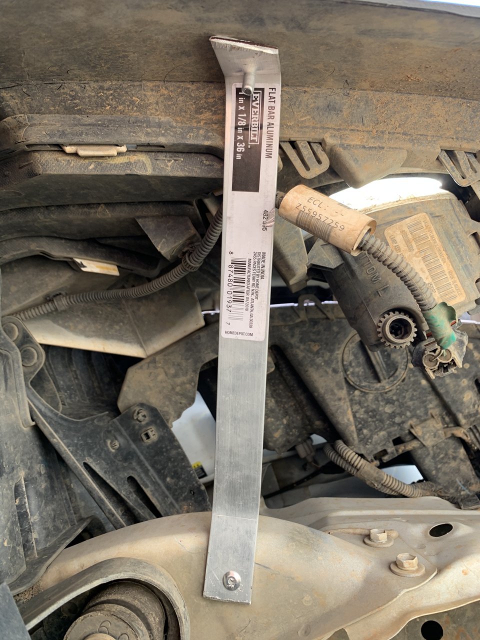

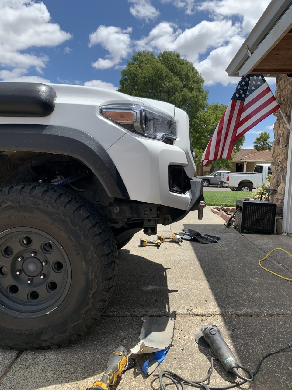

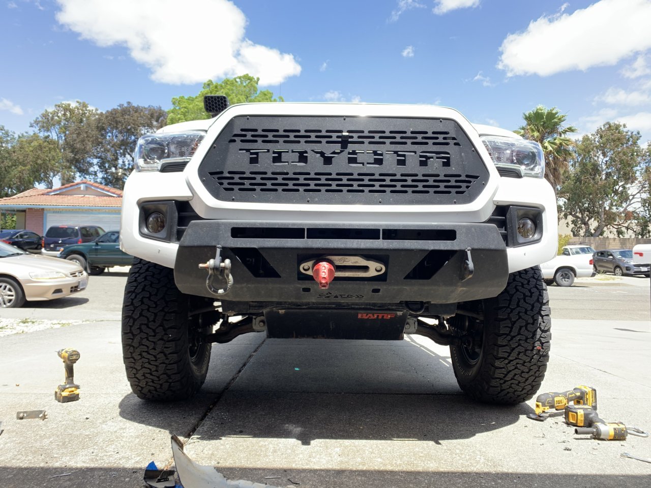

    Made the cut... the cut I made for the C4 Lo-Pro bumper took away the inside bottom edges at the fogs.... so the “typical” cut would have rendered the area useless as far as strength... made the cut and reinforced the front bumper at the cut-off with 1/8 aluminum flat bar and two 3/16” rivets... achieved the extra clearance without getting another bumper, so I’m happy. With how strong the bumper is now, I’m thinking of cutting just below the fog buckets.... and reinforce as I did.... yup, Im gonna rock this for now and go deeper next time. Hahahaha
    *edit*
    pops have been color matched super white, you can’t even tell they are there.

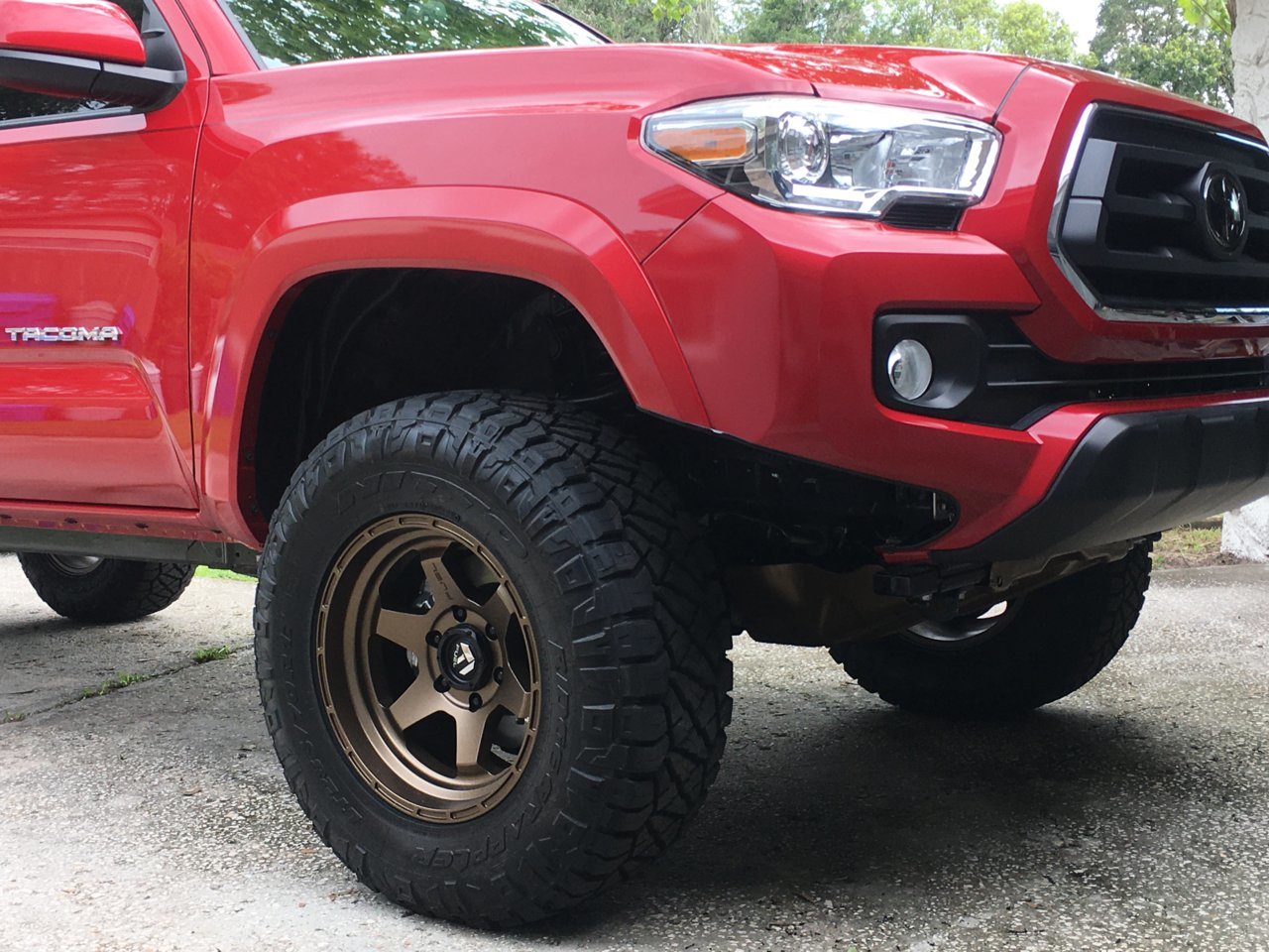

    ReadyLift 3/2, Bronze Fuel Shok wheels, LT285/70/17 RG's
