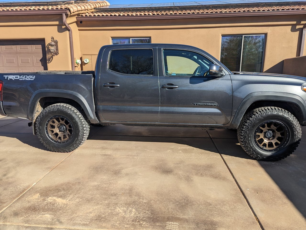

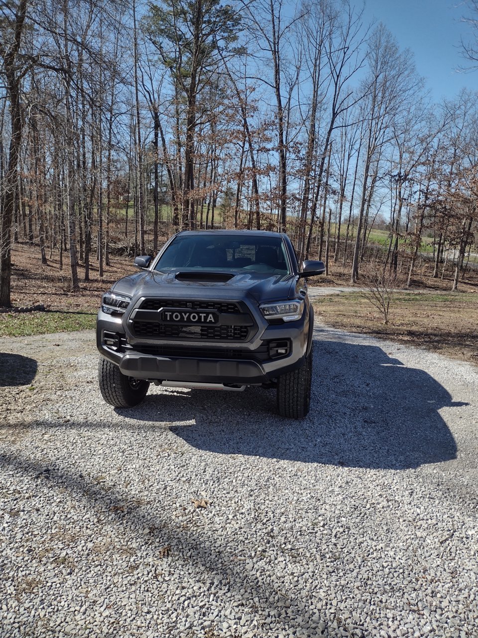

    Bone stock...

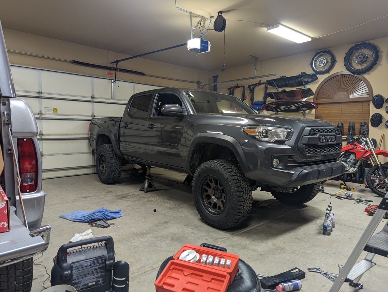

    Here you go...

    Wheels are 17x8.5 with the -12mm offset. Was rubbing pretty bad when turning on the drive home, but I do like the stance.
    Got my lift partially installed last night, will wrap it up today. SPC UCA's, Bilstein 6112's on 11/9, ECGS bushing, Icon RTX rear leafs with Bilstein 5160's, yada yada. Need to confirm, but initial look with LCA's maxed forward and SPC set back to initial caster I don't think a CMC is going to be required. Will get some better photos posted when I have it all done today.

    Yes. Wasn't too bad, just had to wrestle all the parts out of the way. And I did have to grind the puller down a bit that ECGS sells, it was a bit too wide to get behind the bushing.

    Here is the final setup with the lift installed. Very mild rubbing on the front liner on both sides, should be able to heat the liners and form them out of the way. Am pretty pleased with how it turned out.

    Did you get an alignment yet? If so, did that solve all of the mild rubbing?

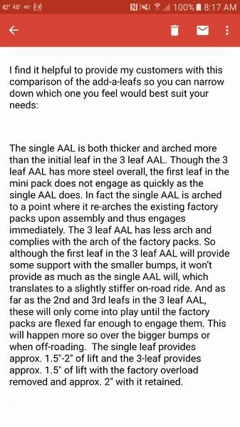

    What’s the difference between these 2 add a leafs? How does a 3 leaf only lift 1.5” but the single one lifts it 1.5-2”?

    The 3 leaf setup is more progressive than the single. Each of the 3 are much thinner than the single so it will probably give you a smoother ride, especially when the bed is empty.

    I'm happy to help but I highly recommend that you do some research. There's a ton of threads that answer these questions..... remember this is a MGM thread, LOL.
    I'll help you one more time here in the wrong thread. Here's a response from Marie at Headstrong that I came across when I was researching how to answer your question. She will be a great person to reach out to.

    Im not really understanding what she’s saying. Is the single leaf aal stiffer or the 3 leaf aal? I’m not going be doing much of any offroad. Just highway driving mostly and a tiny bit of city driving.
