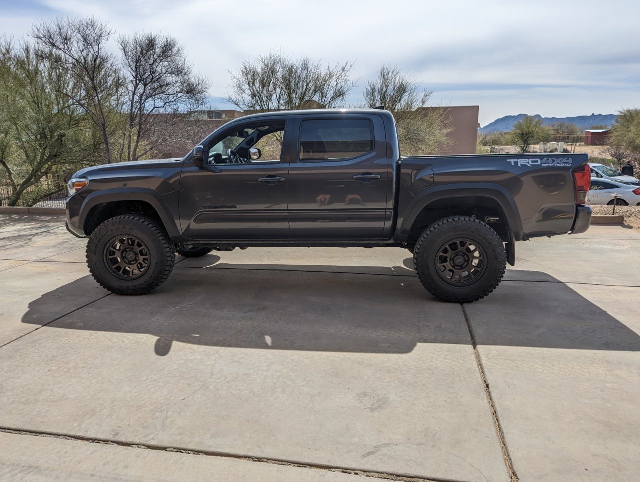

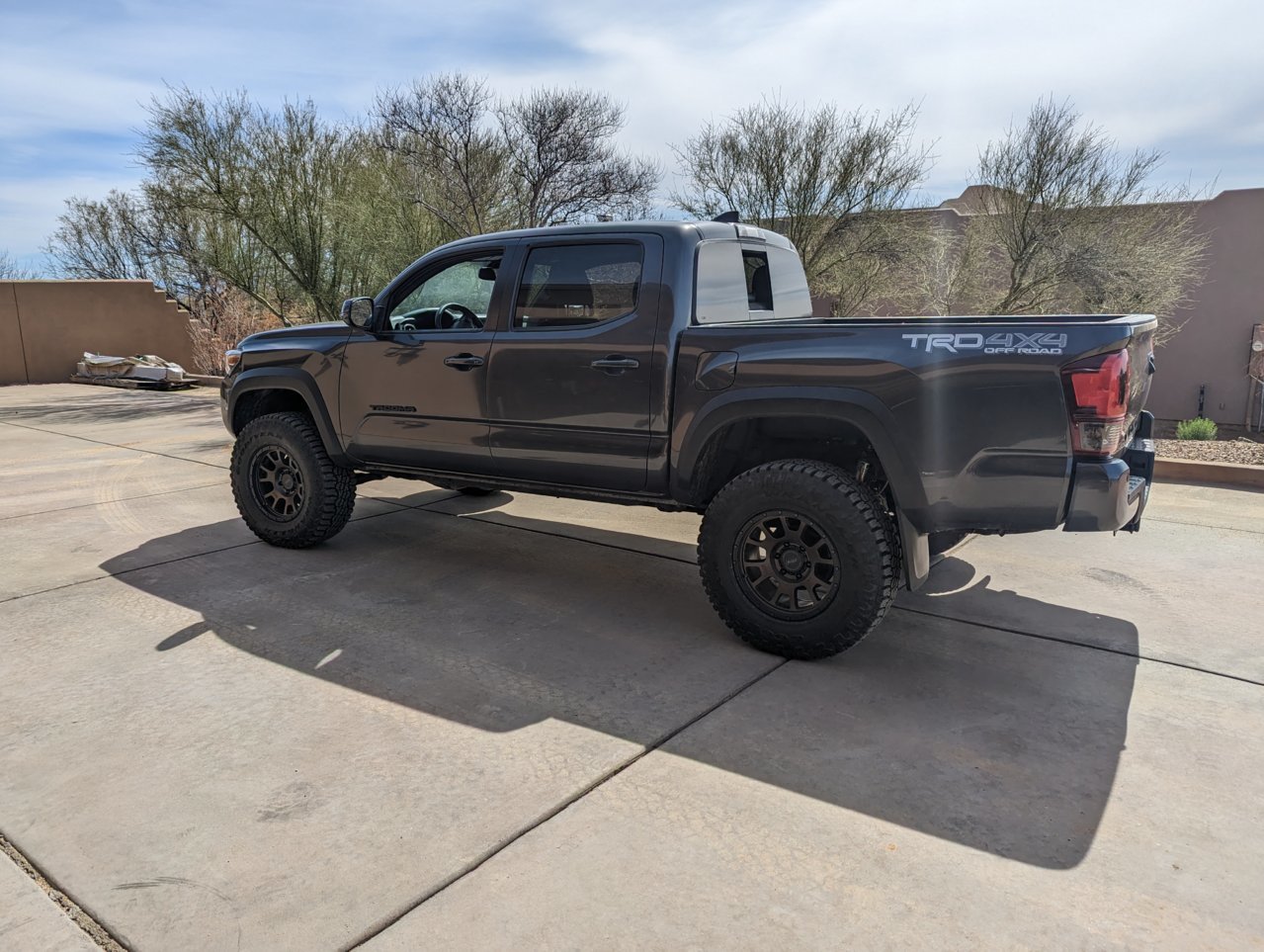

    No cmc? How about when fully stuffed? Seems like the back of the front wheel is awfully close to the body/frame. Looks good though.

    No alignment just yet, need to get it scheduled. I had pulled the caster/camber angles before I started the lift install, so returned those back when I was pulling the LCA's forward and adjusting the SPC UCA's. Then did by best to set the toe. It drives fine down the road but my wheel is just slightly crooked. Trying to get an appointment set up with AZTOYPROS for the final alignment.
    I will say - with this lift/tire combo and the adjustability of the SPC's I do not plan to do the CMC. Have good clearance to the back of the liner.

    Haven't gone fully stuffed just get, so I'll let you know.

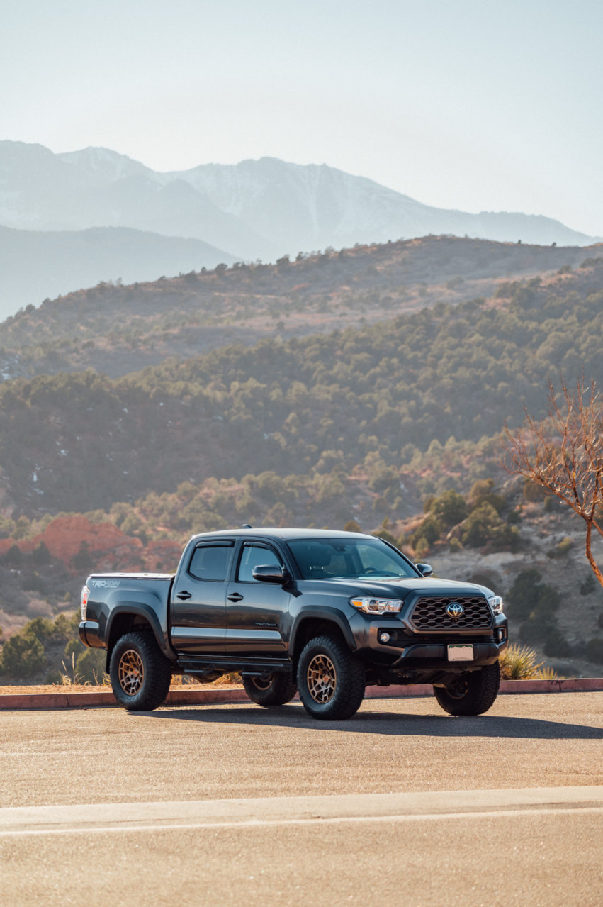

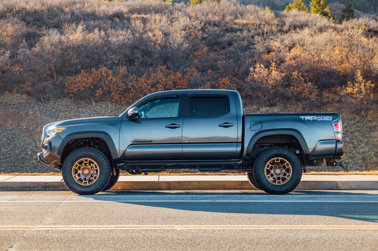

    Swapped to 285s from that last photo.
    wallyb3, BBogey, JoePun and 14 others like this.

    what lift are you running?

    Shocks and struts from the factory lift, then the Headstrong 3LAAL with their optional .5" block.

    Nate, that looks fantastic. So just to be clear, what tires are on in those photos? Wheels are 17 x 8 or 8.5" aftermarket, right?

    Thanks, Ryan! That’s my current setup, which is: 285/70r17 Maxxis Razr ATs (p-rated and measure 32.6” according to the spec sheet) on AGP Pro wheels that are 17x8 et+5 and then the factory lift shocks and struts with Headstrong 3-leaf AALs in the back and their optional .5” spacers. I had 275s previously and they just looked a little small!

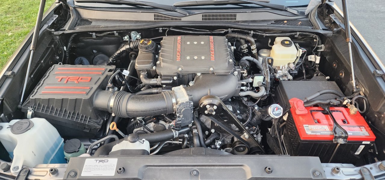

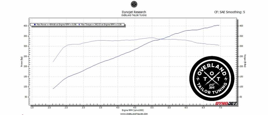

    2020 Tacoma TRD Pro @rctuningflgarage
    OTT + Magnuson Supercharger w/ 80mm - 5.29s etc etc.
    Details of my build on www.rctuningfl.com
    Rocking the best tune available... Overland Tailor Tuning - OTT!
