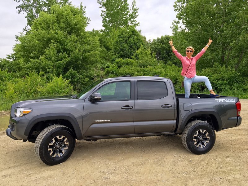

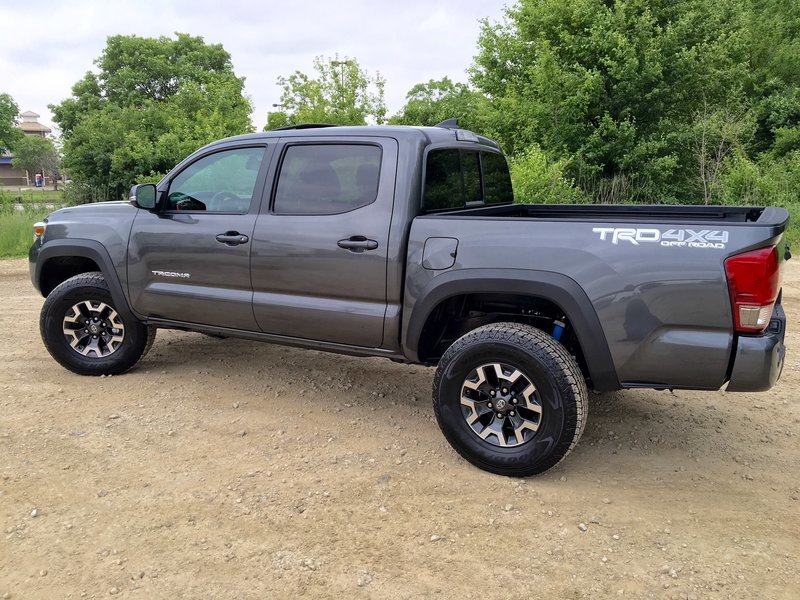

    Finally got her home to Texas after picking up from Dean at Tacoma West in Columbus, Ohio.

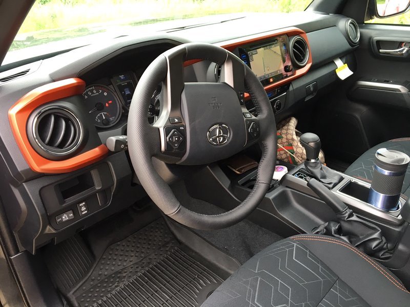

    First few mods, installed Toyota running boards, step hitch and raised reflective red letters. Aerospace 303 interior and cloth seats. I have a Gatortrax retractable cover ordered..... Hoping to get the TRD wheels from Dustin at FN Wheels in the next week...plus other things....will update as installed.

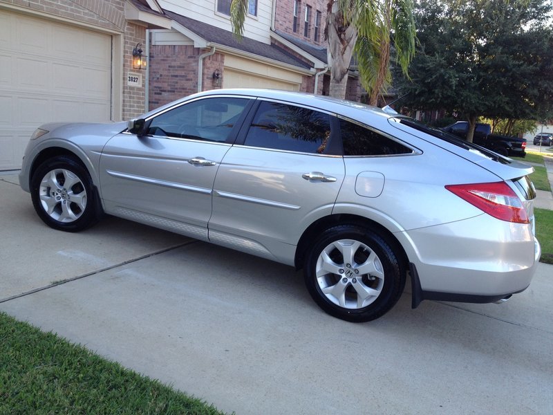

    Wife is happy, she gets my Honda Accord Crosstour.....

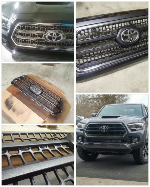

    Yeah it still looks factory. Im still on the fence about dipping the bezel.
    Anyway.. Super easy the insert completely removes so no masking.

    Looks great the way it is. What process did you go with? 6 coats 20 mins between...any glossifier?

    yeah exactly, maybe only 4 or 5 coats. I sprayed very lightly and speckled it to prevent runs. This gave a rougher texture which i like. One tip is to set the can in warm water to increase the pressure and and give a cleaner spray. Also never start it while pointed at the part. The first bit of spray is messy or poor quality.i would start the spray on cardboard and the. Sweep across the grill.
    So far it is very durable. I have pressure washed it from 6inches with no peeling.
    No glossifier

    Also lookup a tutorial on removing the grill and take your time. It is tedious and you dont want to break any tabs.

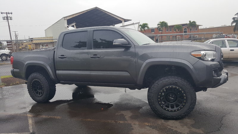

    Just sharing a pic of my truck

    I like it! What's your suspension/wheel setup?
