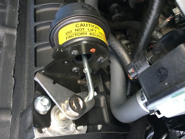

    My bypass actuator was not properly mounted from the factory. I noticed it last week. It isn’t secure and moving back and forth due to broken plastic nubbies. Magnuson overnighted me a new bypass unit. It is going to be tricky trying to install and adjust with the charger mounted but I think I can go off feel and sound of the butterfly operating inside...

    let us know how the install and adjustment goes!

    You can see only one nubbie came correct. The whole thing moves in and out from its mount.

    wow - looks like they took a hack job to it with the original fabrication.
