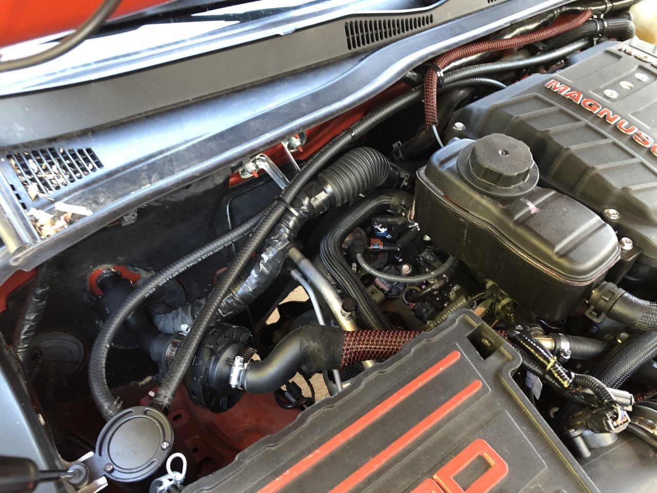

    I updated the first post with some performance data I’ve been recording on some rural asphalt roads. Don’t take it as the Bible. I’ll go to the drag strip whenever it opens up again and update the info with hard numbers. A buddy of mine with a Buick Regal GS challenged me. We have the exact same 308HP, but he is a lot more aerodynamic. Should be a fun race. He should win, but I’ve been practicing my launches lol.
    Also on the docket the last few weeks has been finding a way to make the SC louder. I’ve made some progress and have a prototype sound tube set up.
    I used a 2015 Ford Mustang sound pipe and have been playing with cutting it up to fit the Tacoma. I’ve got it laid out almost how I want. It is currently increasing the whine by maybe 5%
    I’m losing a lot of sound due to too small a hose at the intake. I need to get a proper sized port added to the intake for this to really work. I just have it teed into the valve cover vent hose for the proof of concept right now. I’ll keep working on it on and off for awhile. I have some special heat shrink clamps that will replace all the ugly metal clamps when I’m done:)

    Interested in the heat shrink clamps. Might be able to use those for some other projects.

    A company called hosecandy sells them. I have some extras left over from other projects.
    You can also get them from other places. They are called “Gates power grip”
