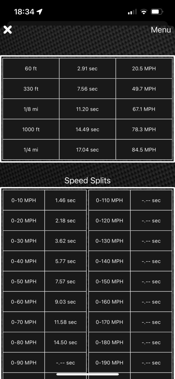

    If any one was wondering here’s a 1/4 mile pull with a 1500lb tandem axle trailer. This is with a terrible start on an abandoned chip sealed road. Believe it or not I don’t have much practice launching with a trailer. Also I lifted enough to drop boost to 0 at about 80mph for obvious reasons. I hit 80 at 14.5 seconds and 1/4 mile at 84mph and 17.1 seconds so I could have gone MUCH faster (and tested the suspension in the ditch!). I don’t have a doubt I would have pulled a mid 16 at around 88mph if I wouldn’t have lifted and had a slightly better launch.
    0-60 in 9 seconds. I’d bet I could get below an 8.5 with practice.
    moral of the story. This really shows how much improvement the supercharger makes. With 4 extra tires of rolling resistance and 3/4 of a ton of extra weight the performance isn’t far off from a stock taco unloaded!
    I probably won’t do this again. My daredevil side is sated for a few days now lol.

    But there are so many blank spots in that table...

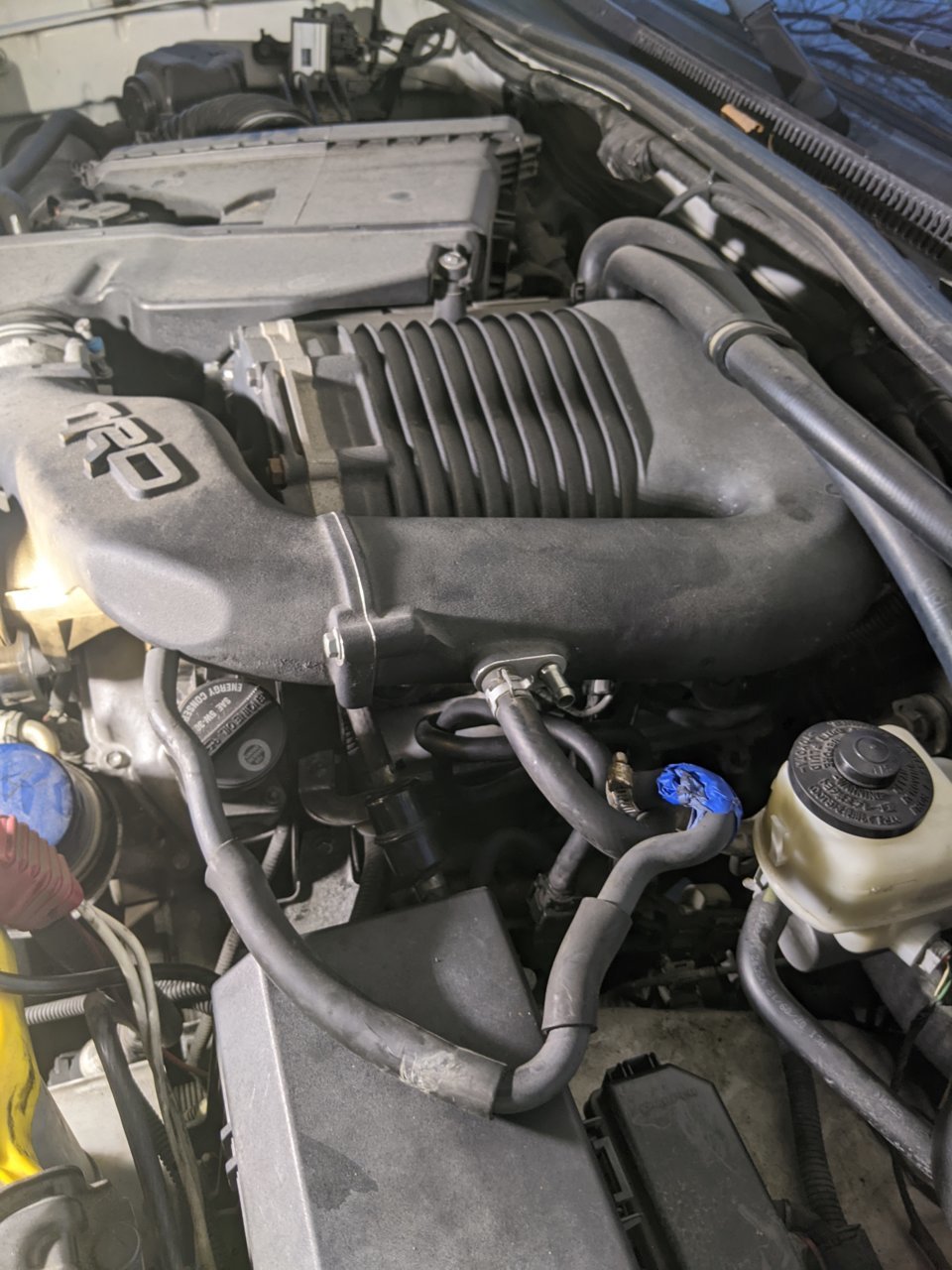

    Hey guys can't figure out where this last hose on the driver's side upper port connects.
