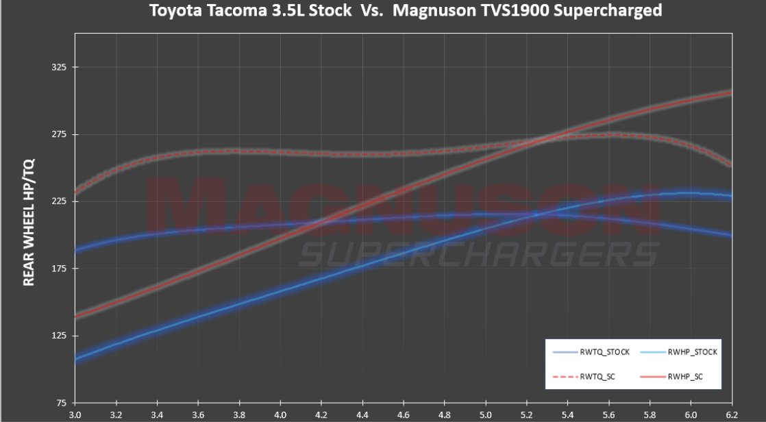

    here is the dyno chart magnuson posted. I don’t trust it because it shows the revved to 6200 and my tune only goes to 6000.
