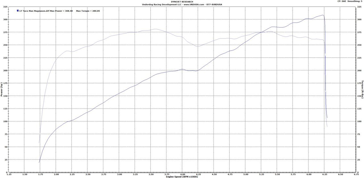

  9. Oct 8, 2020 at 7:01 AM
    #89
    Bascoma
    Bascoma I smell dog poop.....
    Sep 13, 2017
    #229871
    476
    Jake
    Deep Creek VA
    S/C 2017 OR MT
    Magnuson Supercharger TRD Bilstein 6112/5610 w/ Head Strong 3 leaf AAL URD Mark 2 Y Pipe OV Tuned (pre Magnuson install) TRD Intake TRD Exhaust TRD Skid Plate TRD Shift Knob Leer 100XR Subaru Kicker Tweeters Toyota Bed Mat Kicker CS Door Speakers Kicker H8S Hideaway Sub Toyota All Weather Floor Liners Caliraised LED Bumper Light Bar De Badged Tint Console Organizer CMC with BAMF Plates 17” SCS Ray 10’s 285/70r17 Ridge Grapplers Faux PRO Grille Hondo Radio Knobs Accumulator Delete Mod URD Short Throw Shifter JLT Oil Separator MESO Ultimate Turn Signals MESO Map Lights MESO V2 Dual Color Dome Light RC Seat Covers Stoptech Slotted Rotors Sport Pads and Stainless Brake Hoses
    My Dyno results
  10. Oct 8, 2020 at 7:16 AM
    #90
    OpelGT
    OpelGT [OP] hOPELess Power
    May 6, 2018
    #252678
    558
    Texas
    2018 TRD OR Tacoma MT, Magnuson Supercharged
    Nice!!! They took it all the way down to 1750rpm!
    If I’m bored later I’ll make an excel graph comparing yours and OVTune. Too busy today though.

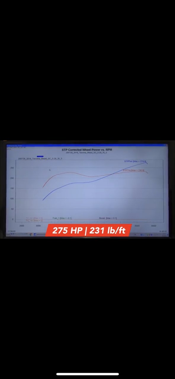

    #92
    Myles G
    Myles G Well-Known Member
    Sep 24, 2018
    #267233
    599
    Myles
    This is OVTT not just the tune I couldn’t find the tune graph anymore
  13. Oct 8, 2020 at 8:39 AM
    #93
    Myles G
    Sep 24, 2018
    #267233
    599
    Myles
    This is awesome thank you

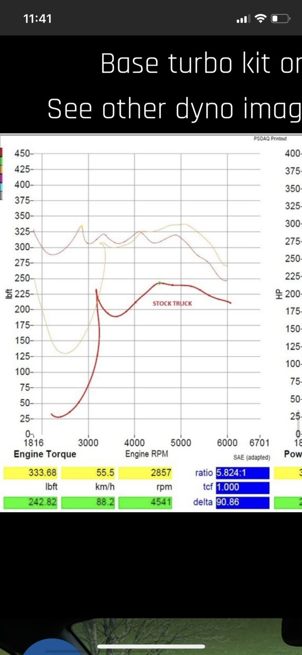

  14. Oct 8, 2020 at 8:58 AM
    #94
    Myles G
    Sep 24, 2018
    #267233
    599
    Myles
    Here’s tacomabeasts MSC dyno
    He’s got bigger tires and weight
  15. Oct 8, 2020 at 9:07 AM
    #95
    Gen3TacomaOBX
    Gen3TacomaOBX Well-Known Member
    Dec 12, 2018
    #275624
    1,605
    S
    2018 Tacoma DCSB SR 4x4
    Bilstein 6112 front / 5100 rear (extended) shocks, Headstrong AAL, Firestone airbags, 4.88 gears, OME Carrier bearing drop kit, Aluminum 1/4" skids (engine to transfer). Custom sliders (1.75" HREW tube w/ 3/16" base plates). Custom front bumper and high clearance rear bumper (1/4" steel plate, 1.75" tube.) Apex 5500 winch w/synthetic line (36lbs) and required accessories for an underpowered winch (snatch blocks and extra line.) Tekonsha P3 brake controller, remote start, any-time-backup camera w/ front facing camera, Leer 100R shell (w/e-track single slot tie-down mounts for removable Yakima EasyTop.) Cat shields by CaliRaised. Husky liners, window tint, heated seat (passenger only.) Relentless bed rail brackets with QuickFists (shovel/axe/fire extinguisher.) Hondo Garage Un-holey vent mount. Anytime rear with front facing camera. Billet front seat risers. Viair 88p. 265/75r16 Goodyear Ultra-terrain tires.
    :worthless:
    unless they're screen caps from a phone in portrait mode.
