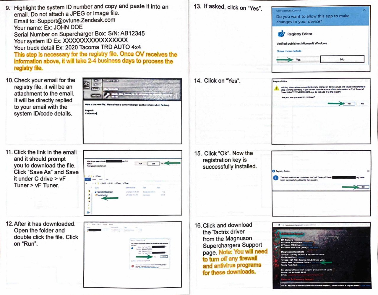

    Mine isn’t installed yet but I’ve found the opposite. I’m trying to find a shop to install mine. I went on Magnuson’s site and found that the local Toyota dealership was a dealer. I called them and through several back and forth emails they decided they don’t want to be a Magnuson dealer anymore. I moved on to another shop off of their site and it’s been three weeks since I got the kit and let them know I’d like to set up an appointment for install. It seems like they have no clue how to work with vF Tuner so I asked Magnuson if I could get PDF versions of the installation manuals to provide them so they could figure out what needs to be done before they take my truck apart and can’t figure out how to make it work. I don’t know why they have posted these on their website since I’m sure buyers that plan on doing the installation themselves want to see what they are getting themselves in to.
    Seems like a simple request to me. I ended up scanning the vF Tuner Installation manual and sending it to the second shop and they still can’t figure things out. I’ve moved on to another Toyota dealership that did a Magnuson install in a third gen Tacoma about a month ago, except I need to drive there and stay in a hotel while they do it.
    Also, my previous question seems to have been overlooked. What do I need specifically from the packaging to insure that there will no issues getting the tune? There was mention of the serial number. Is that all I need?

    To answer that I will look in my instruction manual and quote the step. I don’t want to go search for my instructions so just look at yours. It’s in the OVTune instruction booklet.
    I would do every step in that booklet aside from actually flashing it before you send it to the shop.

    Looks like #9 in the VFTuner Flash Tool Instructions.
    Thanks!

    This is a summary how I did it.
    First need a windows computer or Mac running windows. I used a Mac.
    Stop anti virus and firewall programs.
    Follow steps 3 to 9.
    Send the email as stated in step 9.
    OV Tune will send you the Reg file in a day or two.
    Run the Reg file sent by OV Tune. Steps 10 - 15. This authorizes your computer.
    Step 16 - 24: Got o Magnuson Support page and download the driver.
    Install it.
    Step 25 - 27: This will read your truck’s calibration so Magnuson knows which file to send you.
    Step 28 -30 : Request Magnuson the calibration file by filling the online form.
    Should receive the file next day. Save it were you can find it.
    For the final part I went to the shop with my laptop. The technician was finalizing the install and waiting for me.
    I did the flash myself with the technician watching.
    Follow steps 31 to 36.
    Then the truck was started for few minutes.
