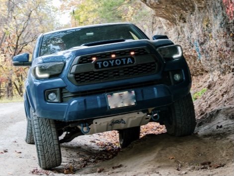

    You still sitting?
    It’s all stock
    Tires were updated in 2019 when the truck had 49,000 miles!
    A Faux Grill!
    A painted Grey skid!
    A $30 cb mounted!
    A bunch of trail scratches!
    New Battery in 2020!
    New Rotors and pads in 2020
    In May a dealership gave me $28,000 for a 2017 Sport with 100,000 miles. They had it up for sale at the dealer the next day for $32,500.
    My Radio didn’t work and needed a new head unit. The tires were at 50,000 miles with 1 that had a slow leak. The windshield had a crack. The frame rails were a rusty red!
    Also I haven’t replaced the belts, hoses or plugs!
    I did recently replace the battery and put new rotors and pads on.
    I probably could have gotten more selling it privately but I also saved $1000 in tax savings by trading it in
