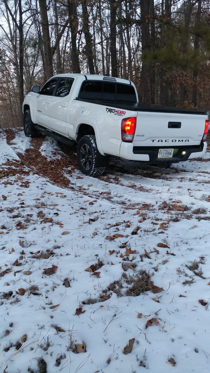

    Damn, Maybe just a bit of snow in that Pic! These ar Weather Tech? How long to install, and did you have to drill anything?

    Most snow in Raleigh, NC in 7 years. The snow pic is my current 2017 TRDOR and they are Toyota OEM, Super easy to bolt on, I think I did it in about 10-15 min, no drilling, remove and reinstall several bolts from flares and add one bolt per flap. Flaps come with the 4 additional screws needed. The weather techs were non flare version on my previous 2016 SR5, pretty much same install, no drilling, but I was missing a clip from the front fenders needed for install and weather tech didn't include it, so I had to get a couple from the auto parts store. That clip is used to mount flares so that shouldn't be an issue with weather tech flared versions.

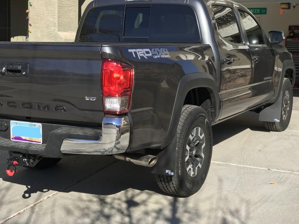

    cblow5 - your rig looks sweet! Where did you buy your Rokblokz? what size? small? Did you order any special hardware or is there som stainless steel washers exposed on the underside? Any pics of that side? You running standard or w lift? Thanks for your help and suggestions

    I did the same. The rear ones looked good trimmed about 3/16”-1/4” below the 4x4. I used tin snips and a sharpie to outline first.

    Mine have been great for use during the winters! They are very durable for light 4x4 use. I received only minor scuffs with lots of contact from when I forgot to take them off on the trails once. Have you reversed yet with contact? I love the product, but nothing is going to save them (or other damage) when they are caught by your tire backing up in reverse. Experience any river crossings yet with Rokblokz?

    Thanks cblow5 for the pics. The screw heads don't look that noticeable, and if they are I can dab some rustoleum paint to to help blend. Looks like I am going to order some RB's! Thanks again. Can't wait to see your lift when it's done.
