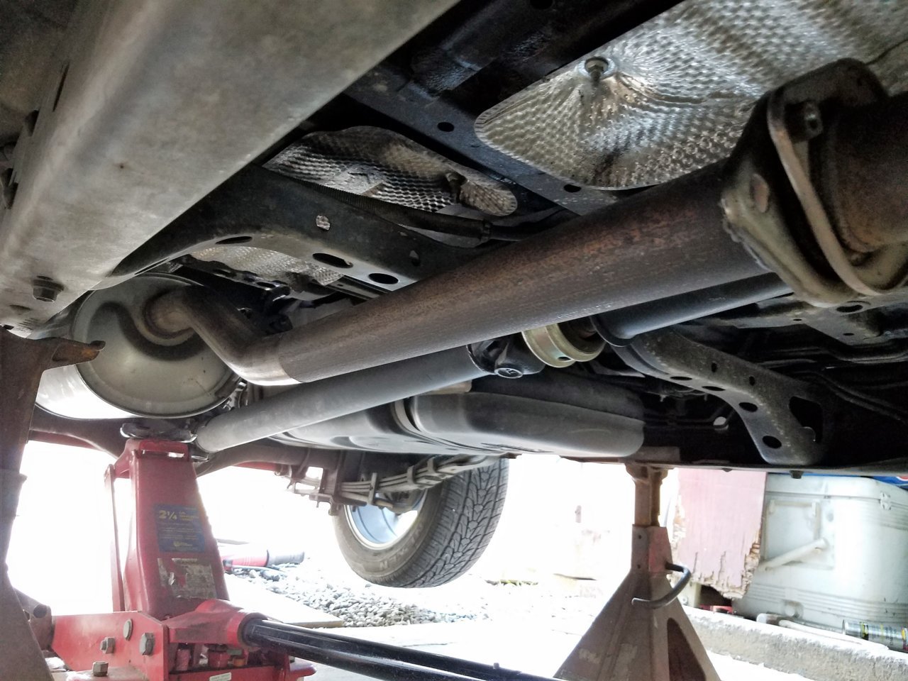

    A few
    Need to splice in your front section and bend or reweld tail pipe hanger .
