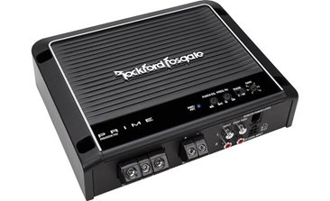

    Rockford Fosgate R500X1D

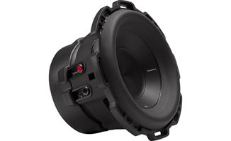

    Subwoofer:
    Rockford Fosgate P2D2-8

    Nope, speaker level out to the sub amp via a ********* plug and play harness.

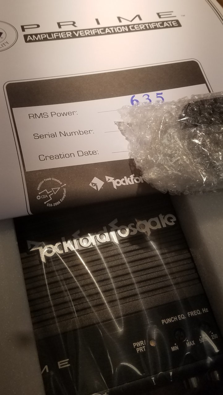

    Boxes piling up...nice to see they still do birth certificates.

    Stock headunit running the doors, amp for the sub is running at 4ohms so 300 watts.
