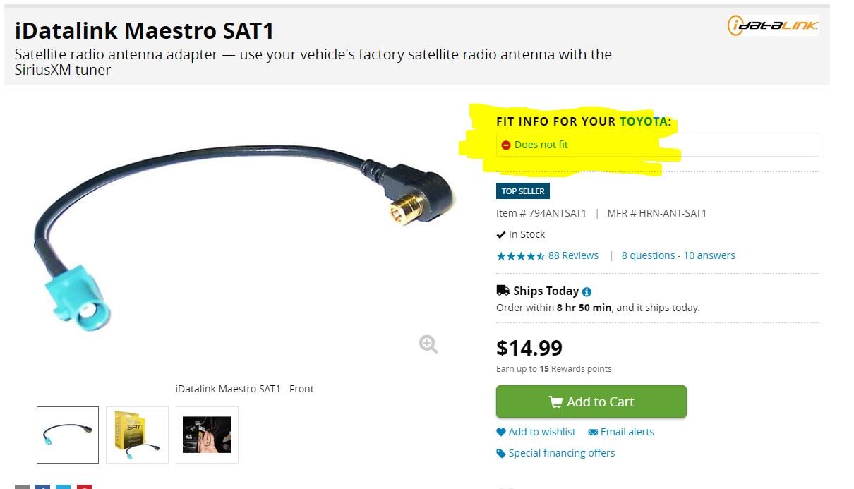

    @destin_meeks you'd think, right. I have the sony xav-100 crutchfield guys, and their website says it's not xm ready . . . Also, here's the clip of the page where it says the oem sat cable adapter is not compatibledatalink tacoma.jpg .

    Ugh oh yeah I forgot that made that unit. Not sure why it ever got approved for production.
    Swapping for pioneer/kenwood, everything would still work fine. The settings on the steering wheel control module might need to be changed (very easy to do) but that’s it. Cut off the Sony harness, wire up the new harness, swap the mounting brackets over to the new unit, and slap it all back together.

    thanks @destin_meeks so there's not even a need for an adapter to oem sat antenna?
