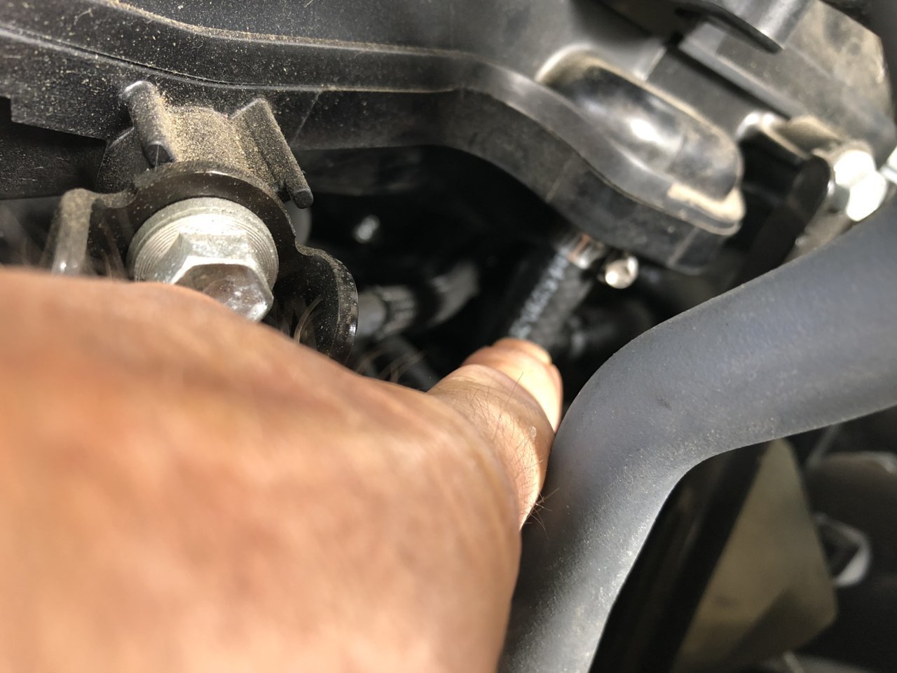

    C6781BC0-147C-4DA5-AADA-7398711D8CDB.jpg AB773251-8C03-4C18-86A2-7801A30CF33E.jpg
    Top photo driver side valve cover pvc valve to “in” port on catch can
    Bottom photo to “out” port on catch can
    gtdad66[OP] likes this.
