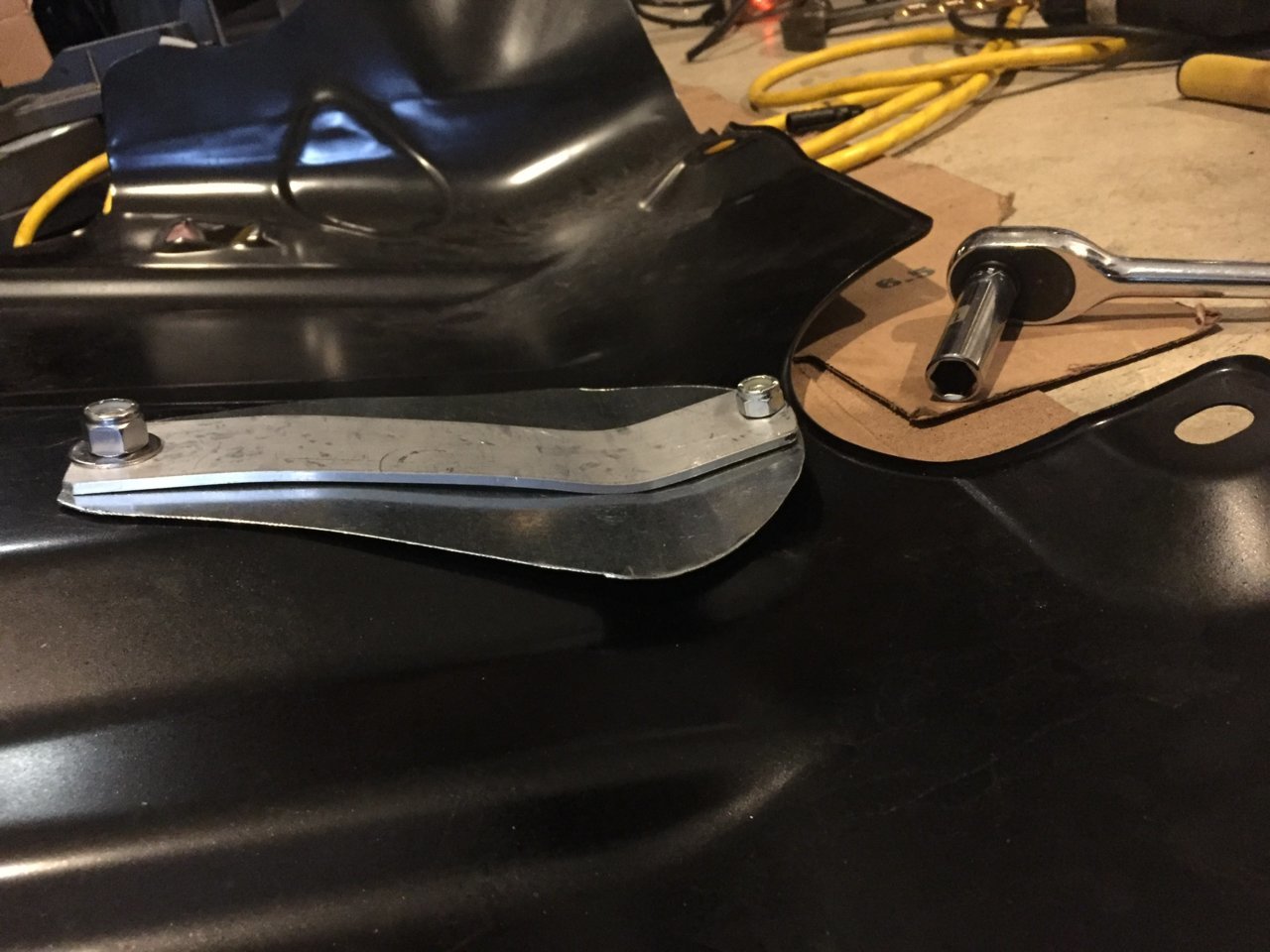

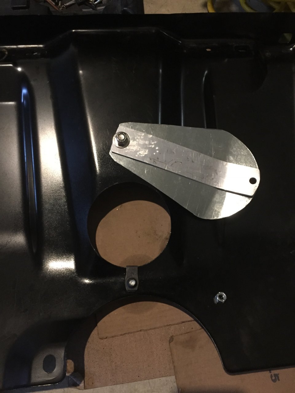

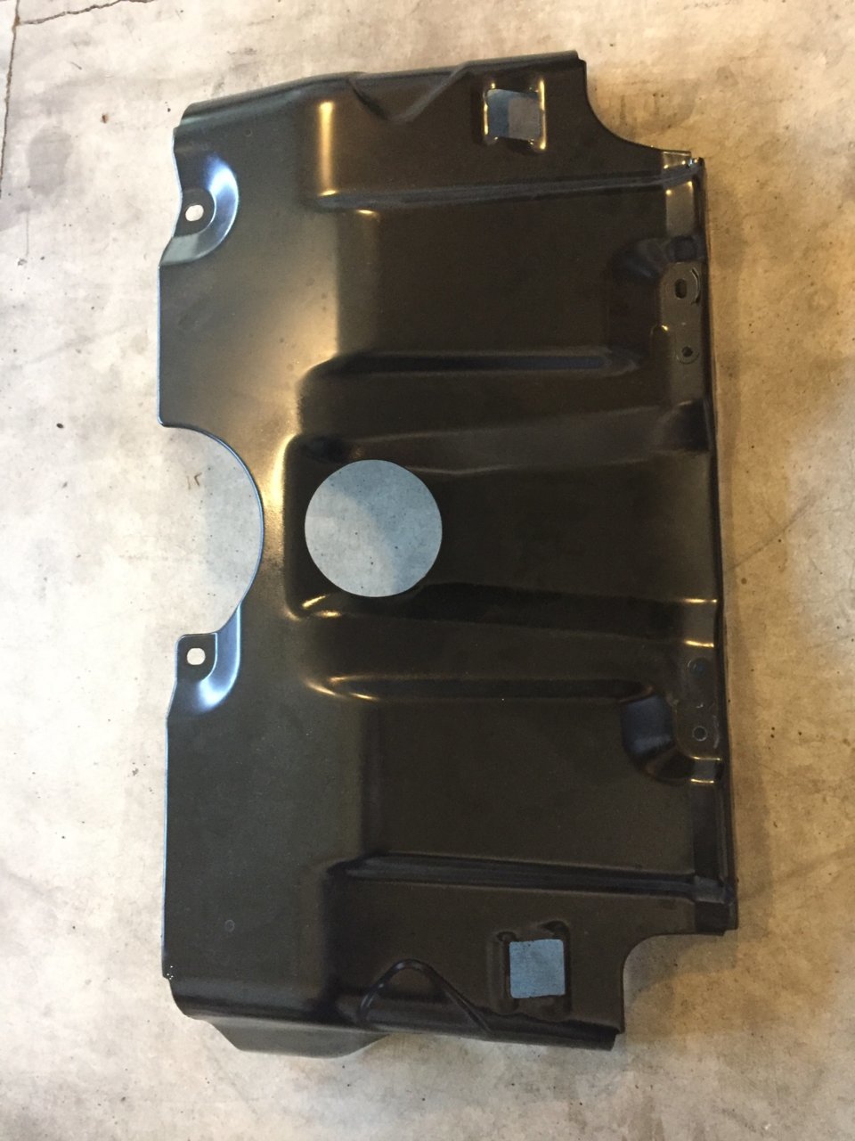

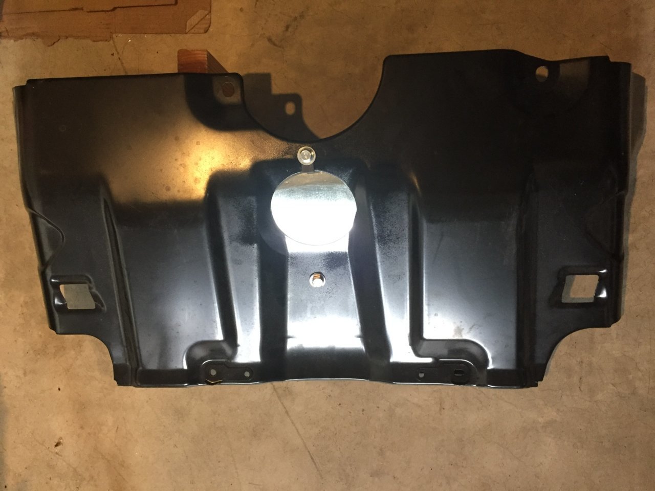

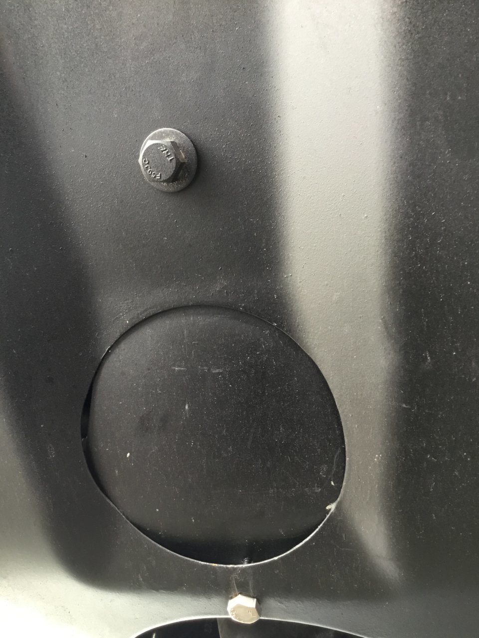

    Cut a hole in the stock deflector.
    Used scrap metal in the garage to make a cover.
    Unscrew one small bolt and attach the tube as described above to drain oil. I’ve eliminated the lock nut. It doesn’t rattle or move even without the bolt installed.
    Easy, fast and no mess.
