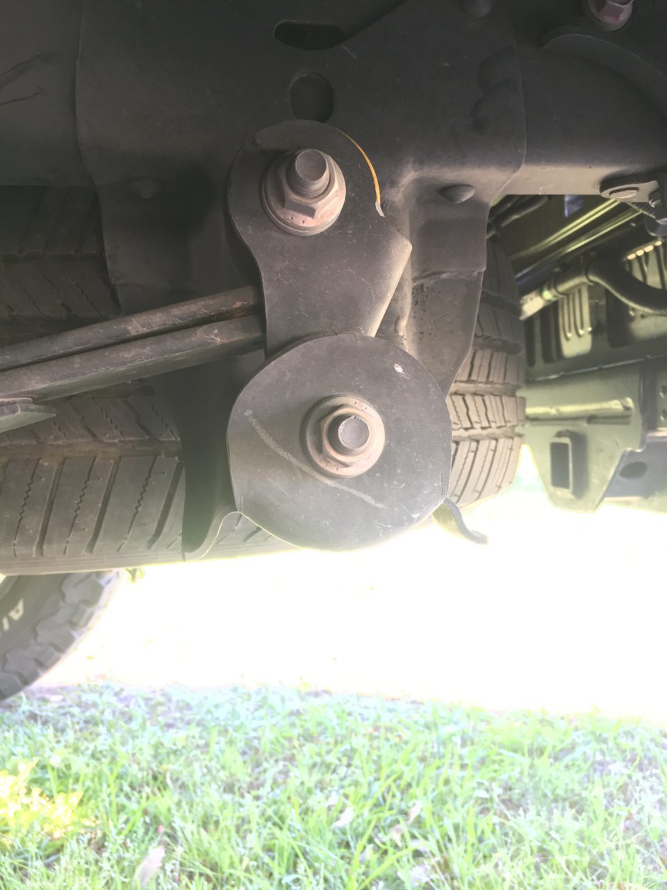

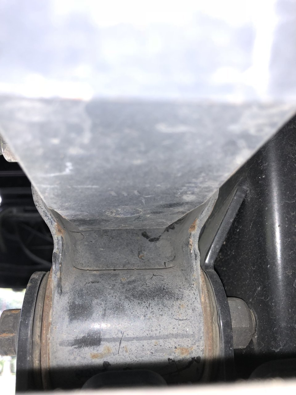

    I have a '16 DCSB with OME Dakars (light duty). After installing new suspension (5100's, 888;s, LR UCAs, and the Dakars) I noticed a clunk/rub sound coming from the rear end at low speeds, particularly when hitting driveway curbs, harsher speed bumps, etc and at an angle. I crawled underneath and noticed the second leaf in the pack was making contact with the shackles.

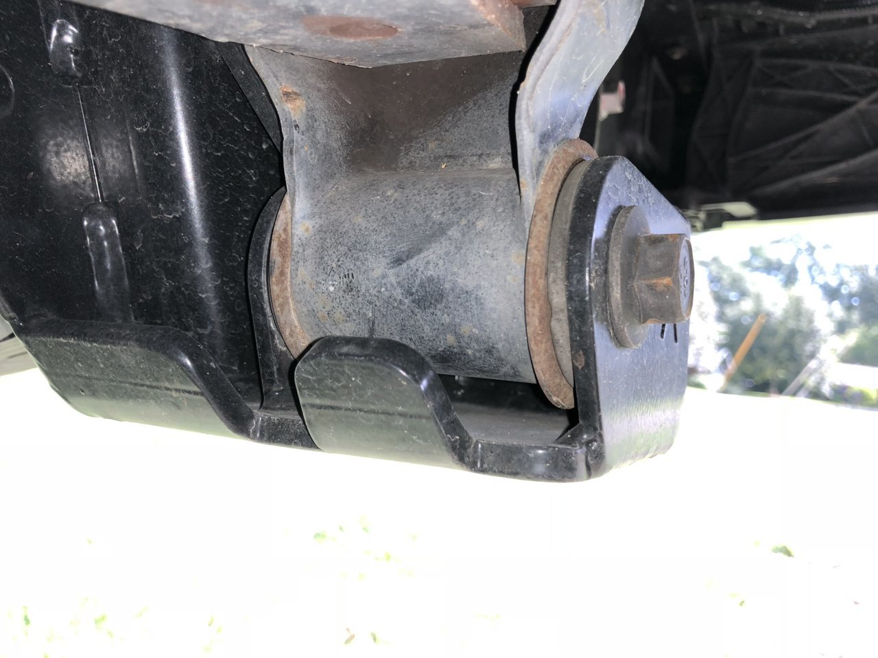

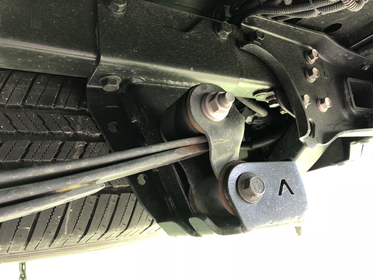

    In an effort to avoid having to grind the end of the leaf to create sufficient clearance, I installed Archive Garage Hammer Hangers. These move the mounting point slightly toward the rear and lower-- which did help, and these are awesome for reducing chatter, but the noise and contact still persists on sudden rear suspension hits at low speeds.
    My local mechanic who does a lot of suspension work on Toyotas says he's seen this before with Dakars, but I haven't found any relevant threads on TW. Has anyone had this issue before, and if so any fixes yet?

    Big adjustable wrench, fold the contact spots out about half an inch. Done

    Is your bottom bolt up installed backwards? Shouldn't the nut face out ?

    Looks like you’re right— it’s reversed from stock after the Hammer Hanger install. It was done this way on the install video I referred to as well— see any potential issues with this?
    Thanks for the advice. I’m thinking I’ll bend the shackle in combination with rounding out a few inches of the square edge of the second leaf to get a little more clearance in there.
    TBH I don’t really want to do either on a relatively new truck, and I’m not thrilled that nobody else has had a similar issue— but hey, it’s a small problem.

    My recent rant on Dakars, I can't stand the way the secondary leaves stick into the shackle, it is excessive. Dont be afraid to modify to your needs, modification is often needed for aftermarket parts, I try to keep my parts out of that zone
    Please call up ARB/OME and tell them about the issues so they can resolve and update their design, you'll feel better

    Don't bend the shackles, you will lose structural integrity. Instead, trim away where the leaf springs are contacting.

    I just got an 2 inch OME lift with HD leaf packs and the installers ran into this problem. They cut the bolt to eliminate the extra threads and provide a small bit of clearance. I haven't had issues since, but haven't wheeled it hard in off-camber situations yet. (maybe I never will?)
