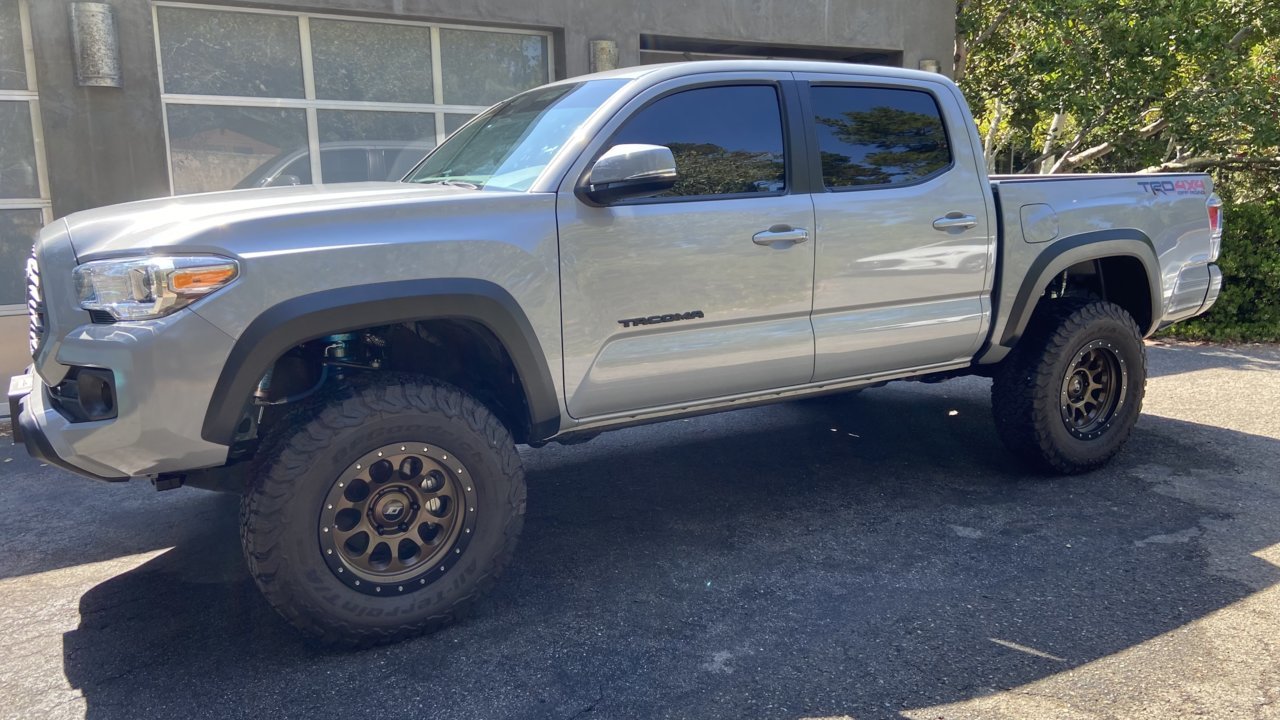

    0D329959-ED17-4B0E-8B62-D95639248653.jpg 285/70/17 with deep CMC. Contemplating going up to 295

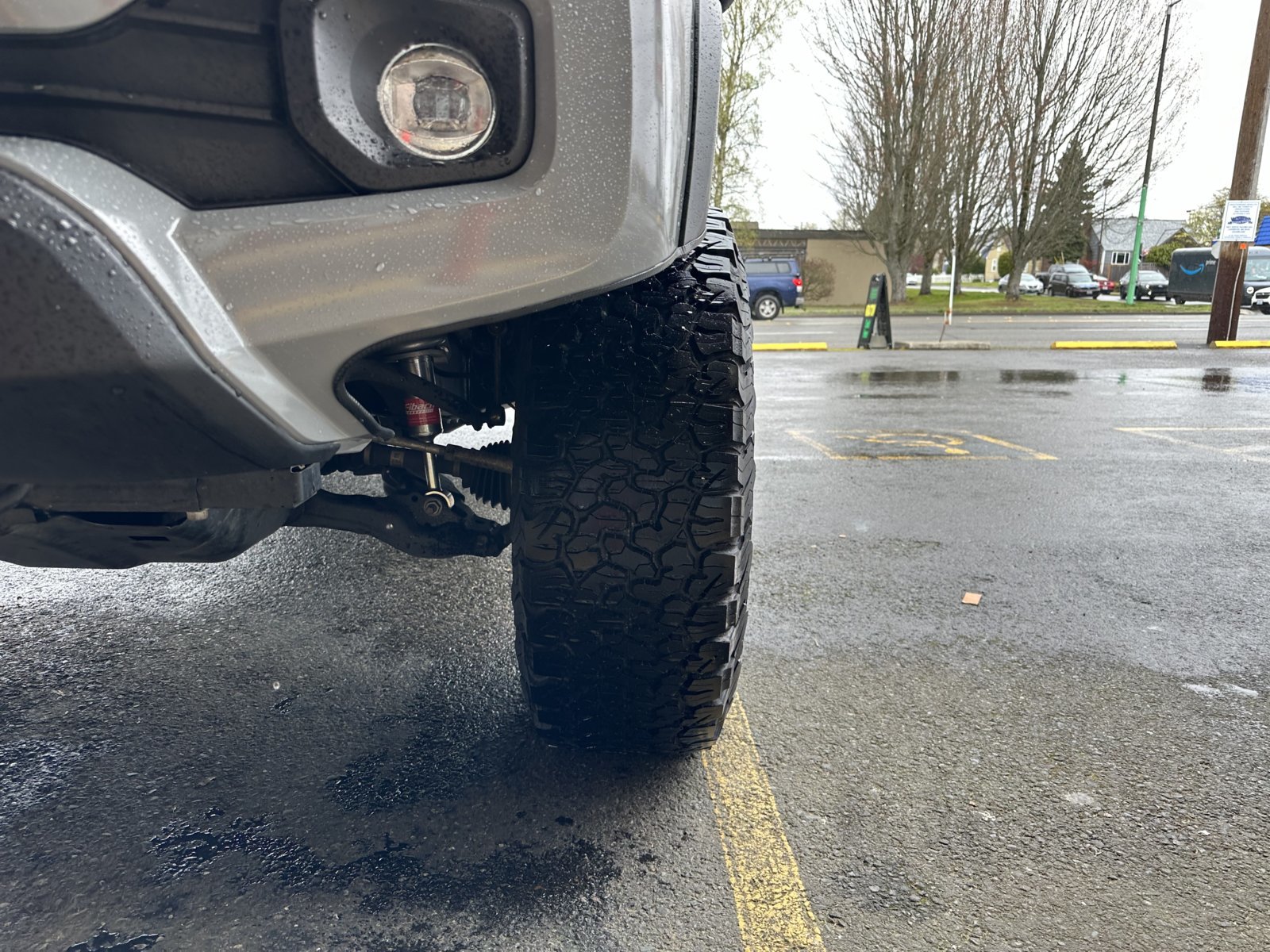

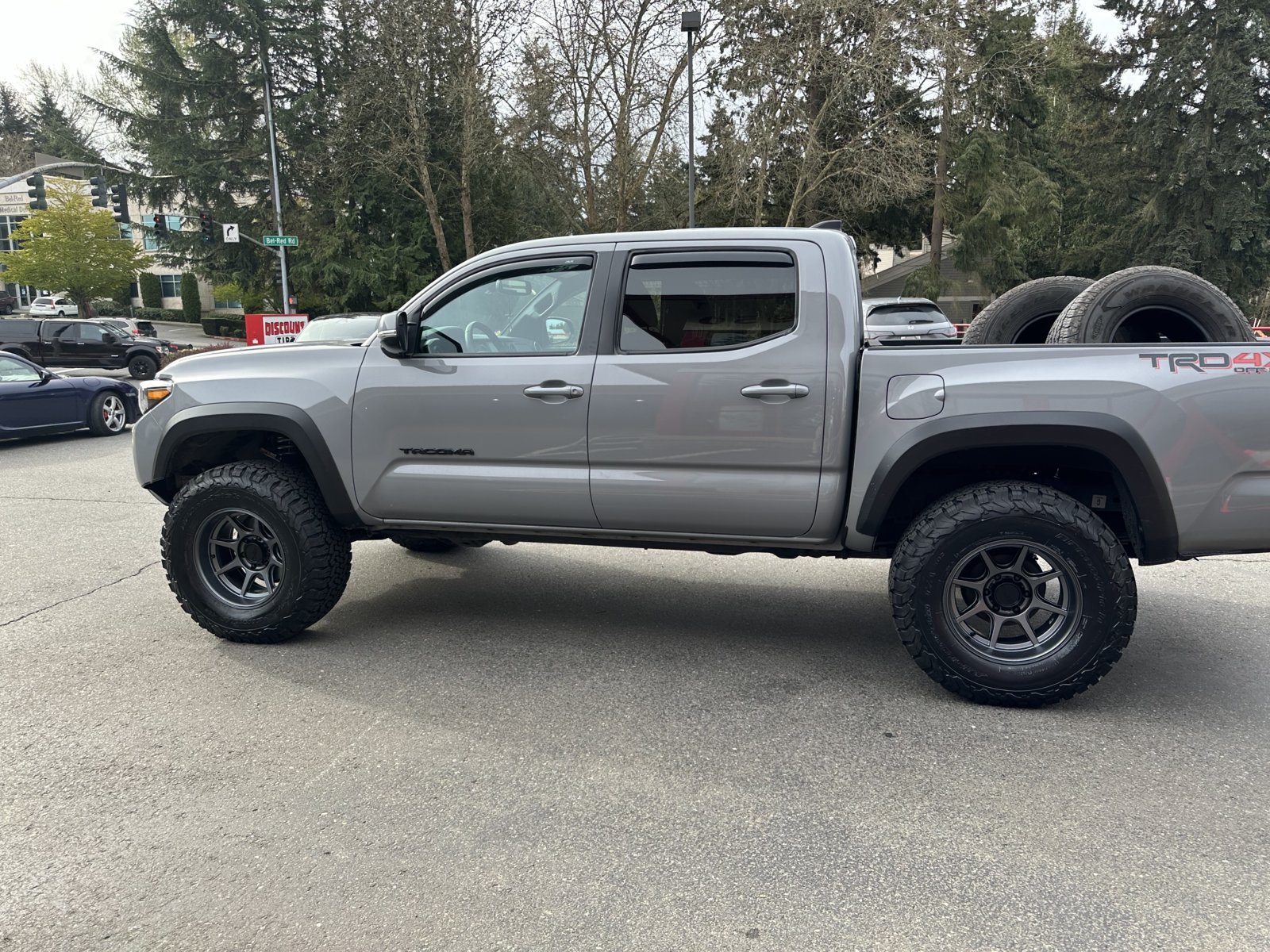

    I ended up going with 295/70r17 BFG ko2 with a -38 offset and a cmc and some more trimming of course and only did a 2.5 lift with eibach stage 1 and at a full turn I hit my cab mount with the chop still. I am now doing a relocation and c-4 high clearance fender because as soon as I take it off road I am going to fuck my shit up. It’s definitely a learning experience and so many different variables

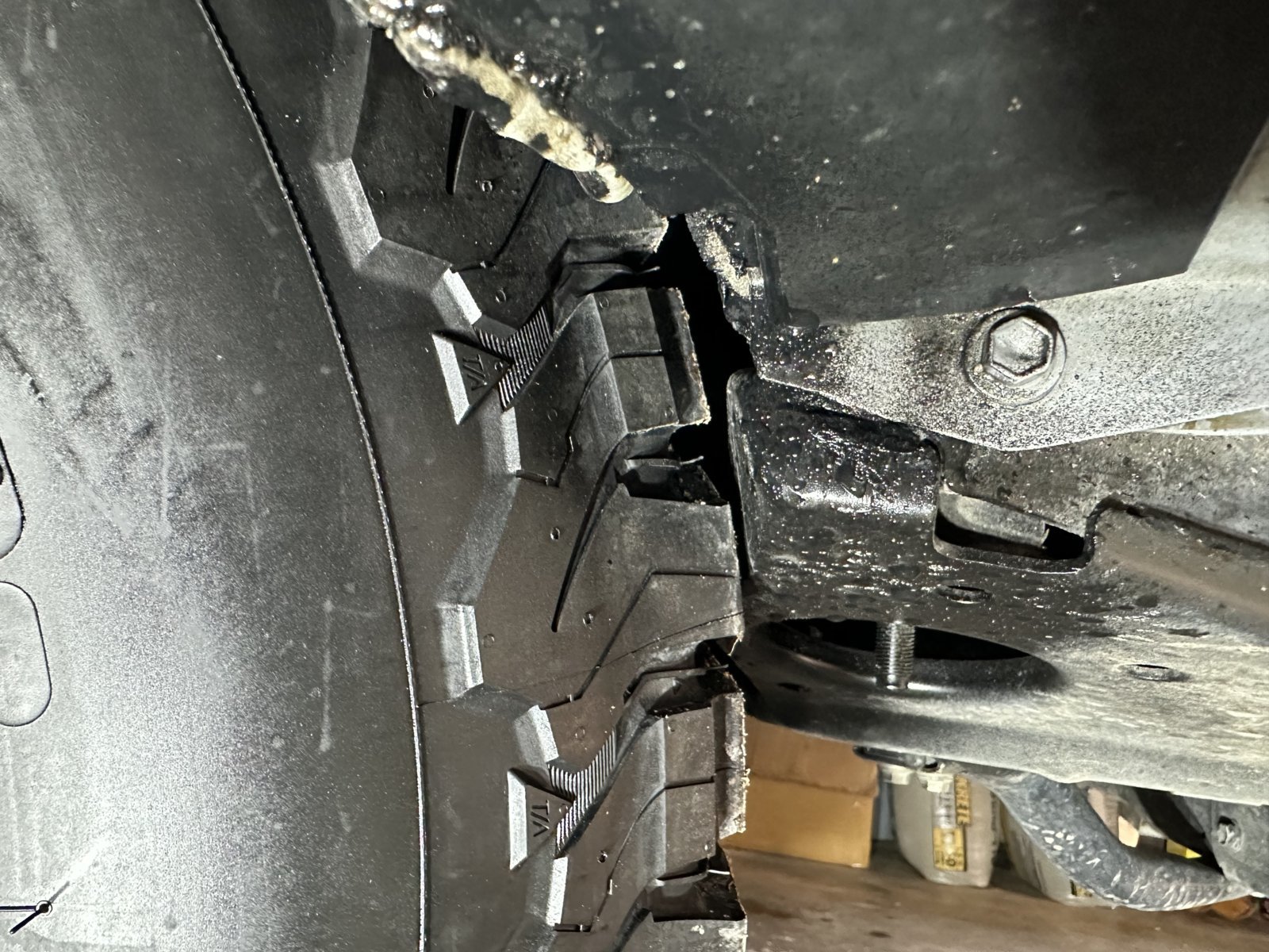

    Installed leveling kit 3” front, 2” block in rear. Purchased 285/70/17’s and tires have a rub on upper control arms inside tire wall. Would 1.25” spacers fix this? Have a 2018 Tacoma TRD Sport. I’m asking because I’ve heard mixed reviews on installing wheel spacers wearing out bearings faster? Thoughts? Stock rims
