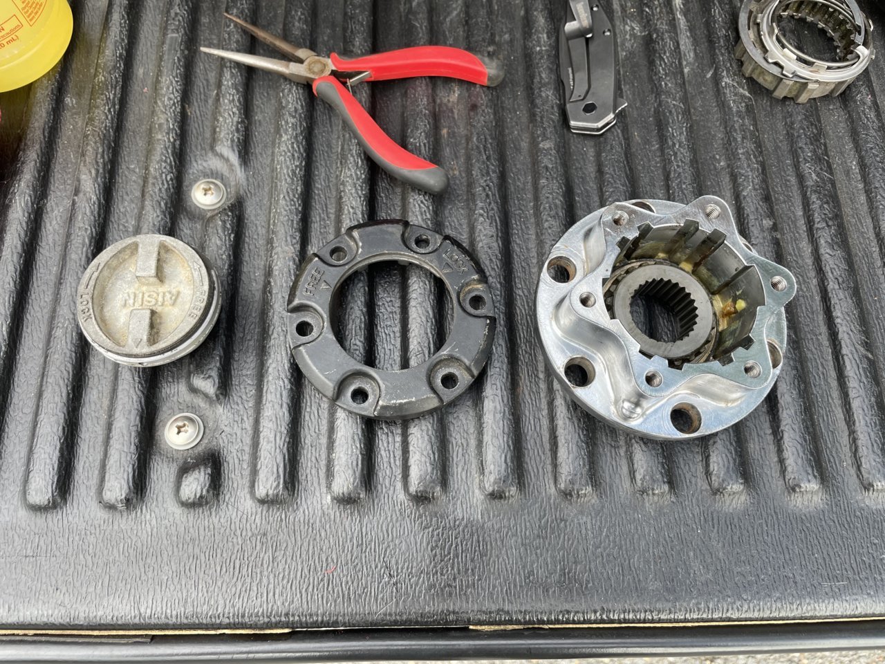

    Finally, my first question in a long time! I’m wanting to repaint my hubs black with a red center. I’m planning on soaking the left two pieces in paint thinner (once I remove the o ring). My question is for the piece on the right, should I remove the inside bits or just cover it with painters tape and paint?
    Thanks!

    Page 6 of this thread, I posted a ton of pictures for you - https://www.tacomaworld.com/threads/3rd-gen-or-4x4-conversion.691654/page-6#post-24630878
    The hub body doesn't get painted at all, and yes you disassemble further to clean everything out. You need to check for excessive wear on the pawl and clutch.

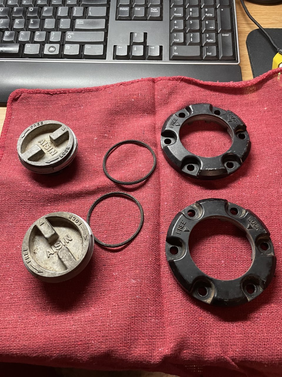

    Disassembled the other hub to get to the paintable parts and removed the o ring on both. Should I soak them in soap and water before the paint thinner or will it have the same result?
