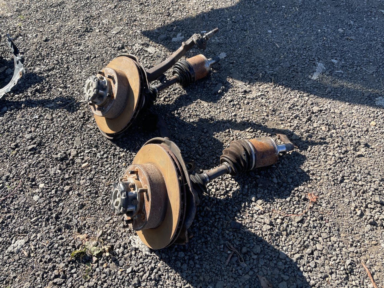

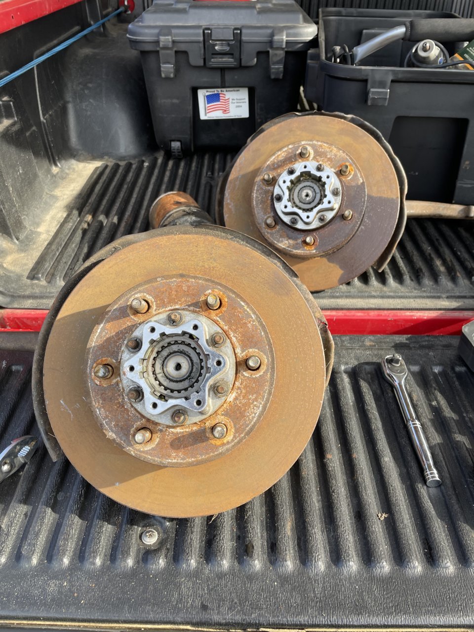

    Update from yesterday:
    Went back to that private lot to pick up the parts. The guy pulled the parts for me off the truck which was super nice of him and saved me a lot of time!
    F0C57F1E-7C18-45DC-8FA6-1CDBAFF438D7.jpg 27AFACE4-D9B6-48F7-A648-E27B5F9BED77.jpg

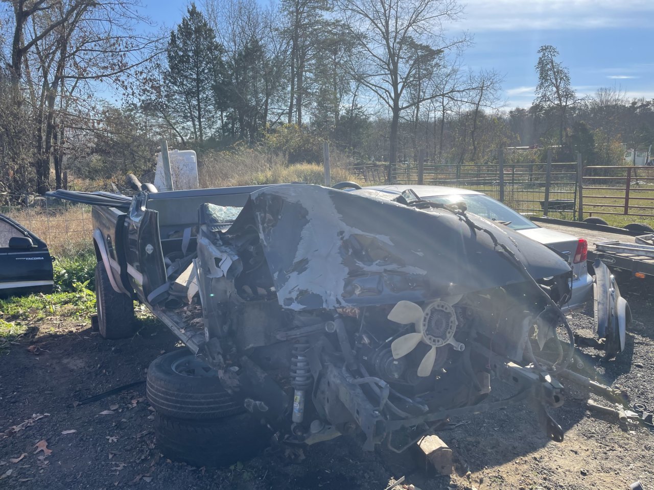

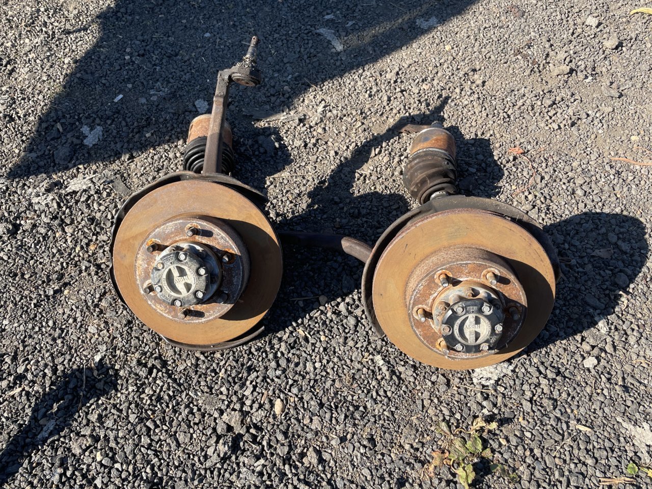

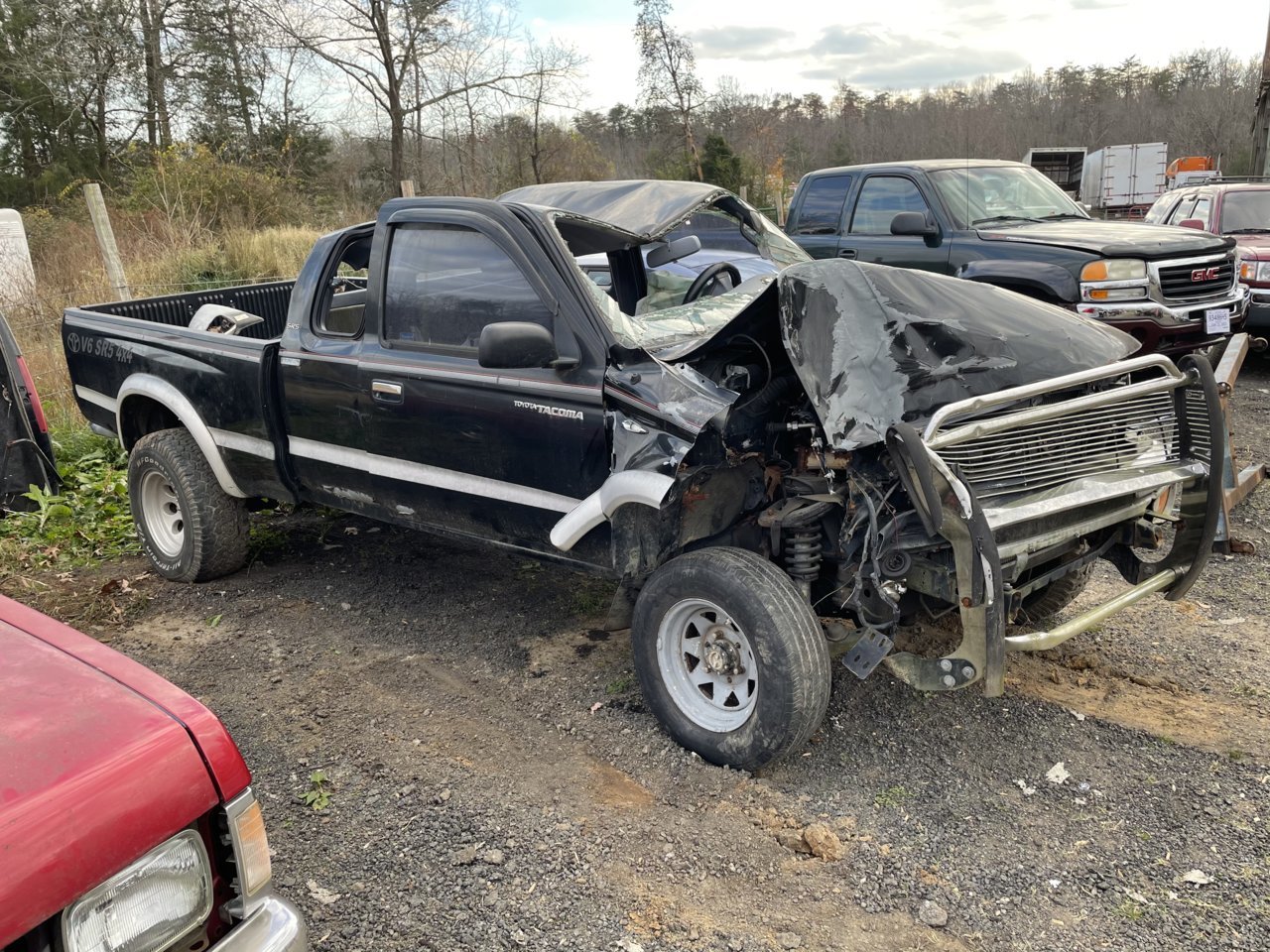

    He also converted the truck to a convertible, which is pretty cool :cool:
    96DC7585-634D-424C-A1EA-4AA04D2257EE.jpg 682D297F-74F2-4C76-A674-CA442FB4AC5A.jpg
    Now the plan is to take them apart, figure out how they work, and clean them up.

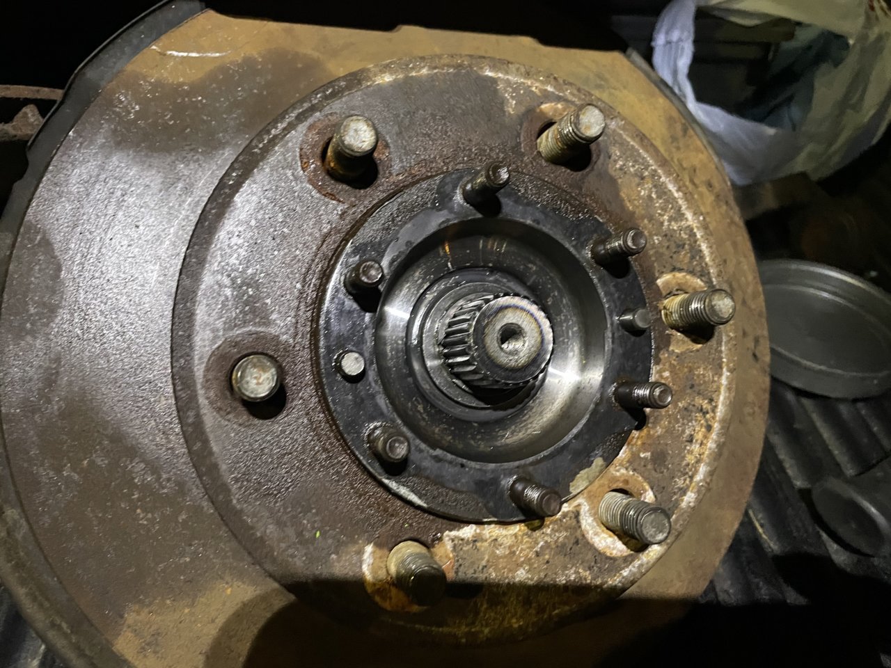

    Need help, trying to get the CV axles out so I can get them sent to Cali to get rebuilt. I don’t know what to do at this step, is this where y’all said there’s that weird nut on the backside?

    4 run, 2 don't
    You didn't remove the hub body per the method I typed up earlier.
    Pull that off and you'll see a snap ring holding the axle in place.
  16. Dec 3, 2020 at 9:28 AM
    #136
    Kwikvette
    Feb 27, 2019
    #284735
    82,177
    Fresno County
    4 run, 2 don't
    The bolts on each of the red studs need to be place back on, flush with the stud.
    Rest brass drift on the stud/bolt.
    Whack drift with 2 or 3 solid whacks, and the cone washer at the base of the hub body will pop up.
    Do so for each one, and once all removed, hub body will come up and out.
    At that point, more of the axle shaft will be exposed.
    There is a snap ring, depicted by the yellow arrow, on the axle that keeps it from backing out of the spindle.
    You're skipping steps trying to get the axle out which is why it won't come out.

    Update: Got the cone washers off! And now I am about to go get a pair of snap ring pliers :)
