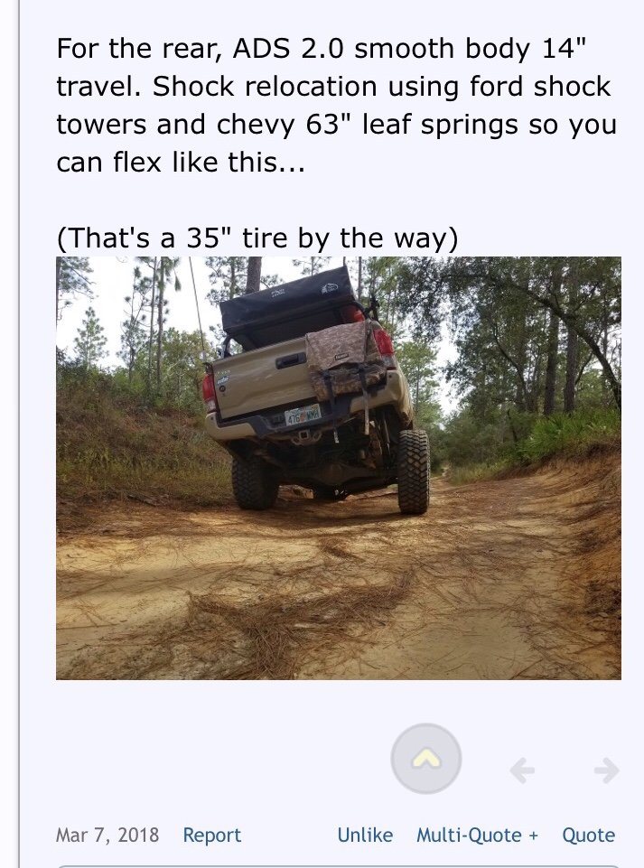

    My connection isn't letting me see the video but if you're looking for 6" springs and beefy what about 3" lift springs for a Chevy truck? I've converted two older Toyota's to Chevy springs and since they're so long the ride is amazing. I can't see 3 additional inches of arch ruining it that badly. Just throwing an idea out there.

    There is a member who did ford shock towers and chevy long travel leafs for his rear. I will see if i can find his thread. This would probably solve your issues and then some.
    Trident904 likes this.
