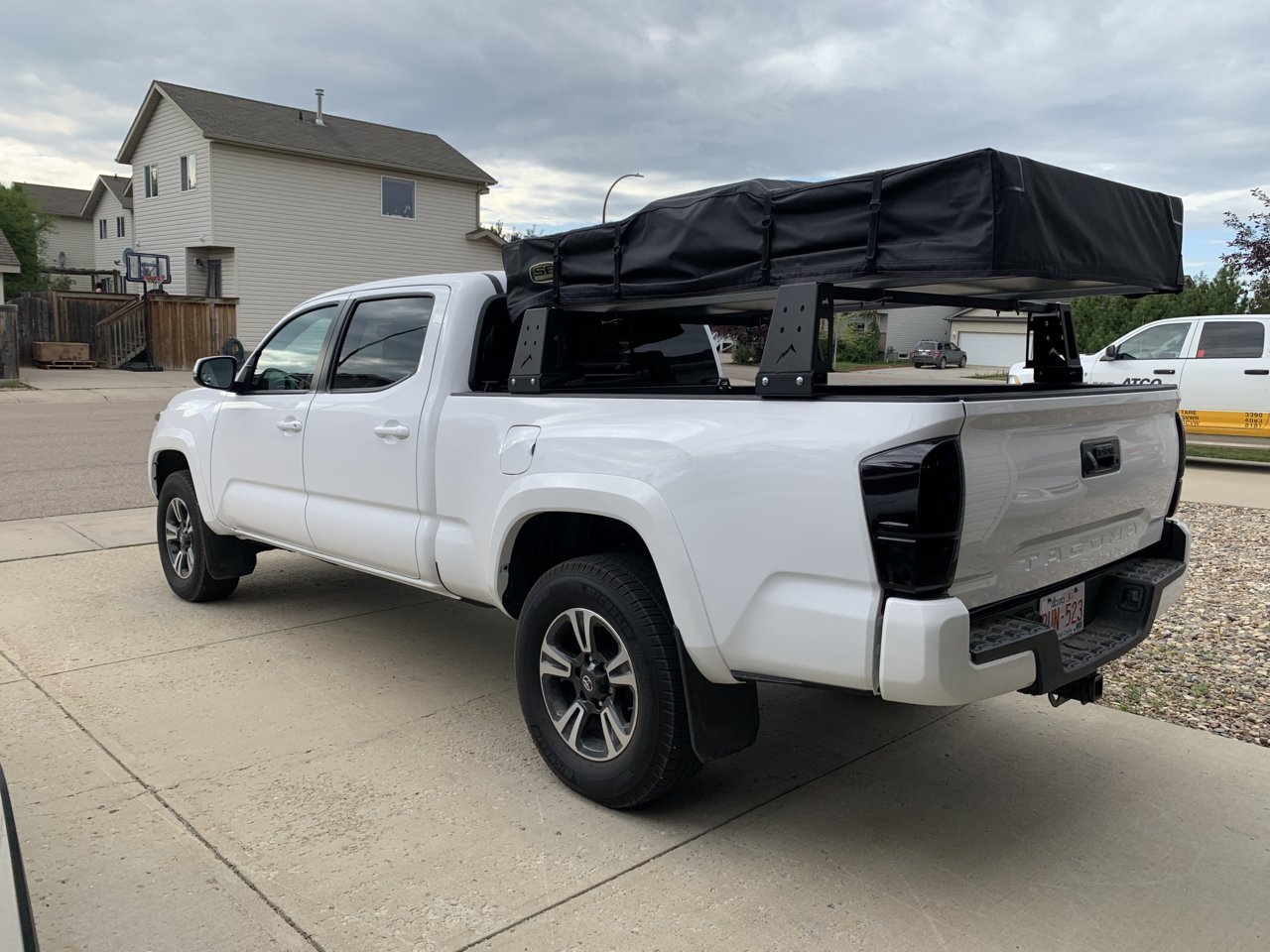

    Just put 200lbs in the box and remove sway bar. The hitachis suck but but now it rides way better 2A0A0CD3-A48E-4366-80E6-32F44A8F07C5.jpg
