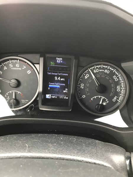

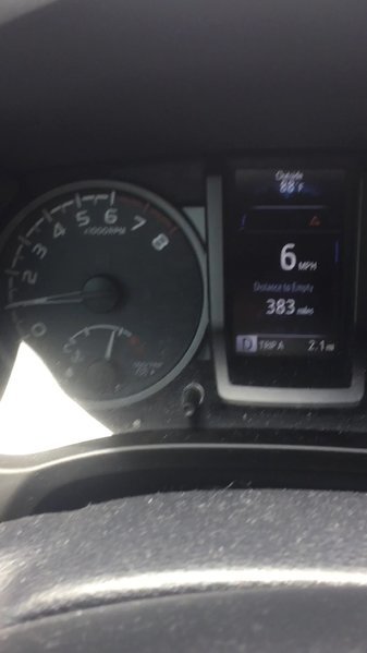

  3. Jun 5, 2017 at 6:31 AM
    #43
    Roadpirate
    Roadpirate Member
    May 13, 2017
    #218902
    7
    2017 magnetic gray trd off road
    Is this normal? Truck only has 350 miles this is 5 min of driving.

    What the normal temp reading or horrible gas mileage?
    9TRDTCO and smitty99 like this.
  5. Jun 5, 2017 at 6:42 AM
    #45
    Roadpirate
    Roadpirate Member
    May 13, 2017
    #218902
    7
    Both! But mostly the temperature gauge reading..

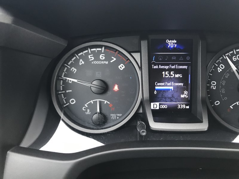

  18. Jun 5, 2017 at 11:28 AM
    #58
    bpx3075
    bpx3075 [OP] Active Member
    Oct 4, 2016
    #198916
    41
    2023 TRD OR Premium, 2017 TRD OR, 2012 TRD OR
    Its pretty weird that I posted this thread a while back and someone just added to it today while I was at a 2nd dealership for the same issue. The first dealership I went to back in March couldnt find anything, so the next time I saw it happen I got a few videos of it. When i went today to the 2nd dealership, they found nothing again, so I showed the tech the video and he brought the truck back into the bay. I went back there a few times to answer his questions, he found no TSB, thought it may have been the temp sensor since it was dirty. I think he ended up calling Toyota tech support and they figured out that it was the fan clutch. This makes sense seeing as I would sit idle somewhere and the AC would not stay cool, even if the truck wasnt heating up at the time. They gave me a rental and said the part will be in tomorrow. Im posting a pic of the gauge slowing moving to the right. Like @JayRolla said, if you see it going past the halfway point, blast the heat and get it to the dealership. edf3659c-19b8-4aad-9559-5698cff405ae.jpg
