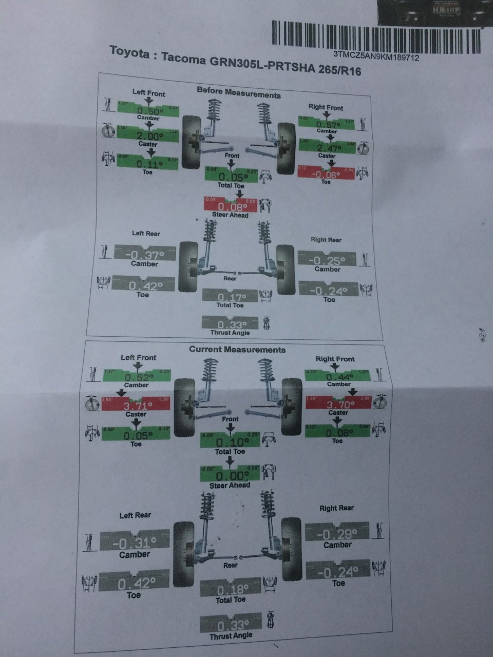

    Lol yeah maybe he put the leaf springs on the wrong side too.... on a serious note though the tires are right at a 33 and I agree with alignment being able to take care of a lot of things but some of my concerns I'm not sure about. Right now I'm on lunch driving on the interstate and at a higher rate of speed size 60 or 70 when I get a bump or dip I get a little bit of a hard hit in the front. You don't think I have those push too far out on the threads do you? I'll continue to report back with my feedback and solutions or issues. It seems to absorb a rough wavy Road well but hitting a hole or a bump is kind of jarring in the front, is that also something an alignment can help with? I just don't want to damage anything or mess anything up when it could have been prevented thanks for your help. Oh and one more thing when I take a curve like an exit ramp with a little more speed like a ylwide turn it seems to make a screeching noise and it actually sounds like it's the tires themselves. I'm just all to hell if you can't tell I expected to slap these Beauties on and just be smooth sailing from here LOL
  5. Mar 7, 2019 at 11:07 AM
    #1985
    Bastek
    Bastek Average Member
    Jun 6, 2017
    #220876
    4,304
    Seb
    SI NY
    '17 OR dcsb
    KDMaxP10, plastidip
    Tire squealing and some other stuff will go away with an alignment, that's a guarantee.
    Now, jarring and stuff might be attributed to heavy springs, and not enough weight (maybe). I have 650# springs on my truck, and might have to upgrade to 700 when bumper arrives, not before.
    So, not an expert advice, do the alignment and take it from there. You have too many things going on right now, where a lot of them , if not most will get corrected on Saturday.
    Good luck.

    Also, in my opinion it's a questionable practice at best, to drive a misaligned car/truck for prolonged periods of time, especially at high rates of speed. But I'm not an expert, so take it with a grain of salt.
    One more thing about the tires, they're new, right? What pressure are you running them? Too high of a pressure will make ride less comfortable, and will add to tire squeal.

    What’s the load rating on your tires? That was the biggest thing when it came to feeling the road a little more than I would like. I had both C and E rated on KO2s and will say it’s night and day. I’m currently on E and I feel more than I would like to. Will be switching back to C later down the road since I don’t want to burn all my money all the time. Also like others said, 700 is stiffer and you need quite a bit of weight to counterbalance it. I have a front skid, sliders, front steel bumper and winch on 600s and it feels pretty good. Height sagged though and now I’m back down to only a little over 1” lift on 8-9 threads. I’ll be turning it back up another 4 threads and see how it goes before even thinking of going higher on the springs.

    Awesome you have been more than helpful!?I'll get the measurements tomorrow tho? Thanks for the advice!I think my guy is good with alignment, he said he doesn't want me taking it anywhere else bc its not an hour hibb and will take some time.He will definitely have to get the driver side uca pushed forward towards the front, but I do agree and think that even a lot of the rubbing can be worked out with a good accurate alignment!!I'll definitely let you know and get a report on my settings when done .

    Got it. I've made a wrong assumption, and I shouldn't have. My bad.
    700# springs are a right choice for your setup. As will be for me, whenever my bumper will show up....
    Non the less, I'm all out of guesses for your issues. Hopefully there will be some improvements on Saturday.

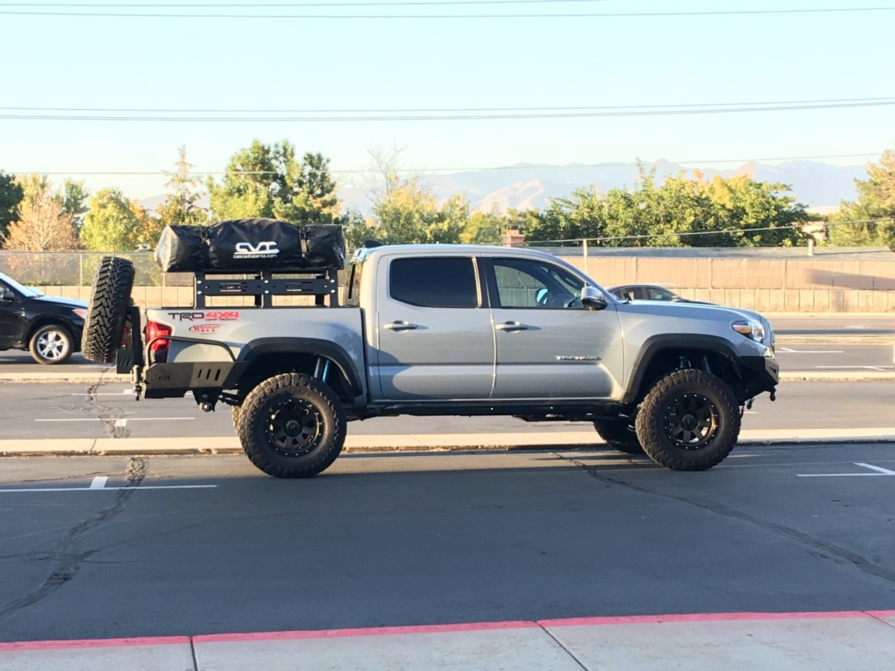

    @state48overland, this build looks similar to what I have and you seem to know what's going on, so I have a questions maybe you could give some insight.
    My suspension includes the following.
    Front: King 25001-119A-EXT, Total Chaos Uni-ball UCA's, 700# Coils, Total Chaos Weld-On Spindle Gussets
    Rear: King PR2510-SSPB-A, Total Chaos Rear Shock Hoop Kit, King 2.0 X 4.0 Bump Stops, Total Chaos Rear Bump Stop Kit, Deaver U402 Expedition II Leaf Pack
    I have a steel plated front bumper with a winch, a steel plated rear bumper w/ swing out, tire carrier and two gas cans. And an aluminum bed rack with a RTT. Long story short, a lot of added weight. The ass end of my truck has started to sag a bit since the Deaver's have settled. Also, with all the added weight on the end of the bed, when measured from the front of the bed to the back it has dropped about an inch.
    Question. Should I upgrade to the Expedition III's or lower the preload on my coilovers? What is the trade off? The truck rides reasonably well as a DD at it's current setting. If I go up to the III's, does that create other issues besides just riding stiffer? Could the rear shocks even handle it, if they have to extend another inch or two? Would adding the III's help with the added weight on the back of the truck? If I lower the preload, does that limit my up travel?
    I've included a pic so you can get a fill for the current set up. This picture was taken soon after install, so it sits pretty level. It currently drops 1" from the front to back, when loaded with gear it drops another 1".

    Thanks for reaching out man! I am not an expert by any means here and hope I don't come off like one. But here is my assessment. You have leverage weight vs. spring sag imho. Kind of like tongue weight from a trailer effect because the weight extends past the rear bumper. While I would like to say yeah buddy, order the Expo III pack we got you covered the reality is you can likely mitigate the leverage 'sag' by going directly to Deaver (not possible since you live in SLC not SoCal) re-arch the springs and have them dial you in for less than the cost of a new leaf pack or simply call Scott over there at 714-542-3703.
    The recommendation may be a longer leaf replacement below and a smaller above to disburse load more evenly in the pack. You will gain the inch back through leaf thickness, weight load leveling and arch/rate of the actual leaf/leaves. Of course a longer center pin and retainer clips may be needed. But this may come out less expensive than a full leaf pack replacement.
    I think your rear shock will be just fine -they are 10" stroke shocks and have plenty of room to move in that leaf pack.
    I run a similar relo in my gen 2 granted I run Deaver SUAs. Your front settings will be fine after you sort the rear pack which is what I would definitely focus on, given the weight you run back there.
