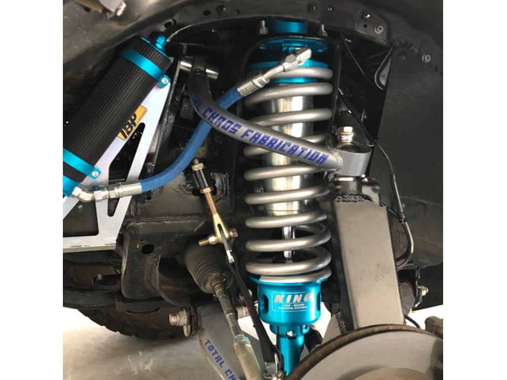

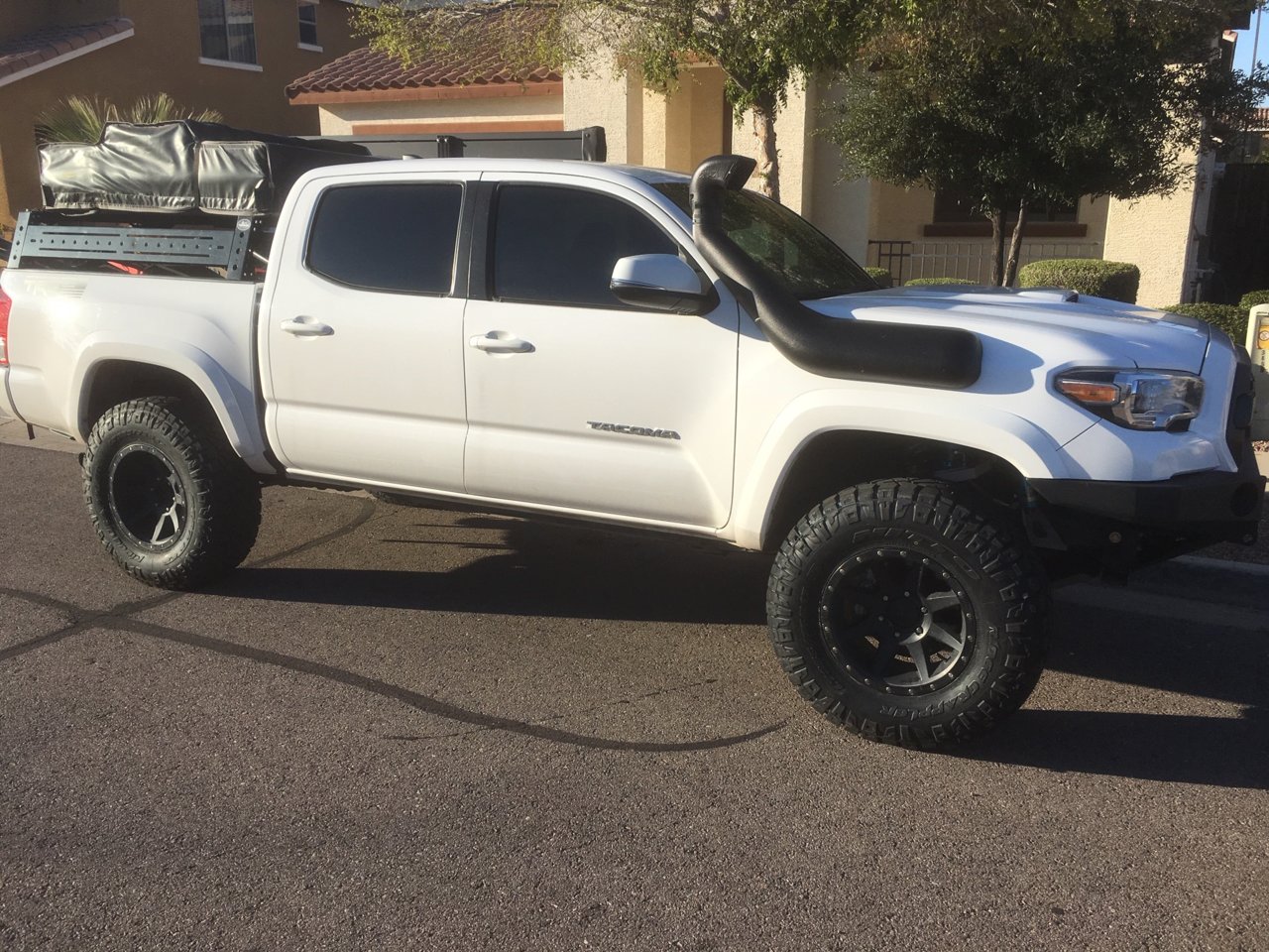

    Long Travel Build: 2011 DCSB 4WD Total Chaos (+2 long travel, heimed uca, race lca, front shock hoop, rear shock relocation hoop with sua kit, spindle and coil bucket gusseted, bed stiffeners), 34"s Nitto Ridge Grapp's, SCS SR8 gun metal, Pelfrey (front/rear/4 skid plates-exhaust re-route, sliders), Rigid LED, Kings (coilovers, triple bypass front, piggy back double bypass rear, hydro-bumps), Superbumps (front), Deaver(sua pack), Harrop rear locker, 4.56 Nitros, Single piece double cardan driveshaft, VLEDs DRLs, GTR 3 LED headlights, Diff breather/relocation x 3, pinch weld, cmc, AGM battery, Bulldog winch (synthetic rope) 9500lb, ext. stainless brake lines, Fumoto, Factor55 flatlink, YWM, fog light mod, LED conversion interior/exterior, de-badged, all 4 stock fenders and flares trimmed 2.5", Safari snorkel, anytime rear camera mod, exhaust chop, spare tire mount chop to fit 34", strapped at all 4 corners.. Mid-Travel build: 2017 DCSB 4WD 34"s BFG KO2, SCS Ray 10s matte black, Diff breather/relocation x 3, sPOD dual Bantam set up, Prinsu, Diamondback, Pelfrey (front, rear, skids, gas, exhaust re route), Sliders, Baja Designs(30" Onx 6 HP, 2 x 30" S8, XL80s, Squadron Sports, S2s x 6), Kings (3.0 IBP fronts, 3.0 double bypass rear, hydro bumps), Eibach 16" x 650lb coilover spring swap, ICON RXT leaf pack-set @ option 2, Total Chaos (Stock length heimed uca & lca, strapped front, sway bar delete, spindle and coil bucket gussets), ext. stainless brake lines, EXE TPAM, EXE bedside compressor mount, AGM-group 31-Pelfrey battery cage, pinch weld, cmc, Factor55 flatlink, X2O 10,000lb winch(synthetic rope), LED conversion interior/exterior, Superbumps, Nitro 4.88s, exhaust chop, spare tire mount chop to fit 34". Mid-Travel build: 2007 FJ Cruiser 35" Nitto Ridge Grapps. SCS SR8 matte black, Demello flat front bumper steel, Expedition One Rear gate/bumper, cmc, pinch welds, fender flare delete, ICON coilovers w/remote resi and rear, Metal Tech LT LCA rears, 12,500lb winch + synthetic rope, Factor55 thimble, full belly/gas tank steel skid plates, Rigid leds, full interior and exterior led upgrade, led flasher upgrade, Total Chaos (UCA, spindle gussets), frame gussets, rear sway bar delete, 4.88 Nitro gears, Diff breather/relocation x 3, Fumoto, exhaust chop,
    That's a dilemma then.
    You'd have to squeeze about 3 1/4" - 3 1/2" out of those shocks-not really what they are made for at that point, quality of ride would suffer with possible coil bind on compression. Depending on wheel backspacing and other variables (alignment) - inner fender massaging may be necessary, so it doesn't act as your new bump stop when tires get stuffed.
    Here's a pic I posted earlier. Just under 3" of lift. With 34's. Not a lot of room left -but suspension is riding as intended even though on its upper limits.[​IMG]
