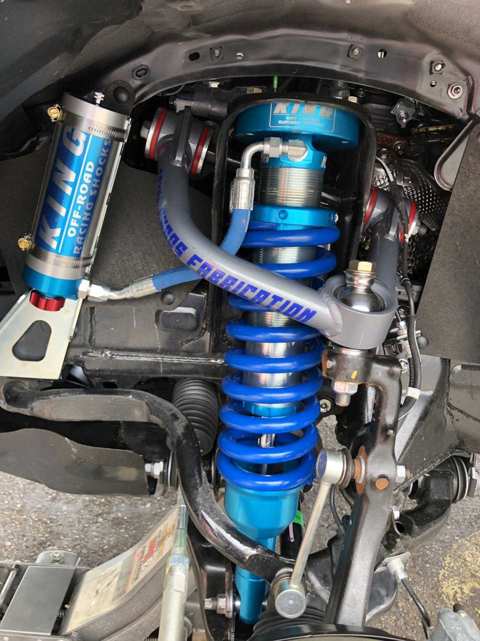

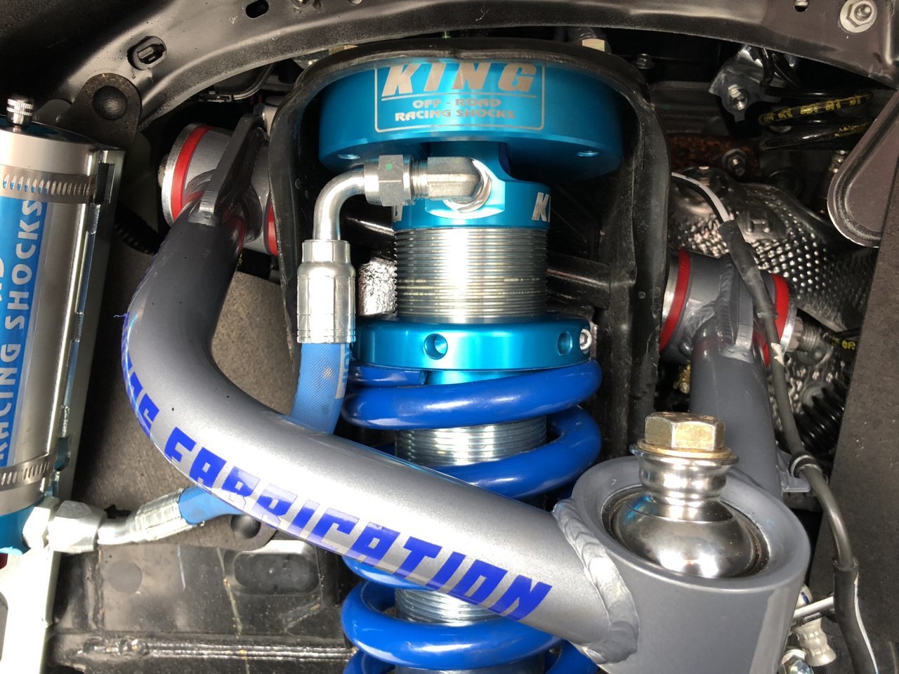

    The nice part is that you have 600lb springs. You should have the adjuster tool/pin. It should be very easy to turn and make adjustments. Just make sure you have tires off the ground. Then spin the collar. I would install it first. Do a couple hard brakes. Settle the spring in. Then measure to see what you have. You’ll get close to an inch of lift with about 4-5 full turns. Use that as your guide.

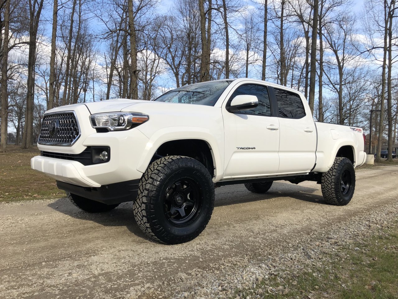

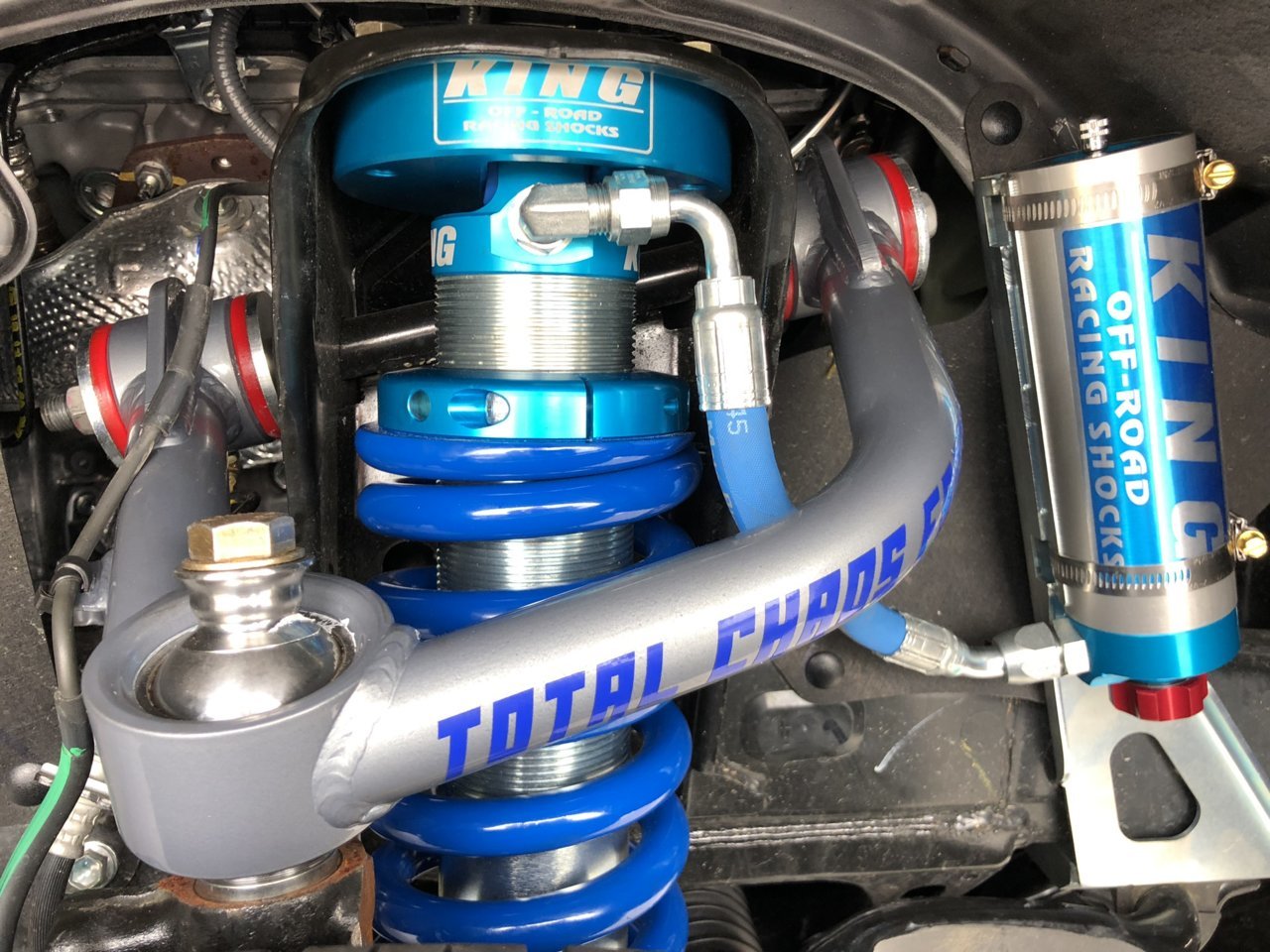

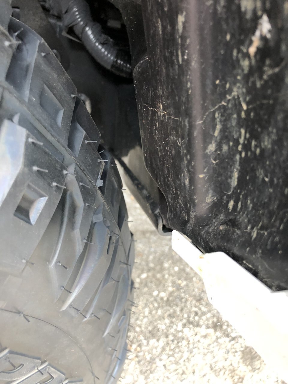

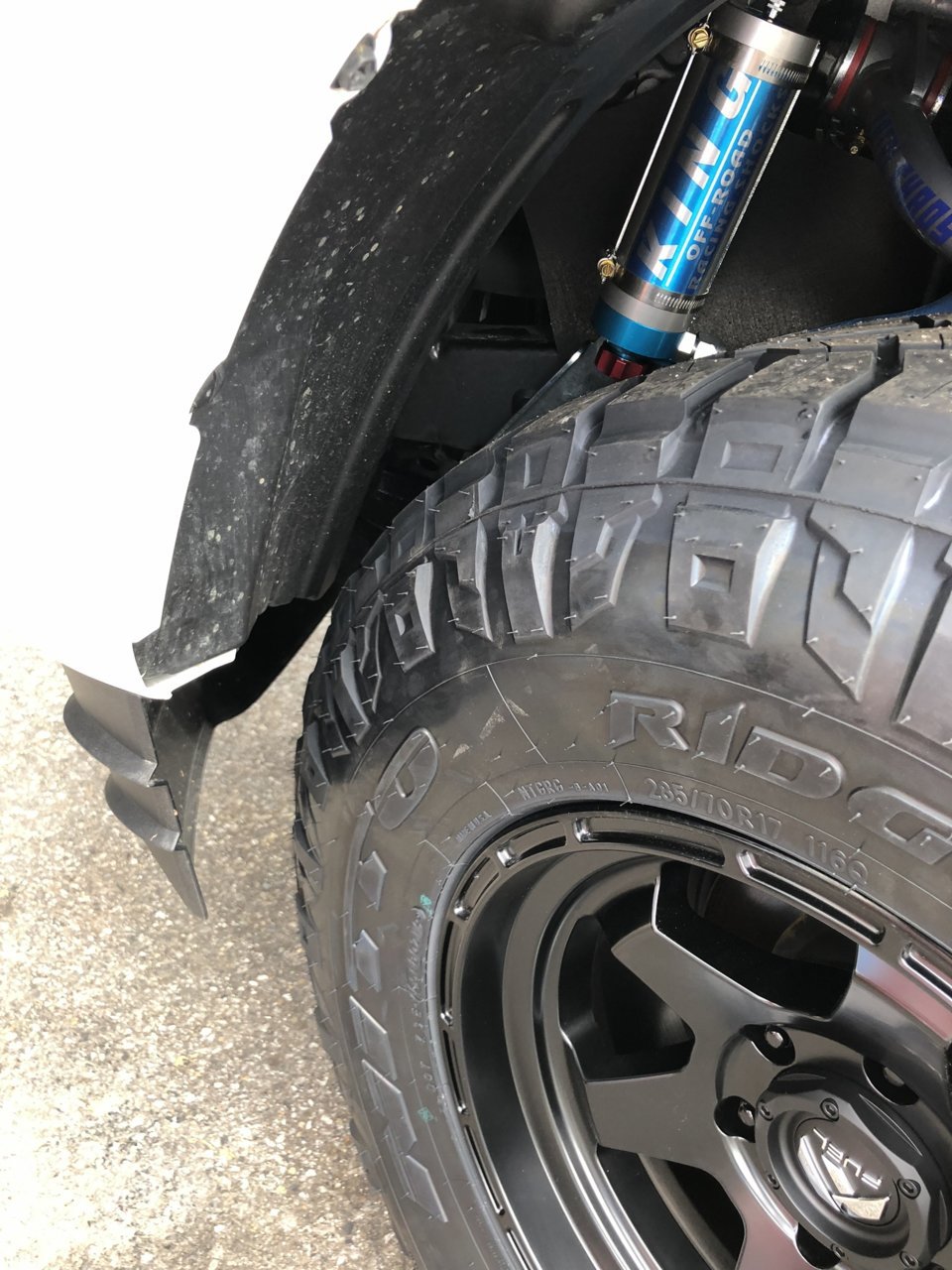

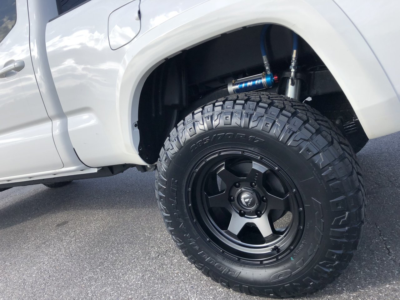

    Hey guys! I've followed this thread before, and even used some of the posts for help in getting this kit we just installed on this 2018 Tacoma so I figured I'd return the favor and post what we ended up with!
    2018 Tacoma TRD 4x4
    Here's what we installed:
    King Suspension 2.5 w/resi and 600 lb springs
    Total Chaos UCA's
    Toytec AAL in rear with axle shims
    Left stock overload in place
    Diff Drop
    17x9 Fuel Shok +1 offset
    285/70r17 Nitto Ridge Grappler
    Ended up cranking the driver side to 12 threads showing and 10 for passenger side. Ended up with 2.75" of lift front and rear. 25" hub to fender on rear and a hair over 24" on front after lift.
    Didn't have any rubbing. No trimming on plastic. No cutting on body mount.
    HoboInNV, stiles88, Mack411 and 2 others like this.

    Those numbers seem really high compared to most. What were your hub-to-fender measurements prior to the install? Did you measure from the center of the hub?
    Truck looks great btw! Thank you for the info.
  9. Mar 14, 2019 at 2:42 PM
    #2049
    dbracer14
    dbracer14 Member
    Dec 21, 2015
    #172769
    12
    Dustin
    Thanks! Not my truck, just one I built for a guy, but hopefully I'll end up with something similar soon. Closer to 21" and 22" originally is what I was measuring. A good full 2.75" of lift.

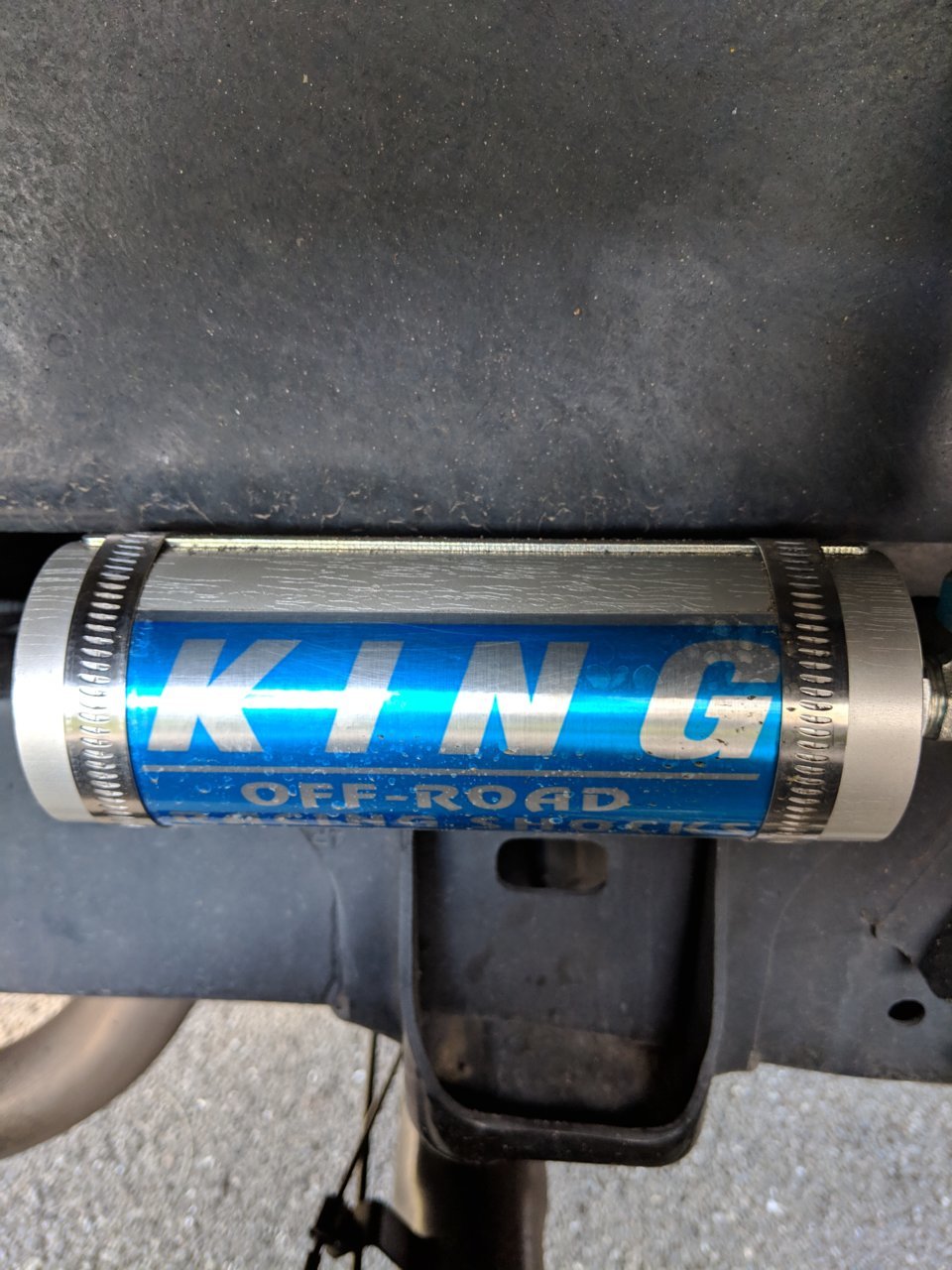

    So, I was chasing a new knock and a weird noise, found what looks like sway bar rubbing against pass side reservoir bracket, and came across this!

    I don't know, they're not even one year old, and they're are not supposed to be weeping Icons Kings!
    Driver side is completely dry, so I have that going for me! Lol
    As for sway bar, I'll have to check /re-torque whichever bolts necessary

    Are you sure it’s just not grime? I get it all the time. Wipe it with a damp cloth and see if it goes away and there’s no “oil” wetness. Do you have a pic of the sway bar part? Sway bar is supposed to be lower and out of the way from the reservoir bracket unless you mean it’s mounted to the bracket and is rubbing a weird way
