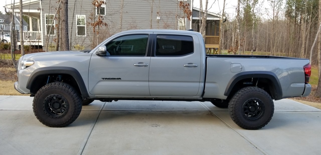

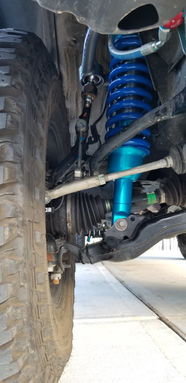

    I feel much better after re-checking everything. It looks like I ended up with just a hair under +2.5" up front and +2" in the rear. That'll work for now. :headbang:
    More +2.5" porn:

    Seems like the rear is too low. That’s RXT option 1?

    The 2" I gained in the rear is actually higher than expected for Option 1. The expected increase for Option 1 while completely unloaded is just 1.875".
    I think the picture may be a little deceiving. There is still a small amount of rake when the truck is on flat ground, and the rear fenders are roughly 1.75" higher than the front fenders when measured from the ground.
