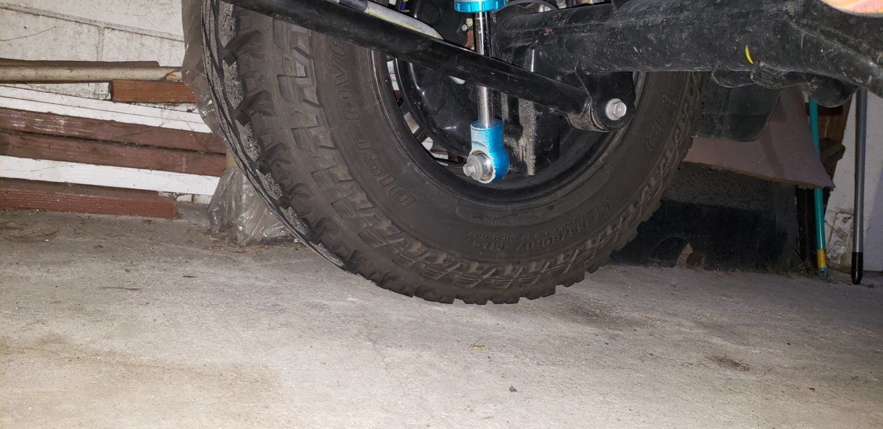

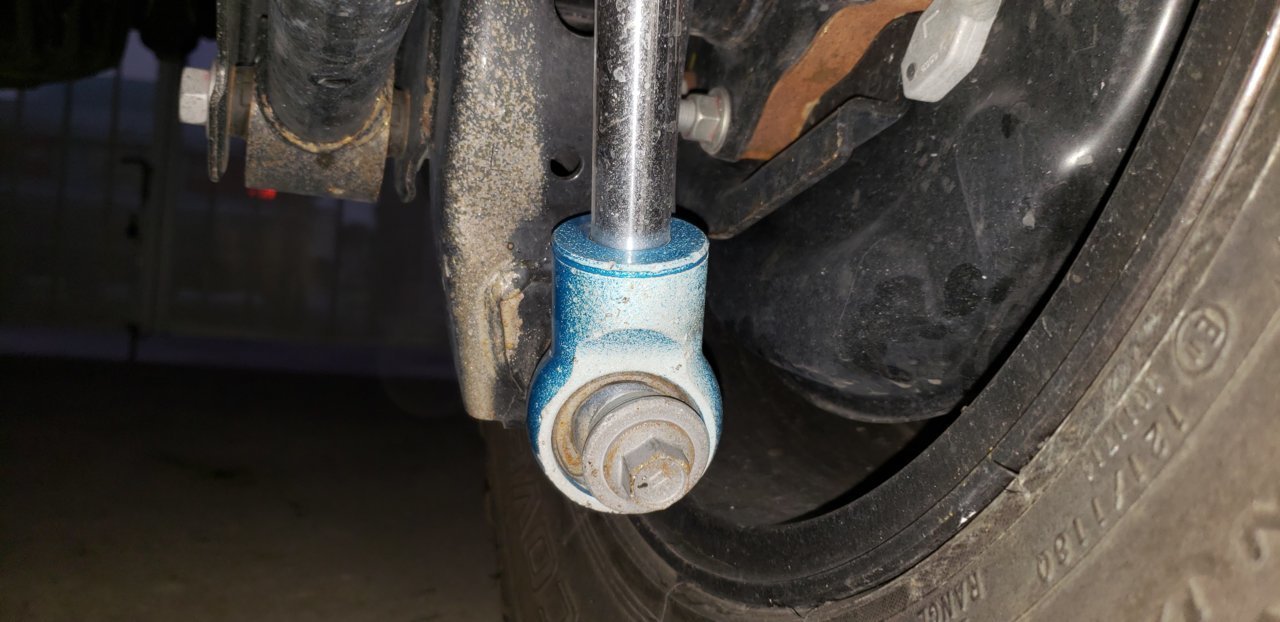

    I'm getting there. Lol. But wtf with these new shocks. Don't want there to be issues before I put them to use.

    You'll be fine, I have King shocks on both my Tacoma and 4Runner. Both don't have any issues.
