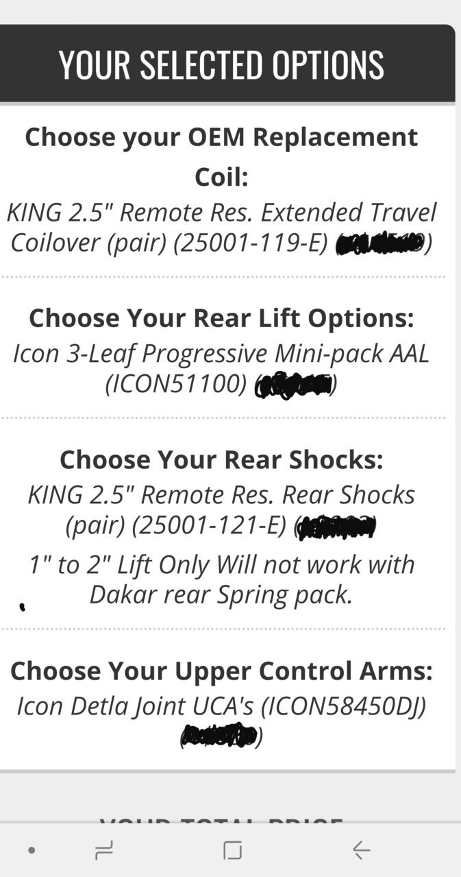

    I have a 2017 TRD OR 4x4. This is the kit I'm looking to get for 2.75-3". How does it look? Any thing else I should know? No extra weight other than sliders. Probably going to get aluminum front and rear bumpers (winch) eventually but not for awhile. So I was going with the 600 springs and if I need to go to 650 or 700 down the line I will. I was confused on what leaf pack I should get or if I need anything. Or If there is something different you would recommend let me know. I use the truck for work so no plans on tent or alot of weight in back like a full overland build (I need an open bed). What about ext travel for the rear? I have decided against the compression adjusters because from everything I have read I probably won't use it alot but let me know what you think

    I was told to get extended if I planned on Dakar pack later. 3-aal is what I'm currently running with ext rears and it's fine. The shocks are longer and you'll probably have to disconnect your u-bolts to install them unless you're strong enough to compress them while slipping them in at the same time.

    The ride is rlly great off toad with the 650s I’m running pretty high lift too so I have about 11 threads driver and 8 passenger

    You're going to want to change your rears go extended for that much lift

    Ok thanks what would you recommend for the rear aal
