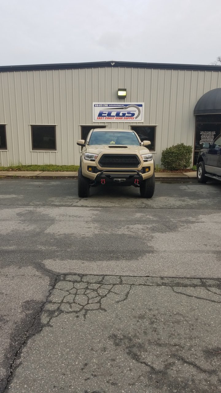

  3. Mar 26, 2019 at 11:26 AM
    #2183
    Mack411
    Mack411 Well-Known Member
    Jan 10, 2018
    #240863
    850
    2017 Quicksand Tacoma Trd-OR
    I honestly couldn't tell you, I was having mine regeared so it obviously made sense to let them do it.I actually just picked it up, feels smooth and good although I'm babying it around quite a bit. I'm not 100% sure but it almost seems like there is a light whine that sounds like it's from the rear end area.I wonder if driveshaft angles can cause something like this?I still have to make adjustments to my fronts and then see if I'm going to try some shims to get my angles better. Im going to go put a few highway miles in this evening bc if there did happen to be something that needs their attention I want it caught while I'm here and not 5 hours away at home.
    Bastek and paleh0rse[QUOTED] like this.
