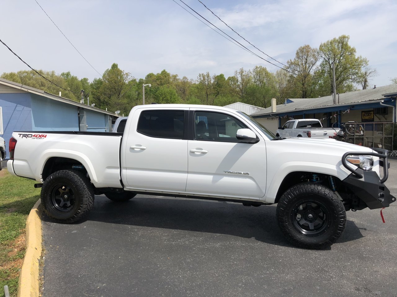

    Just upgraded our customer to a FabFours Premium bumper with full grill guard. It came with LED fogs and turn signals made into the bumpers. This thing was heavy! We previously had installed the King front and rear with adjusters with standard 600lb spring, Toytec AAL in rear, Total Chaos UCA's set at 13 threads driver and 11 passenger and was at 24" hub to fender front and 25" rear.
    When the bumper was ordered we also ordered new 650lb springs. We installed them and lowered preload to 7 threads driver and 5 passenger. With the bumper installed we ended up at 23" front hub to fender and still 25" rear. He is going to add a Leer topper and some gear in the rear so we will see how it sits after that before making final adjustments.
    One thing to note, with the 24" hub to fender setup and our 17x9 +1 offset with 285/70r17 Ridge Grapplers it barely cleared the body mount on both sides. At 23" now it rubs the passenger side body mount when in reverse and turning right. Drivers side does not rub.
    This truck has a cruise and pedestrian radar in the Toyota grill emblem. There is a little yellow light on the dash that stays illuminated letting you know that the radar isn't active. It's not as bright or annoying as a TPMS light, I barely noticed it. Nothing comes across the display after driving it for 30 miles or so, but if you activate cruise it will let you know that the radar isn't active and needs to be cleaned. Cruise won't activate that way. You can hold the cruise down for 2 seconds and that activates standard cruise control without the radar and that avoids having any errors pop up and cruise works fine, just without radar.

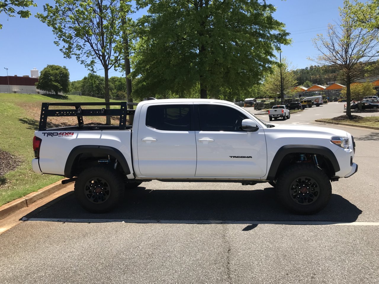

    This thread was incredibly useful for helping me make this purchase. Hopefully my results will help others too.
    JBA UCA’s
    King 650lb EXT w/o adjusters in front
    King standard w/adjusters in rear +2” AAL
    Without making any adjustments the shocks lifted the front 1-3/4”. I turned the collar 1 and a half turns to bring the front up to a total of 2”. Results with 1-1/4” rake.

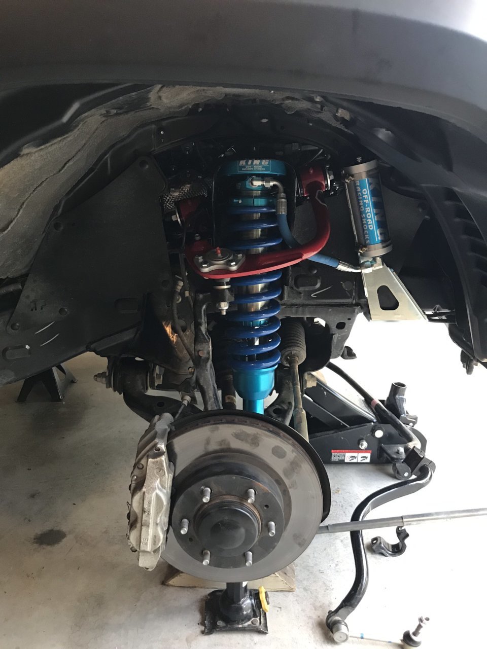

    Got the replacements in and installed. Went from standard Kings with 600# springs:
    To extended travel with 700#
    Smooth as silk across Omaha streets, and have me 2”. I am gonna mess around a bit, but I plan on dropping the front a little bit to give me a little bit of rake after everything settles in. Thanks everyone for pointing out what had gone wrong and helping me narrow down the problem.

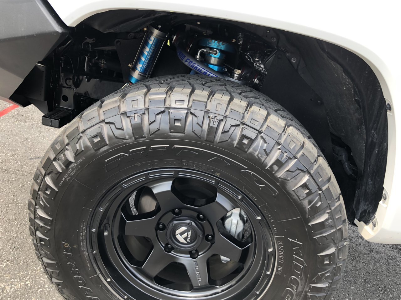

    Lift and cap so far...
    I have the LSK boxed ones, they're pretty sweet! Had a bit of rub on the hose on drivers side but I think I fixed it
