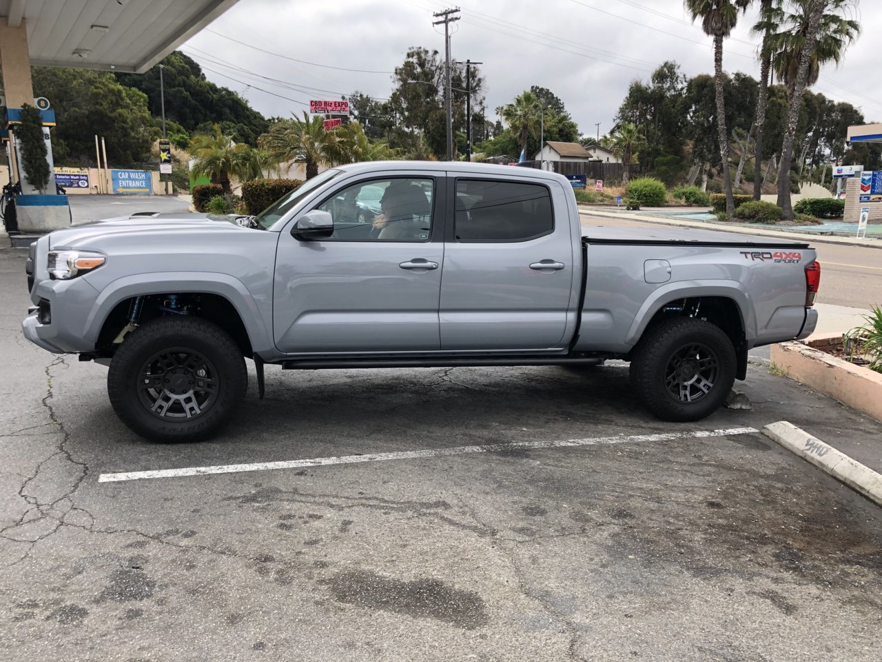

    I'm showing five threads and am very close to level with med duty Dakars.

    This is my stance with five threads.ACB17AD1-A54C-4BC8-A5BE-EEBCA804A123.jpg

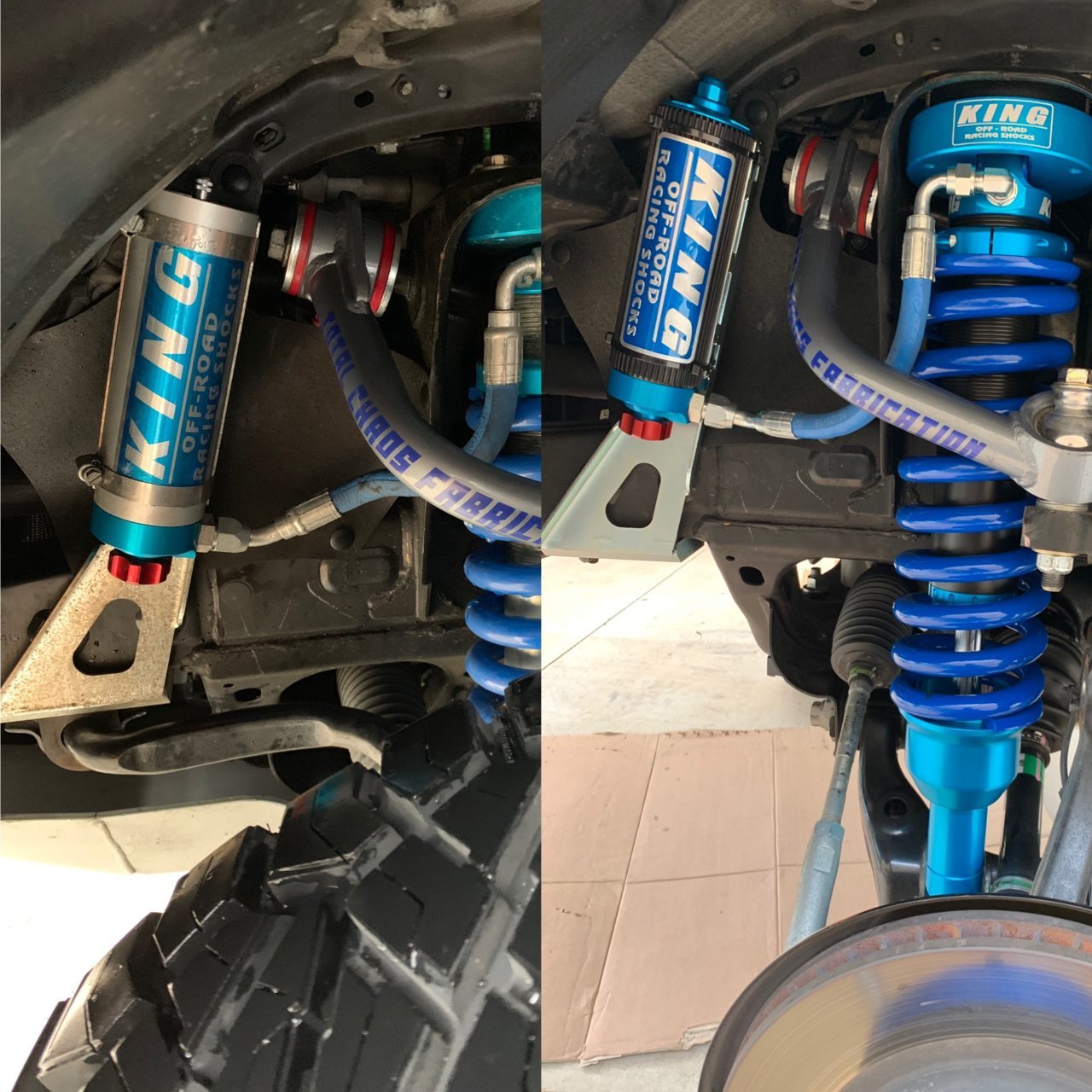

    Lift and cap so far...
    Thats what I did and got pretty much exactly 2.5 inches above stock. Be sure to use lube on the threads if you aren't using a compressor
    Pretty good. Not exactly a cloud on road as some say, but nice. You will have firmer tires which you will notice and there is more bump steer than stock. The shocks are definitely made for off road at speed, which is where they really shine. The springs also take weeks to really break in to the point that they are cush. I usually run them pretty close to full soft on road and pretty stiff off road or for extended highway cruising (Colorado has some tight corners on the highways)

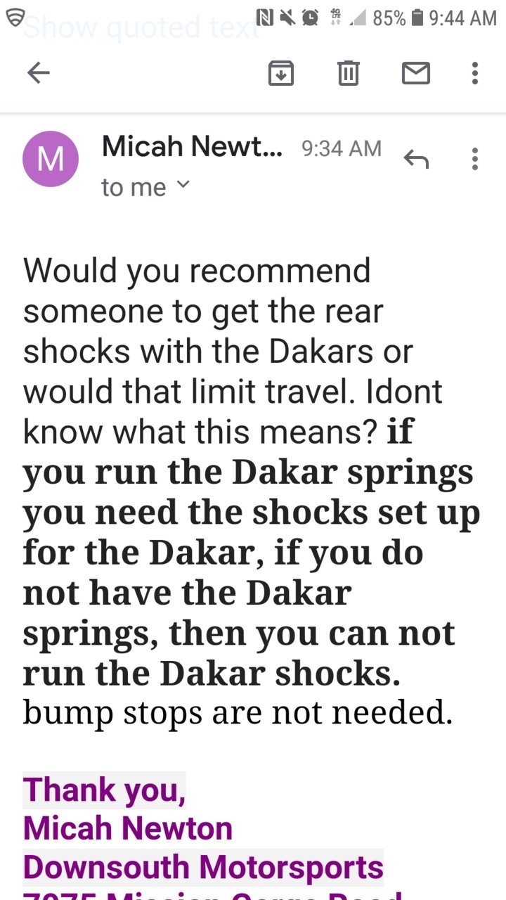

    Hey guys so im having a small dilemma on what to get. So i talked to Micah from D S M but i want to hear from your guys experience with the dakars.
    should i get dakars or another type of leafs. What would you guys recommend?
    This has to do with the stack height of the Dakar pack (they are tall) which requires a longer shock

    Kings 2.5 lift kit
    @Funzy I would rather stick with the standard king shock. Do know what other set of leafs would pair good with the kings standard rear shocks?
