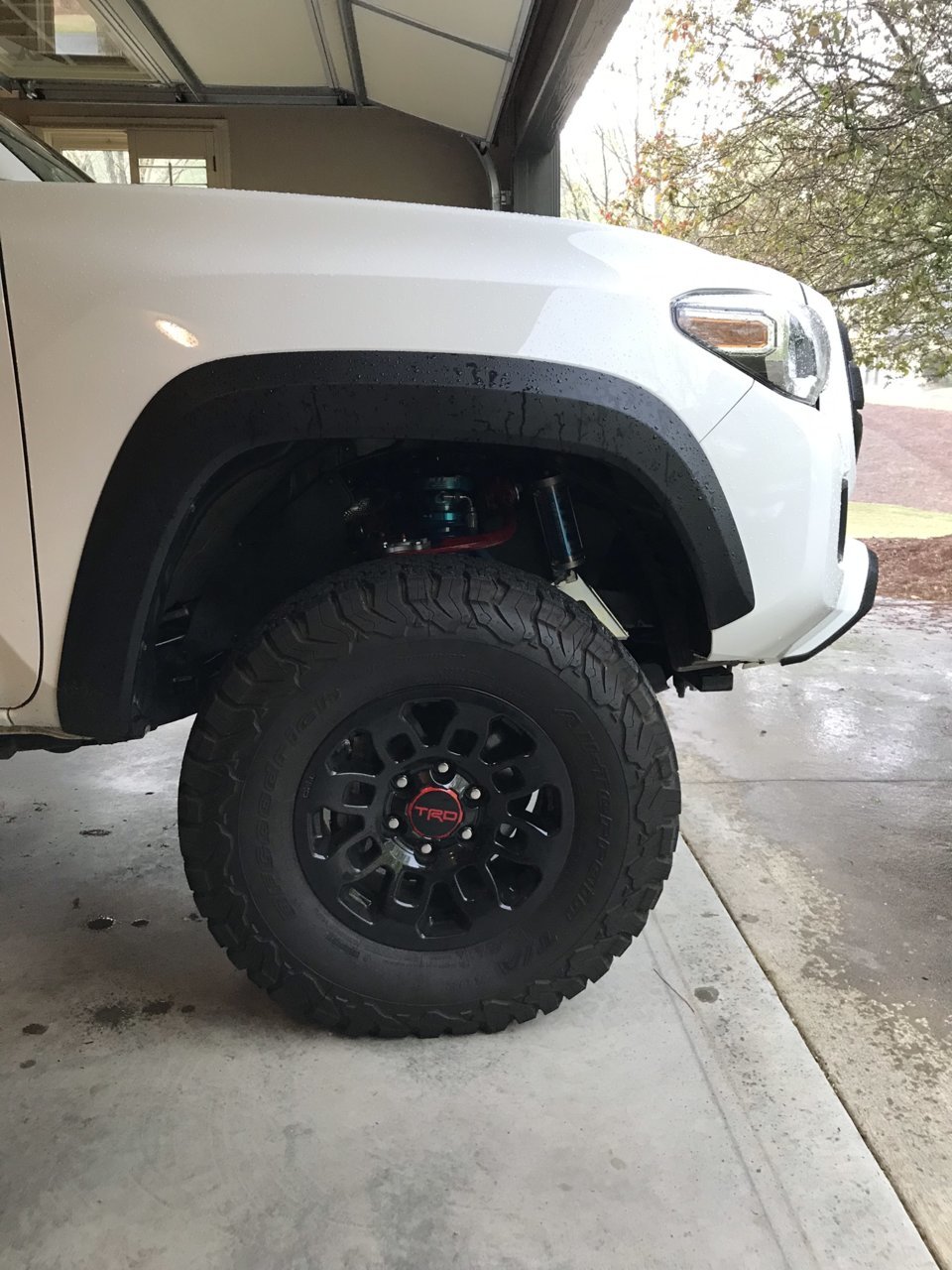

    Thought I’d post a quick follow up. 4K miles on the suspension with 1,000 off road. I feel like the suspension truly settled after 1K miles. The truck has a 2” total lift with 1-1/4” rake. EXT 650lbs up front/non extended adjustable in the rear.
    Ride has completely changed the way I drive the truck. Much more responsive and sporty on road and much more compliant off road especially when any type of speed is induced.
    PipsTaco, Siopao, JAStaco and 7 others like this.
