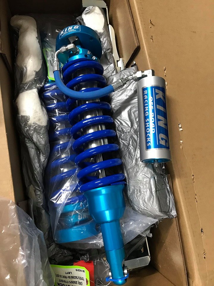

    Gonna try and go from 285 to 295/70/17’s and slap these things on it next Monday..

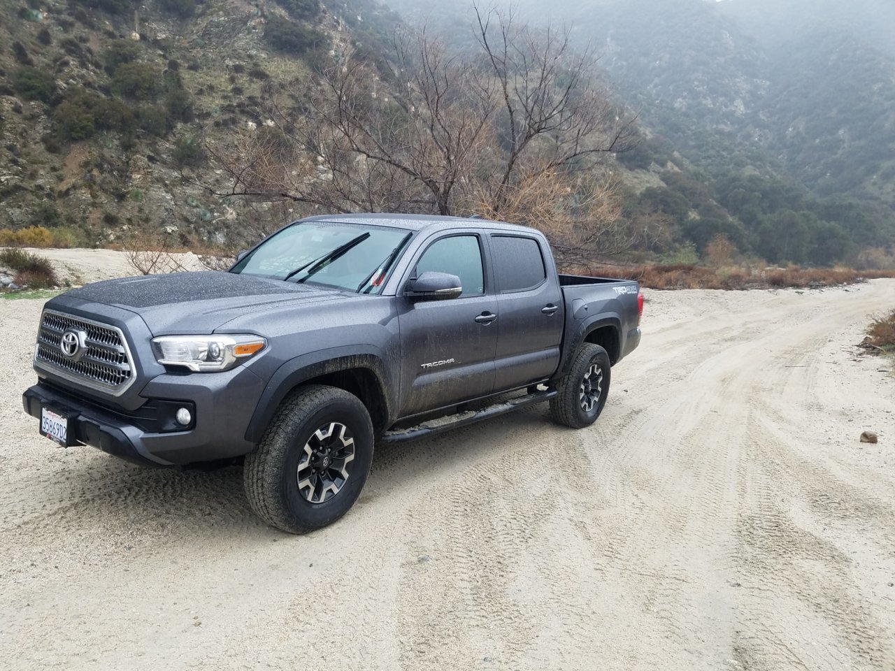

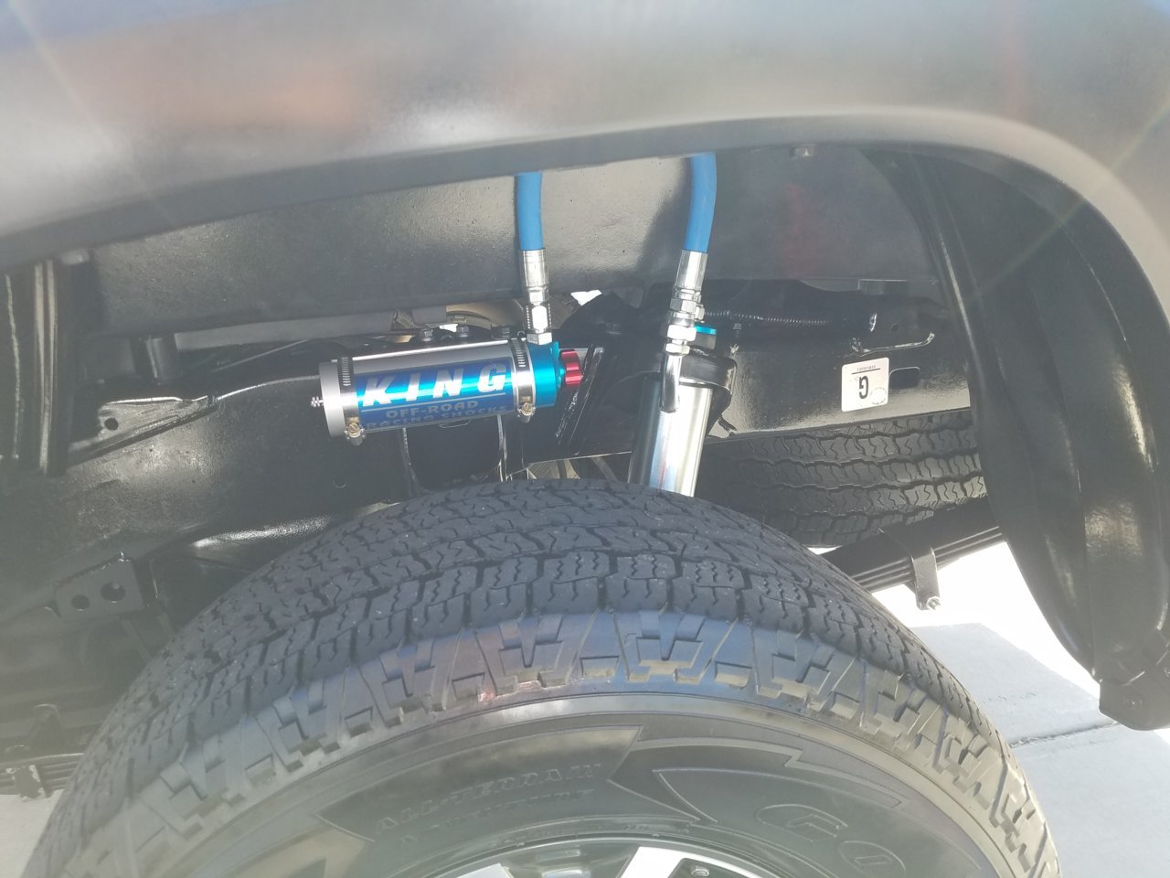

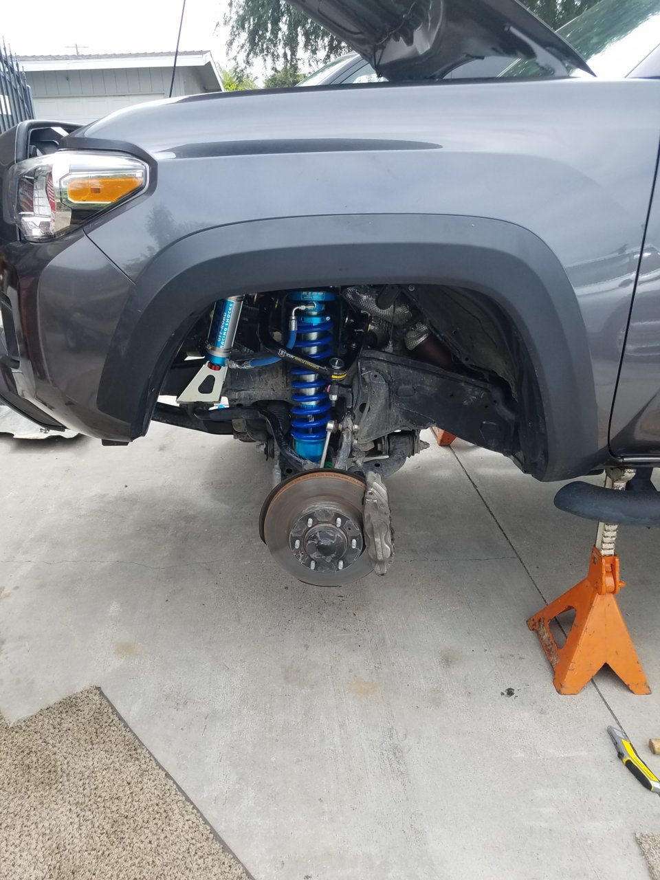

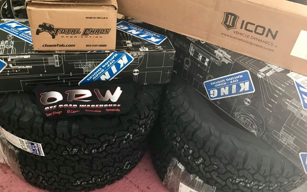

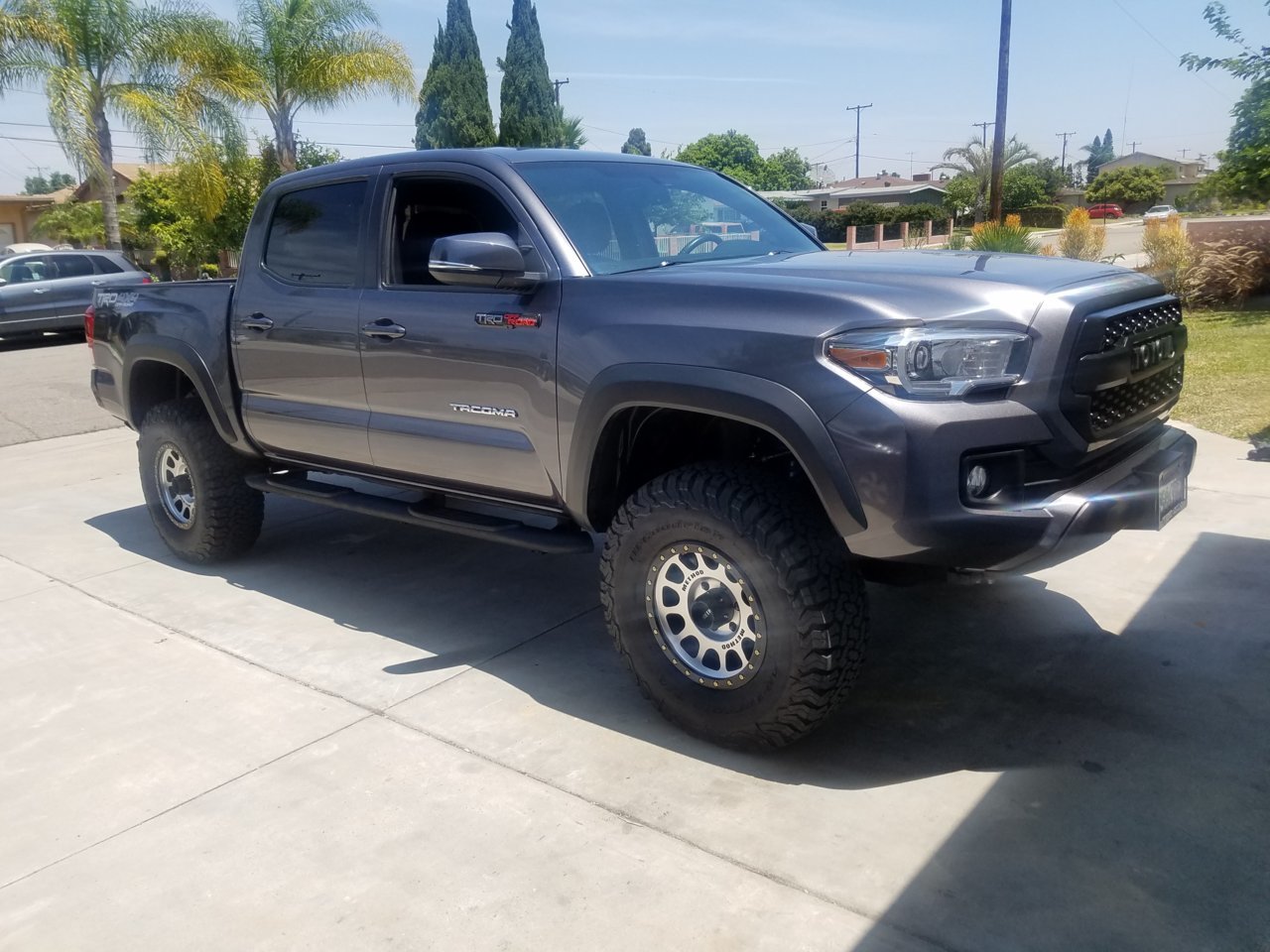

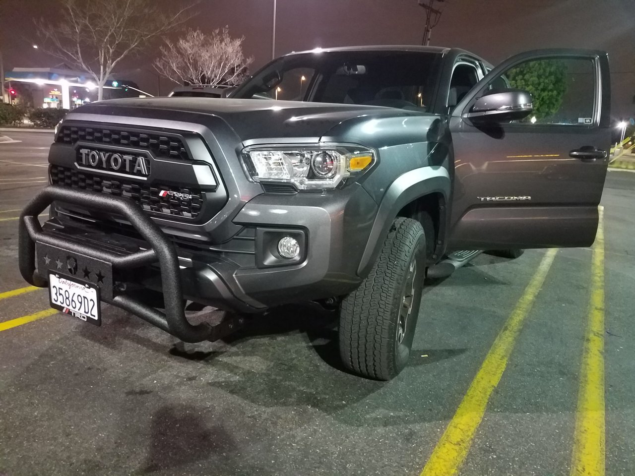

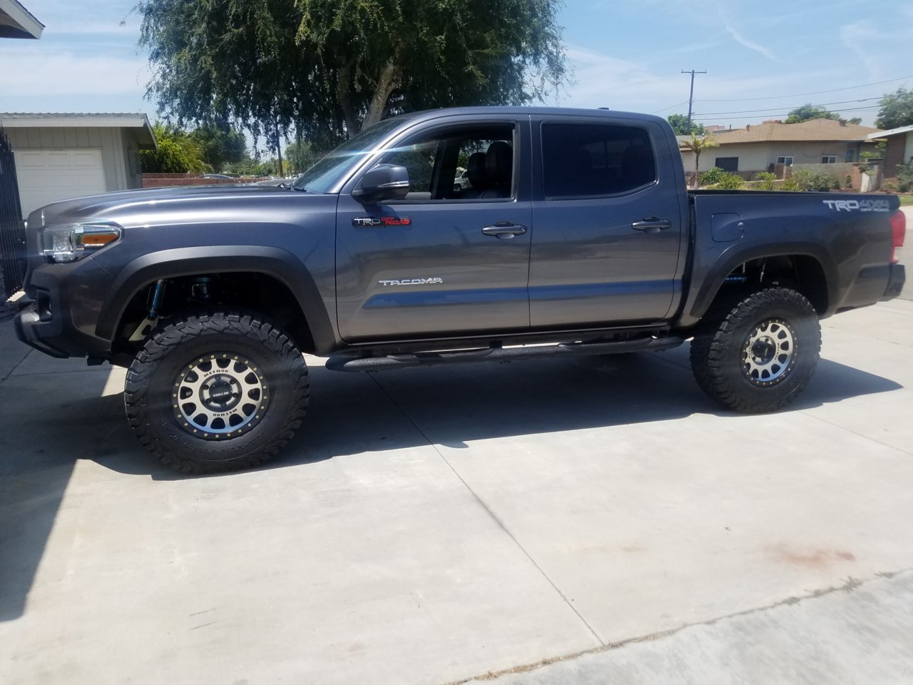

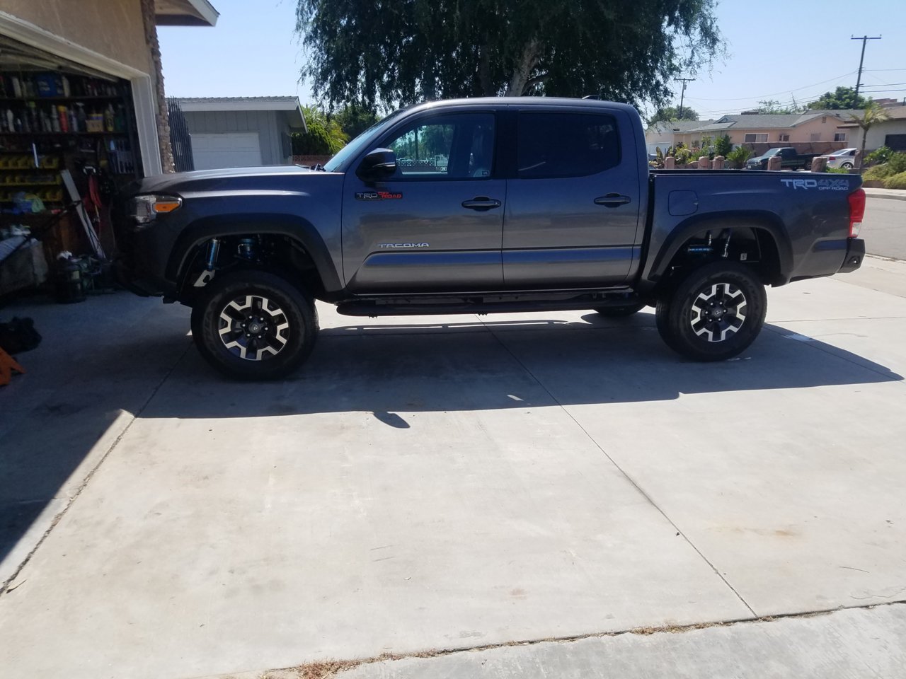

    Here she is! I am loving the setup so far!

    hell yeah! looks fantastic. i'm running the same SCS's on mine.....after I regear, im going to upgrade from my 5100/5160's to Kings and swap the JBA's for some adjustable SPC's (future proofing for these 35's). Awesome photos bro!
