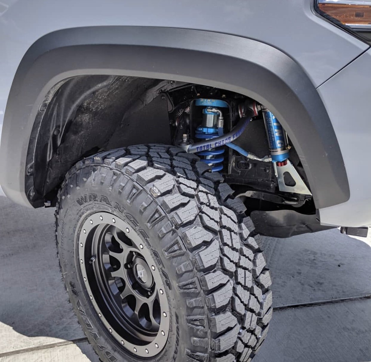

    2DEB5B05-3338-4C59-9969-A2DAF2A9252B.jpg Just got my truck back from
    600LB coils, nothing on the front (planning for new skids, sliders and eventually a bumper), but I feel like this is too much of a pre load, opinions?

    How much lift do you have. That's quite a few threads showing. I have 11 passengers and 12 drivers with just under 2.5 lift with same setup.
