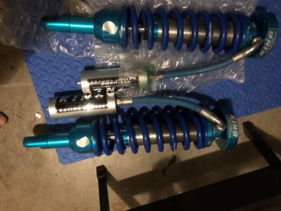

    Okay SO to all you informed people out there, I just bought some used King 2.5 w/ Non adjustable Resis, for anyone who bought new did they come with the misalignment spacers for the lower mount? do they need them? it looks like the previous owner did not have them and the sway bar just rubbed the bottom of the shock. upload_2019-7-20_13-16-21.jpg

    I'm not sure what you mean by spacers, but you should have gotten a mounting bracket for your reservoirs that also acts as a sway bar relocation bracket.

    So I looked around and they’re called misalignment spacers. They’re for the actual mounting eye of the bottom of the C/O, usually they come zip tied and pushed/pressed into the bottom bearing. Just hoping someone has a close up of them and if it’s two per or one or :confused:

    No pictures of them but they are two pieces. The longer end faces toward the front of the truck.
    Looks like these are the old style Kings, not sure if the mounting hardware integrates the sway bar relocation with the resi mounting hardware.

    The Resi mounts to have the sway bar relocate incorporated into them. I guess my problem is that sites like Filthy motorsports and are a little less than descriptive on which parts I would need (my fault not theirs as I just don't know) but for instance on the headstrong site:https://www.headstrongoffroad.com/s...ional_Compression_Adjusters_-_05__Tacoma.html
    if you look at the pictures it looks like two identical metal spacers in the lower eye mount. I am trying to figure out if they are indeed identical or is one longer or bigger than the other and during install should I be putting the certain length one on the front or back end. I'll keep researching just know someone here knows better than me.

    Little parts like that can be tough to find. Best to call King directly. They will for sure have the misalignment spacers in stock

    You need misalignment spacers for the lower uniball mounts.
    IIRC you’ll need both 1.5” and 1.25” per shock. Call king to verify. But fox/king uniballs are the same size so they’ll work.
    https://www.polyperformance.com/sus...rs-and-reducers/fox-2-5-shock-spacer-1-25-1-5

    I got them through Poly actually and yes you are correct I needed two per lower mount. But King told me to get two of the same for a total of four of the 1.5". I can link the exact ones if anyone is interested.
