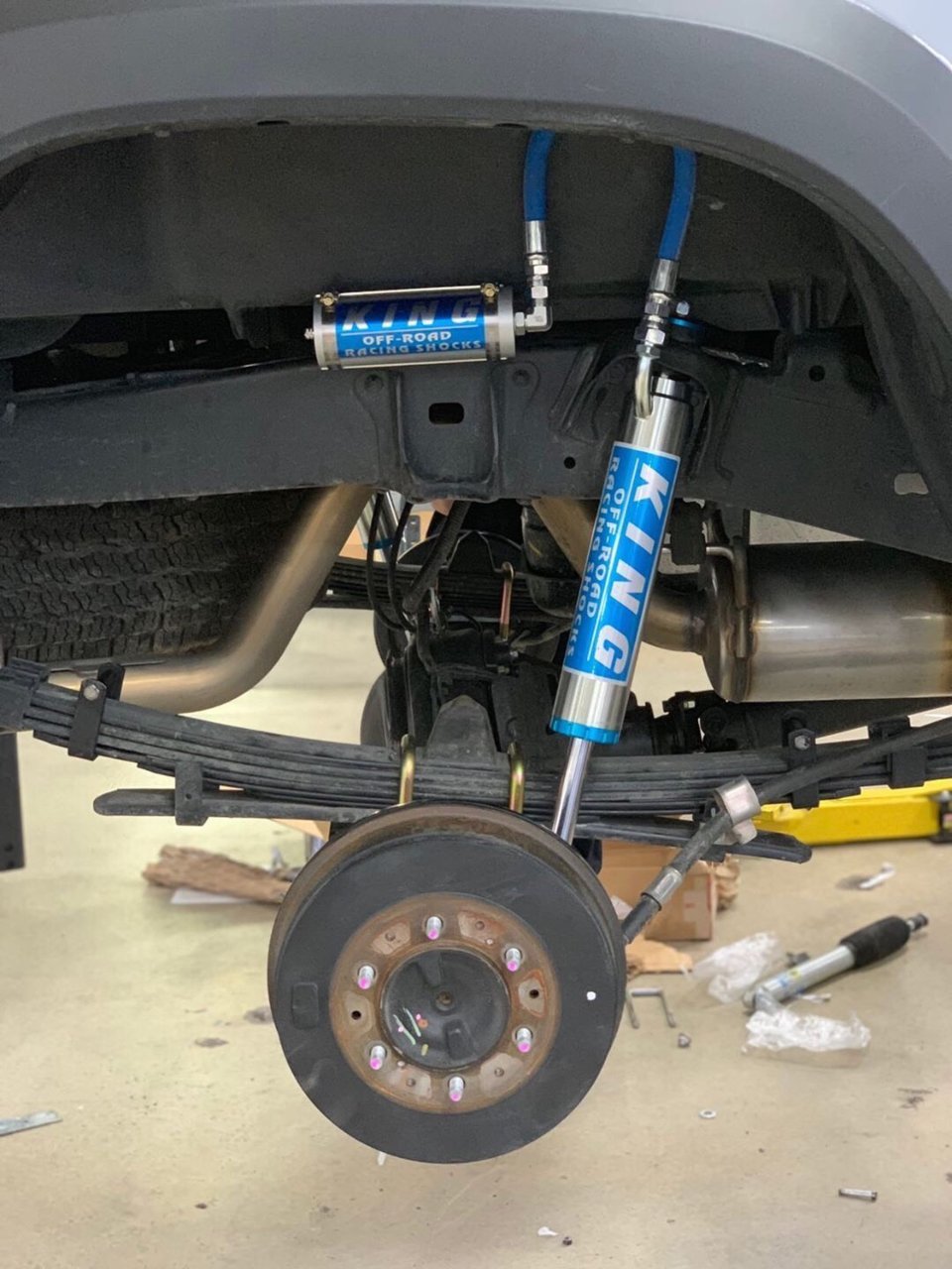

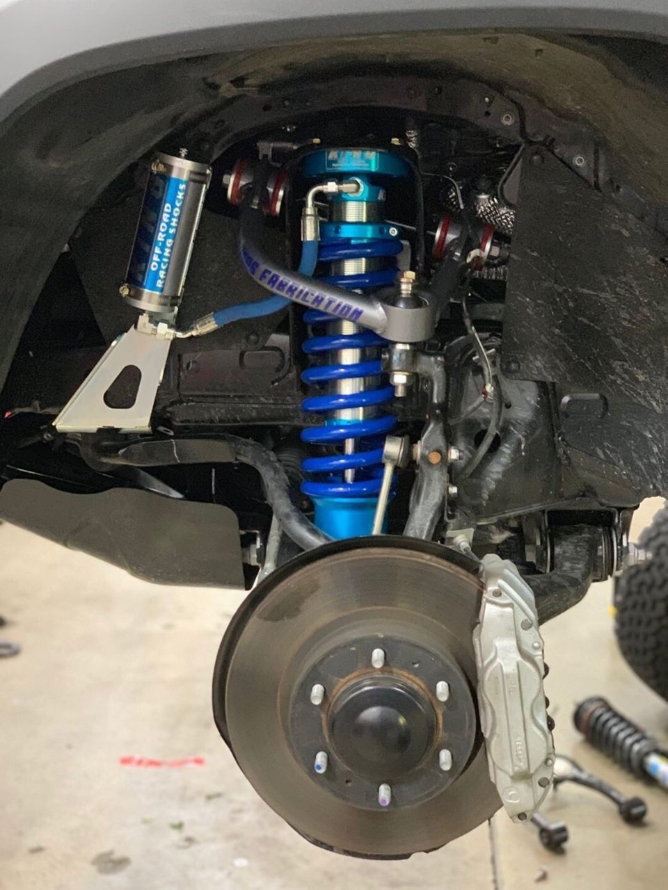

    Got my Kings 2.5 Resi w/ TC UCAs, Dakar Rear leafs installed yesterday. Needless to say these things are amazing and seeing them in person they are so meaty. Will need to test offroad ASAP thank god its labor day weekend coming up
    IMG_7289.jpg 69BA0B06-C6A0-48CF-977F-958485106F9D.jpg 917725D7-D6C1-491A-8029-F5EEC96C3676.jpg
