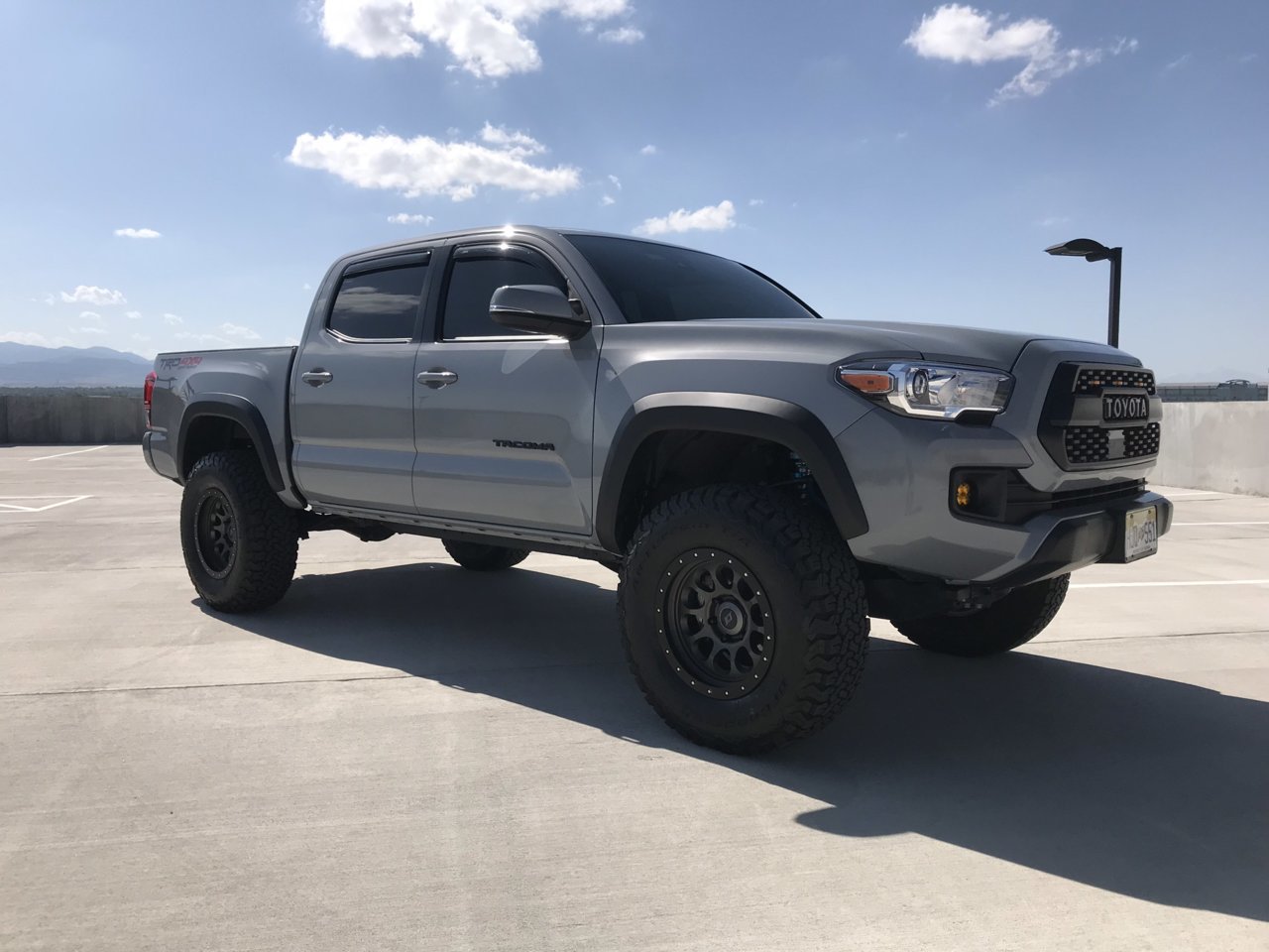

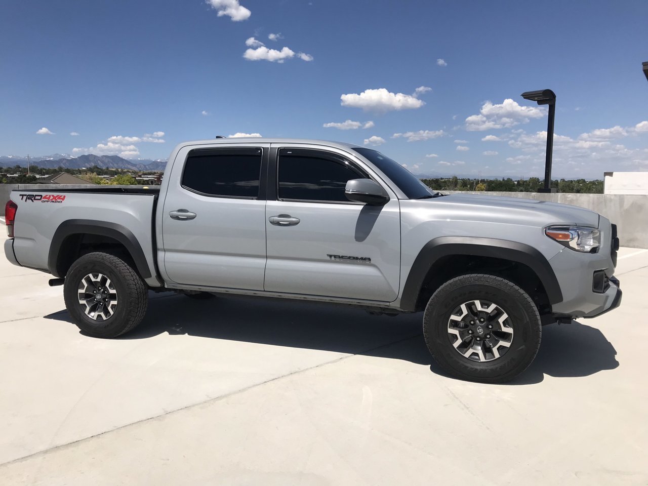

    Sometimes I forget the truck is lifted... then a stock truck parks next to me 20190911_162140.jpg

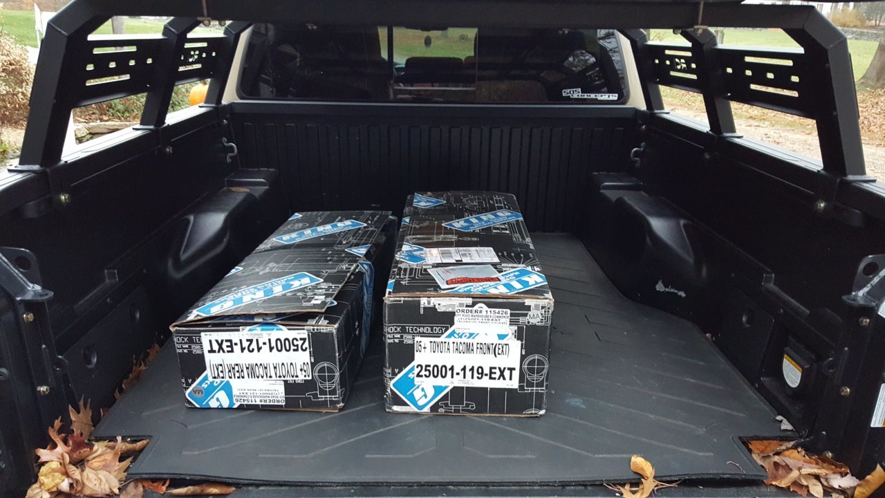

    A man in a brown truck and brown suit showed up to my work today and gave me these two boxes.. Apparently they're pretty sweet from what I hear..20191029_174522.jpg
