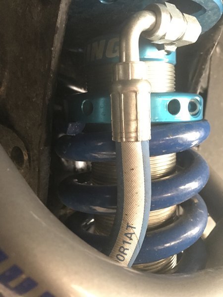

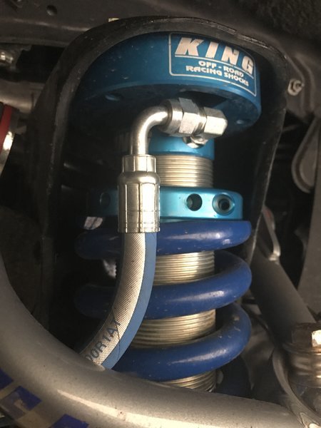

    Just installed Kings. Front feels amazing – nice improvement. The rear feels a little harsh, I think it is the leaf springs and not the shocks. It feels like the spring rate is too stiff. I know it is a truck, but I would like to hear if anyone has replaced the stock leafs for a smoother ride?
    Can anyone recommend a tool to adjust the preload? The punch tool King supplies only works until the hose or frame bracket gets in the way. I really do not want to

    It is not an issue with the force to turn the punch, it is the punch clearance. Once the set screw is facing outward, there is no hole for the punch to keep cranking on the spring collar; the hose and frame bracket gets in the way.

    I was able to wedge against the coilover bucket and turn with the punch just barely in the hole once it got to that tricky position...worked on both sides.

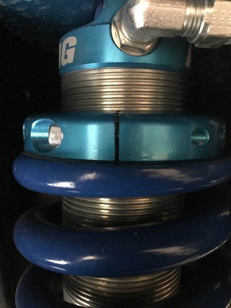

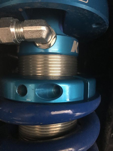

    So is it just me or does it look like it might be cross threaded? If so this may be why the driver side was so hard for me to turn. It's actually turning now. I sprayed it with some WD-40, and I'm using a hammer to hit the punch tool to slowly turn it. o_O

    Man I'm freaking out now. I called D S M to see if they could've came cross threaded and he said no, and that maybe if they were trying to be adjusted while on the vehicle. After getting very little rotation, im trying to button it up, and the driver side won't even close all the way. Here is the driver side vs the passenger side.

    Ivan I would be very shocked if they were cross threaded. Those threads are pretty thick and deep, I think if they were cross threaded they wouldnt be able to move almost at all. I have the T-handle and I keep it in my truck for quick adjustments as the torque on it really kicks ass. I know its 50 though so I dont always advise it since not many want to spend that sort of coin on one. Also just looking at your bottom picture of the two, is it just me or does the collar look much tighter when your other photo is farther away on top and has a bigger gap than the close up one? Might be worth it to see if you can slightly pry open the collar more if that is the most that it can go? It might take brute force, but I think you are fine man. That collar def looks tight though.

    you aren't supposed to necessarily put grease between the bushings and washers. You loosen the UCA bolt so that the bushings don't bulge when you put them under pressure from the grease gun. Loosening the bolt gives the grease somewhere to escape. And yes dry Teflon lube for the uniball only. Superlube for the bushings.
    To me something looks wrong with your clamping set collar. That seems like a lot of clamp throw if its in its natural position. To me it looks like its being forced apart. Maybe you could check your passenger side and see how far the split is when the clamp is loosened. I think I'd send that picture to King or DSM.

    Well the last 2 pics I sent, the collar that is open more is the driver side collar tightened. The second picture is the passenger side collar tightened which looks normal.
    I think it's cross threaded honestly, and I think that's also why that driver side collar won't close as much and has that gap.
    Tonight is my last night of my set, so tomorrow I'm going to pull it off the truck and try to fix the collar on the thread. Im going to try and seat it correctly. But if i can't do anything, I'm going to contact dsm. They swapped my coils from 600 to 650 lbs. so I'm thinking maybe it happened on them. Because I didn't touch them until now.
