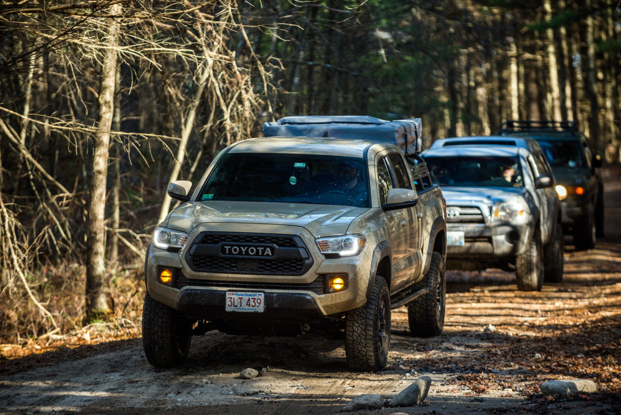

    265/75/16 Wildpeaks with Spidertrax 1.25" spacers. 600# springs and around 9/10 threads of pre-load. Rides great. Firm but not jarring. Flat in the turns, but just feels more planted. Even loaded I am still a little higher in the rear which is good.. This picture was taken right after install. It has settled a little bit. Off road it is soooo much better than stock (obviously!) Here's another after the suspension settled and some wheeling. Edit: rear springs are Icon RXT leaf pack in the 2nd configuration. 100% happy with these. Little bit of noise after this trip, but there was a lot of water, mud, etc. Sprayed them down and a little bit of fluid film and they're quiet again. If I did it again, I would probably buy from AccuTune. I got a killer deal on these (new) and couldn't pass it up. I will have AccuTune re-build them when the time comes.
