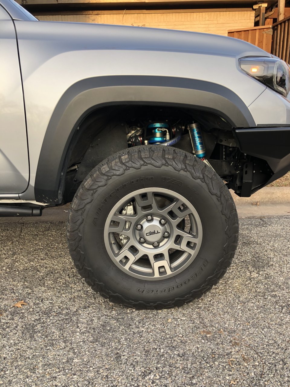

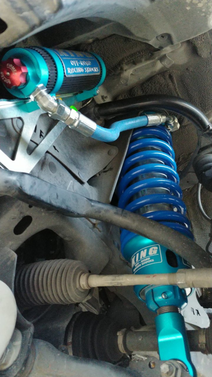

    265/75/16 Wildpeaks with Spidertrax 1.25" spacers. 600# springs and around 9/10 threads of pre-load. Rides great. Firm but not jarring. Flat in the turns, but just feels more planted. Even loaded I am still a little higher in the rear which is good.. This picture was taken right after install. It has settled a little bit. Off road it is soooo much better than stock (obviously!) Here's another after the suspension settled and some wheeling. Edit: rear springs are Icon RXT leaf pack in the 2nd configuration. 100% happy with these. Little bit of noise after this trip, but there was a lot of water, mud, etc. Sprayed them down and a little bit of fluid film and they're quiet again. If I did it again, I would probably buy from AccuTune. I got a killer deal on these (new) and couldn't pass it up. I will have AccuTune re-build them when the time comes.

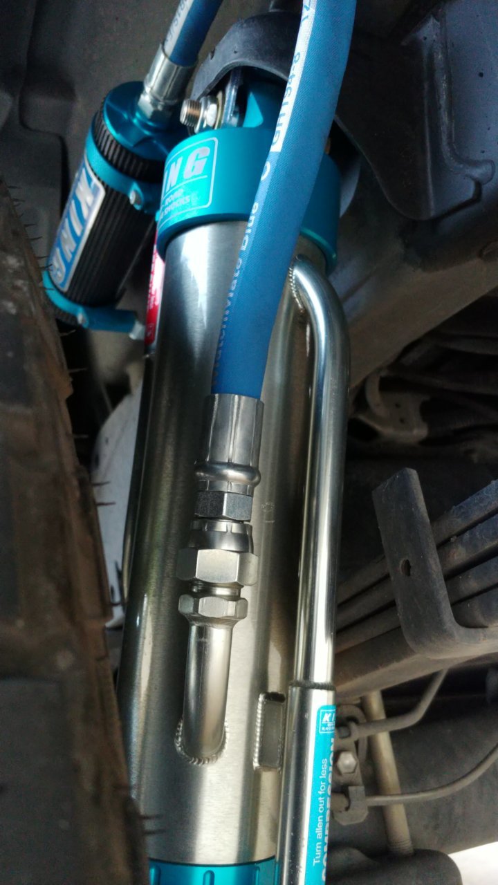

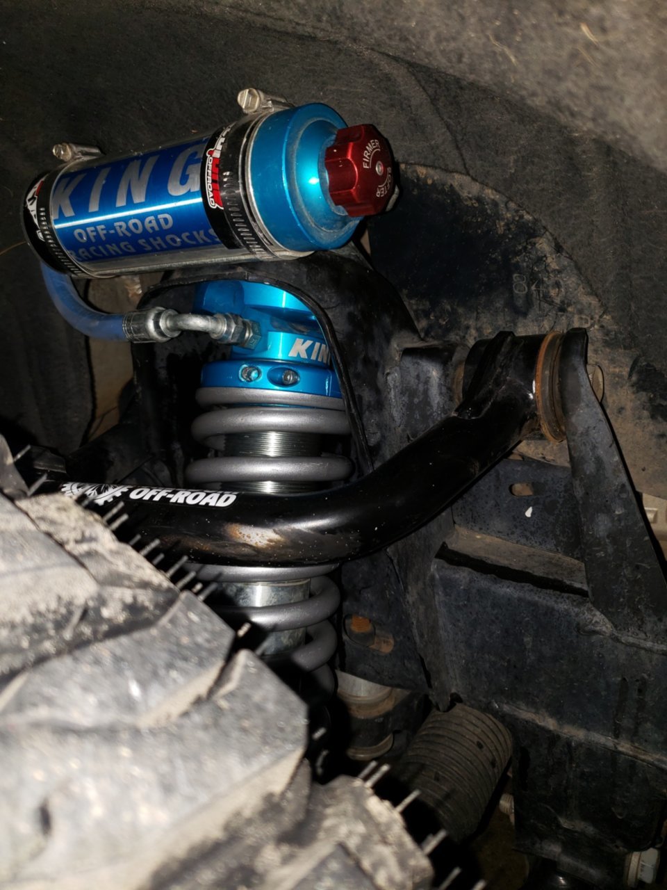

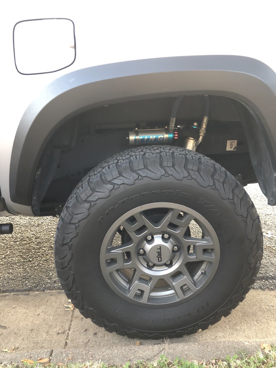

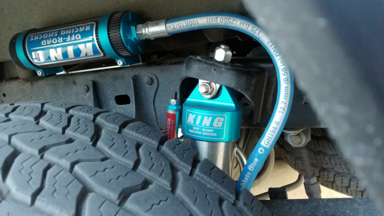

    much much more entertaining than either of those two, believe me! had to snap pics before losing the blue glow. I've become King's biggest fan.
