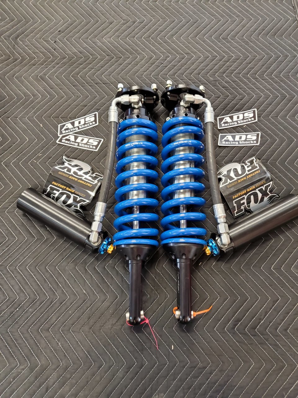

    King doesn't but you can add a FOX DSC resi to them easily.
    ADS 2.5's
    King Tacoma LT 2.5's
  5. Feb 25, 2020 at 11:16 AM

  6. Feb 25, 2020 at 11:22 AM
    #2726
    AccuTune Offroad
    AccuTune Offroad Well-Known Member Vendor
    Jan 28, 2019
    #281012
    1,656
    El Cajon, CA
    Can be done yes, but very costly.
    whatstcp likes this.
  7. Feb 25, 2020 at 11:40 AM
    #2727
    NormanPerez
    NormanPerez Well-Known Member
    Jan 31, 2018
    #243044
    264
    Norman
    Rolling Hills Estates
    2018 TRD Off-Road
    stock a fawk!
    True. I barely got my kings back from getting rebuilt for the second time. I don’t trust them to hold oil and nitrogen. Much less add a fox reservoir to them. But it’s interesting to know it’s a thing

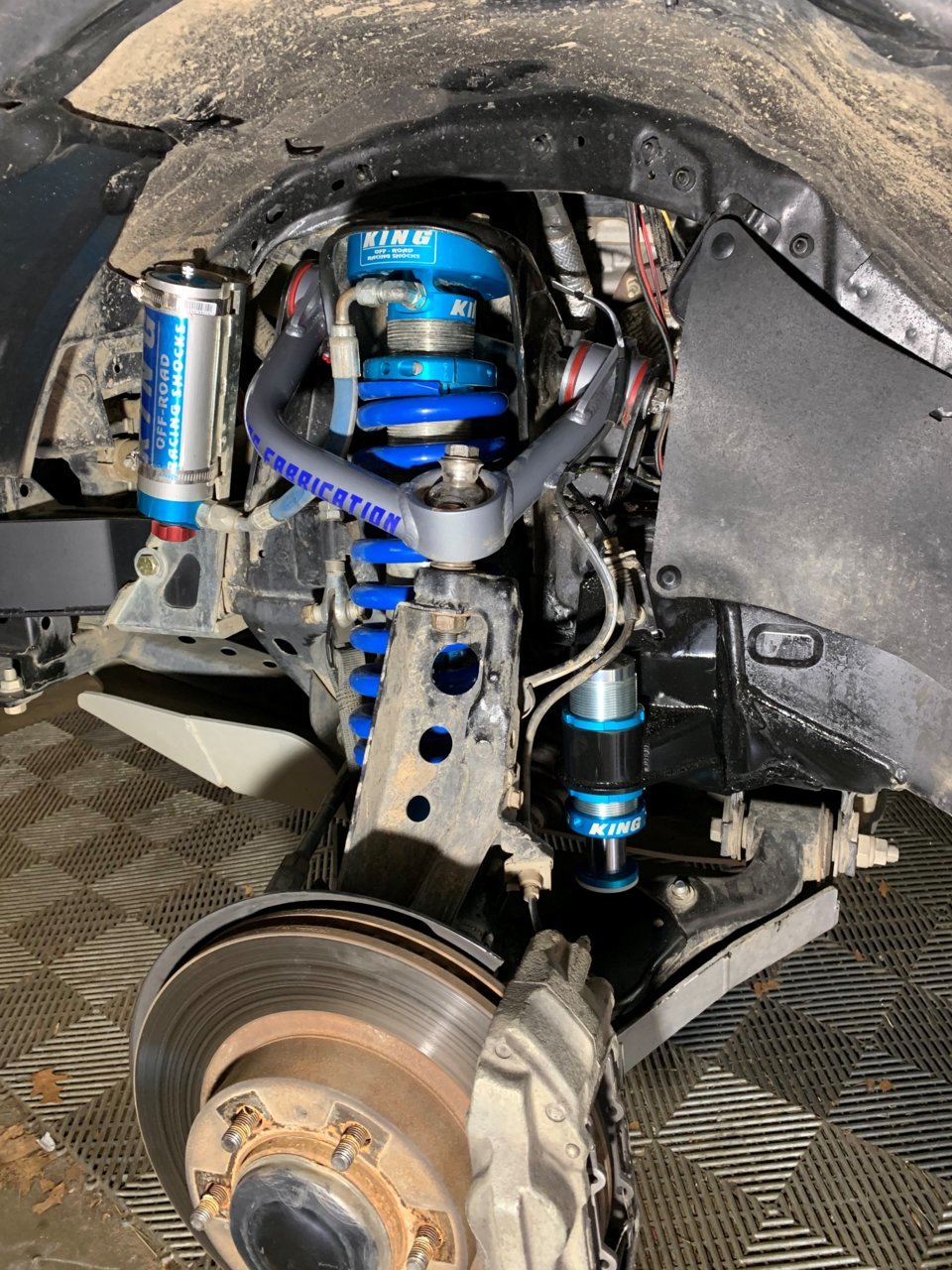

  15. Mar 26, 2020 at 12:26 PM
    #2735
    StellaHolland
    StellaHolland New Holland Overland (Holland, MI)
    Jan 15, 2018
    #241322
    98
    Jeremy
    Holland, MI
    2017 Tacoma TRD OFF-ROAD
    King 2.5 custom valved Milestar A/T Pro 285/70/17 on Method 702's New Holland Overland custom front bumper, roof rack, sliders & skids Mix of Diode Dynamics & Baja Lights 5.29's w/ KDMAX tune Skinny Guy Camper Bare Bones w/ Alu-Cab 180 Awning Freedom Retrofit custom headlights ... & So. Much. More
    Can do some fun stuff with just a nice mid-travel setup! Been running this setup for about a year now and love it. Time to work on the rear soon and get the OEM kings swapped out for 14" smoothbodies.
    King 2.5 EXT w/ adjst
    King 2.0 Bumps
    TC: UCA's, spindle gussets, coil bucket gussets, alignments tabs
    Kartek Limit Straps
    airmax233, crackils, dc2’s and 11 others like this.
  16. Mar 26, 2020 at 12:39 PM
    #2736
    su.b.rat
    su.b.rat broken truck
    Jul 30, 2016
    #193316
    9,869
    stock LCAs with skids? any reinforcement down there?

  19. Mar 27, 2020 at 5:28 AM
    #2739
    StellaHolland
    Jan 15, 2018
    #241322
    98
    Jeremy
    Holland, MI
    Stock LCA's still, will hopefully be adding in some TC lowers at the end of this year. The alignment tabs are reinforced (no alignment issues currently jumping)
    4x4_Taco and su.b.rat[QUOTED] like this.
