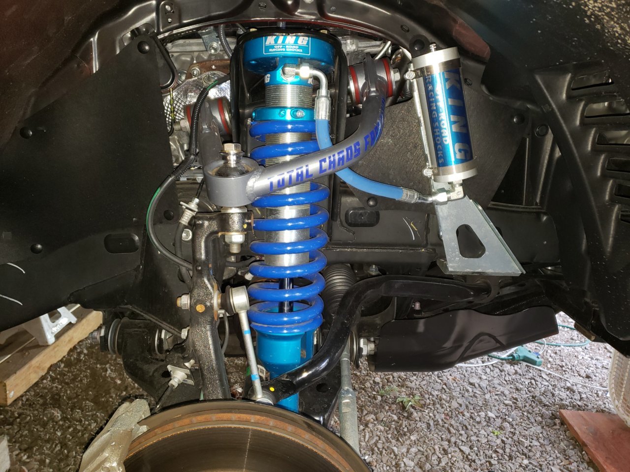

    Hey everyone! I noticed the 25001-119 coilovers do not have the lower shock mounting point in blue on the summit racing website. I am not overly concerned about them not being blue in that spot, but I am curious if that means these are not the same as the same 2.5 king coilovers that could be bought through another distributor with the same king part number. The very first post on this thread looks like the ones on summit racing, but all the pictures I have seen so far on this thread have the lower section of the shock entirely blue. Thoughts?

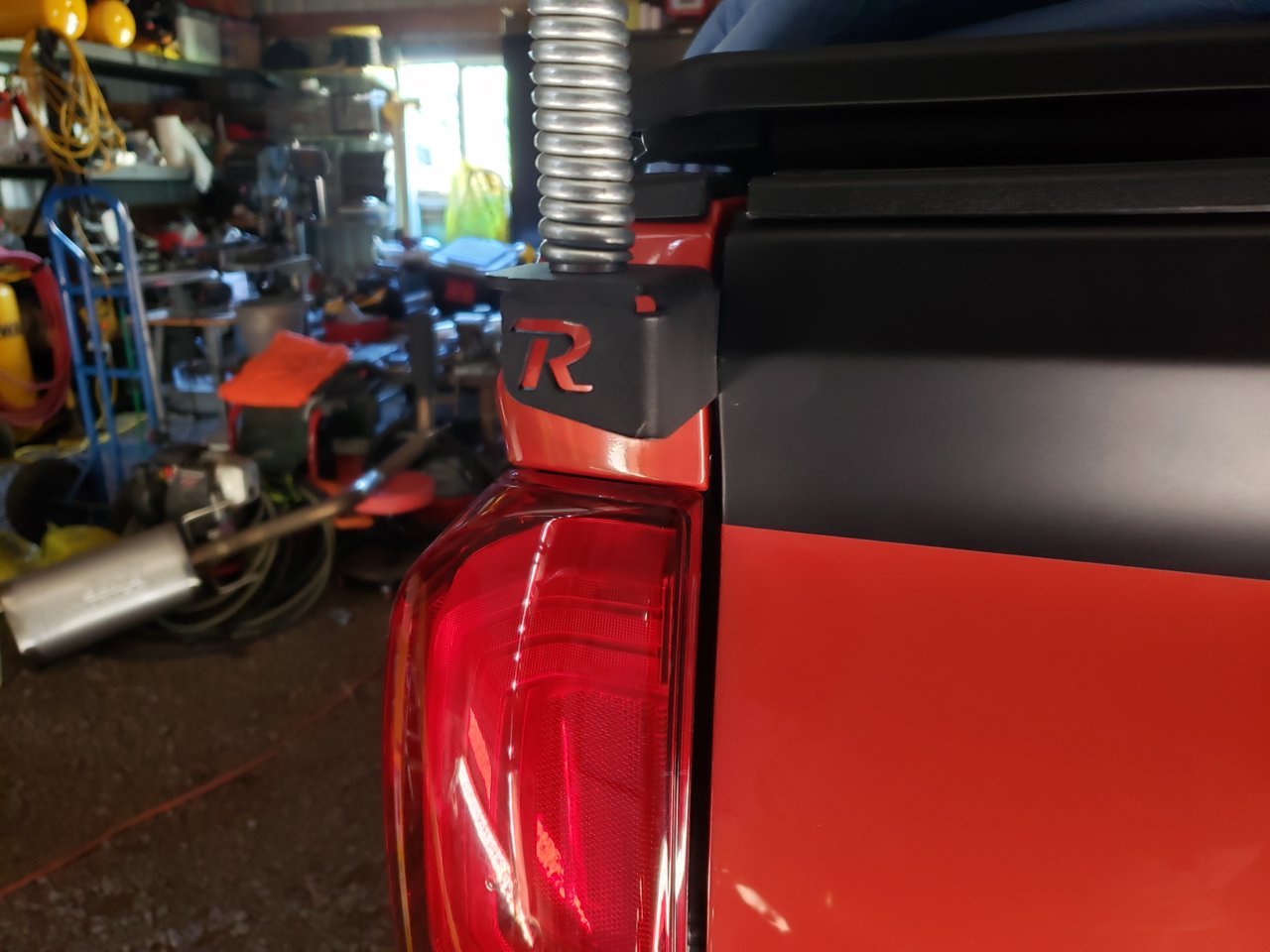

    Where did you get your flag bracket and flag pole from?

    Pictures are probably generic. Have you looked/contacted some TW vendors for pricing instead of summit?

    Wrong photo, descriptions are off too. This is what they look like:

    The bracket is made by Rago and the flag pole is a Fire Stick 20200307_123426.jpg 20200409_095641.jpg
