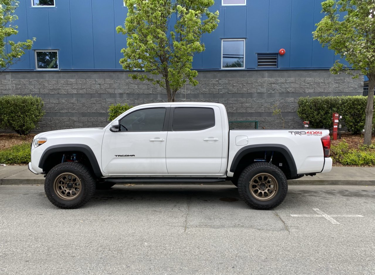

    After a few days, they’ve settled to right around a 2.5” lift. Loving the ride so far.

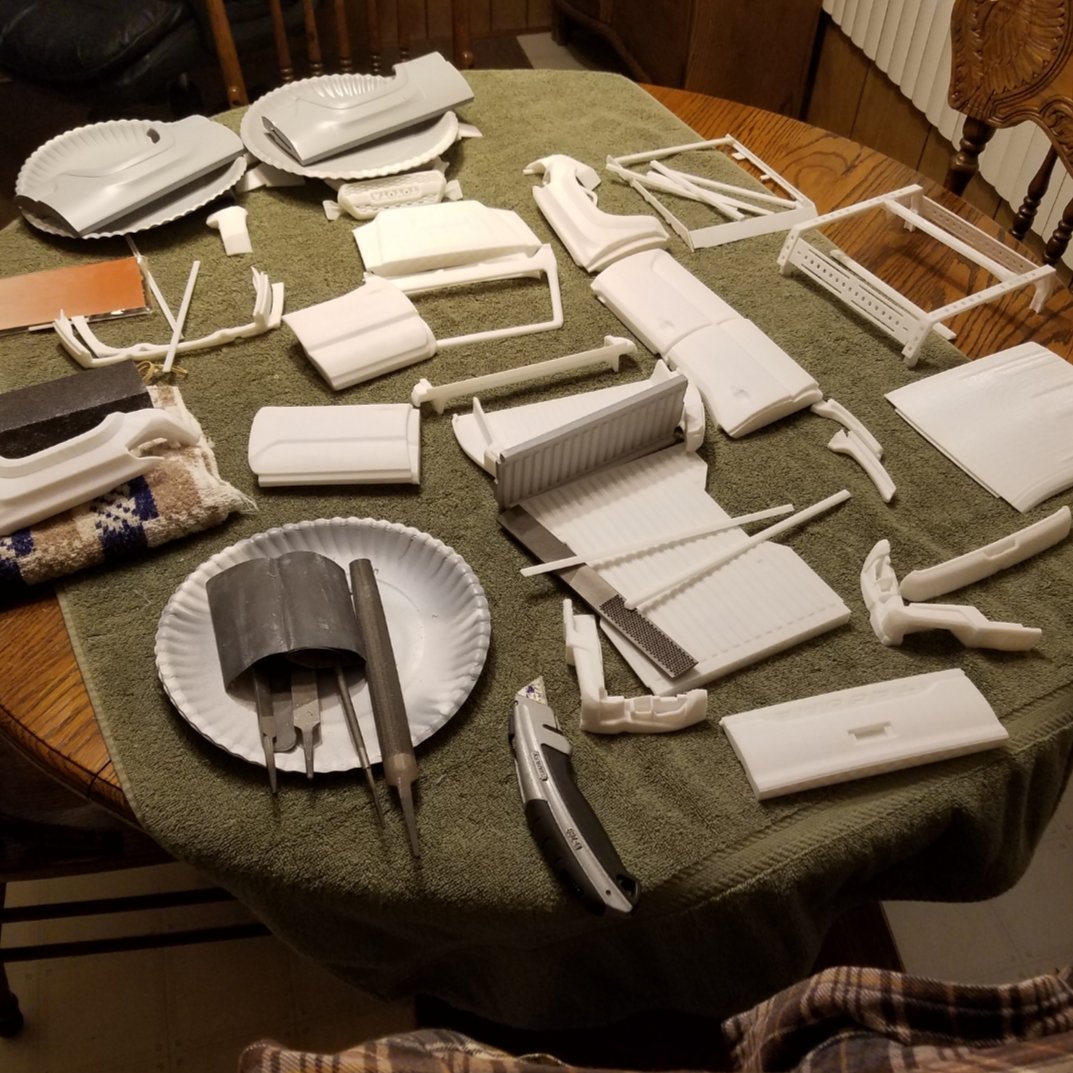

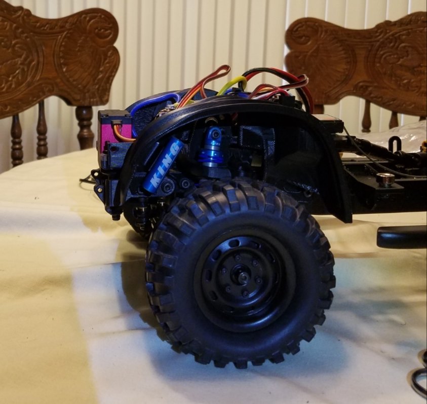

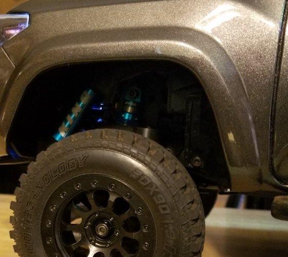

    They make Kings for my 3rd gen but not with remote reservoirs so I made my own. :rofl:

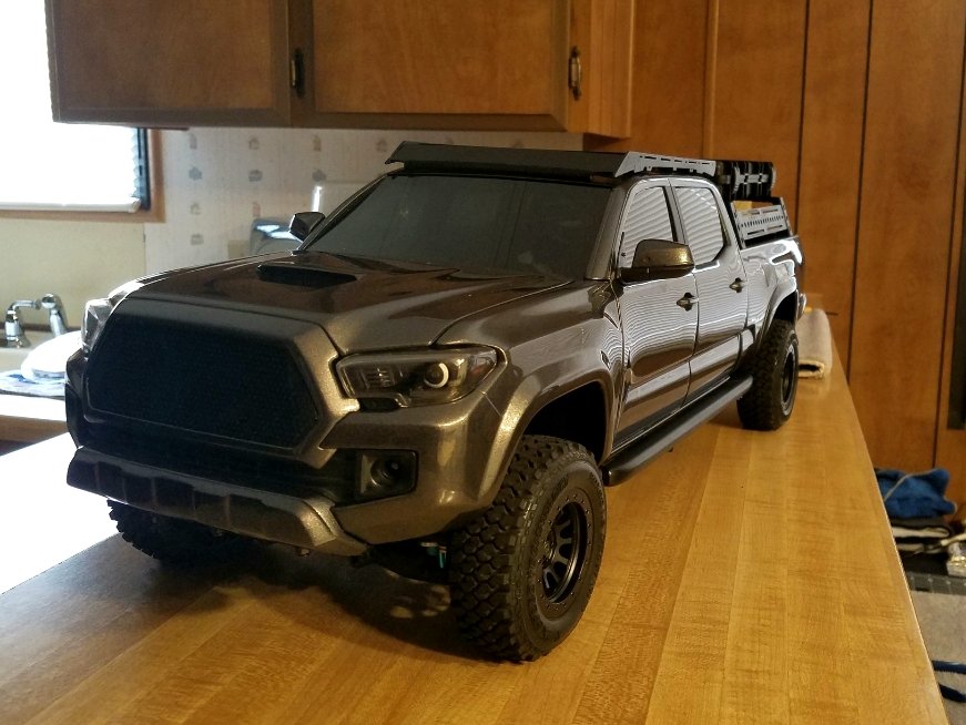

    I'm just giving you a hard time but thanks. Maybe these will help explain?
    Gotta look hard on this one on the ground and hood.

    Nice! Hopefully it’s a RC truck.

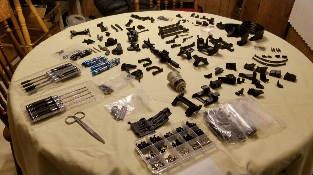

    It is. It all started like this. :eek:
